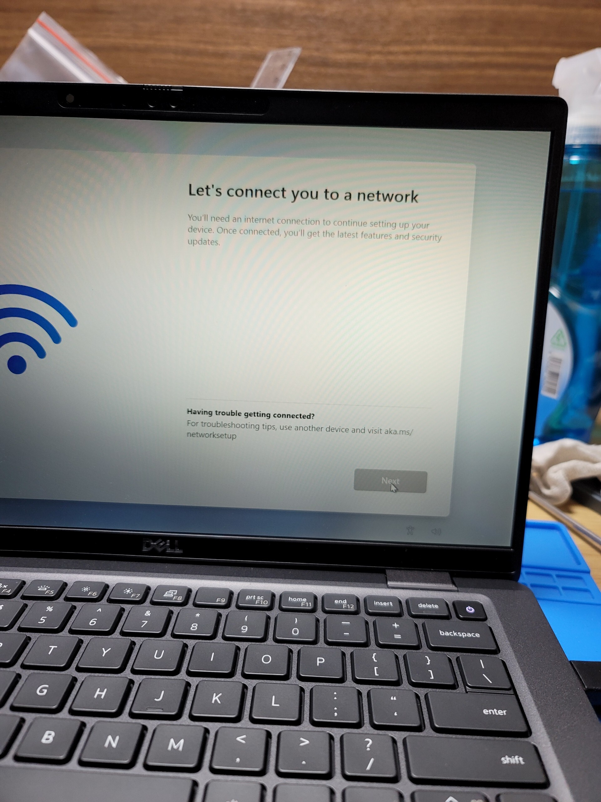

    Originally posted by vuquanghoanh
    Thank you for unlocking this bios dump.
    I have loaded the bios chip but there are some problems.
    1. CPU fan is always spinning.
    2. The device does not receive wifi
    3. The keyboard makes a "Beeep" sound when I press any key.
    Please help me one more time. Thank you​
    Hello, watch this short video and follow what Vesko356 wrote to you then it should work, good luck with it.
    https://www.youtube.com/watch?v=3AJxkT1cLdQ
    • vuquanghoanh
      • Feb 2023
      • 45
      • US
      #62
      You are correct. I haven't exited Manufacture mode yet. Thank you very much.

        #63
        Thank you.
        After following your instructions, my laptop is almost normal. Now there is a wifi problem, I tried installing the wifi driver but it didn't work. Have you encountered this error before?
        Best,​
        • vuquanghoanh
          • Feb 2023
          • 45
          • US
          #64
          I went to the Dell support homepage and downloaded the driver, the laptop worked normally.​
