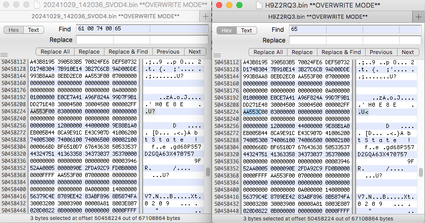

    Originally posted by johansel
    good day Could you help me remove the absolute from this team? S/N: H9Z2RQ3
    how many do you have? compare original against modified file and you'll figure out how to do it yourself...
    • johansel
      • Feb 2022
      • 39
      • colombia
      #62
      I apologize if I have already requested help many times to remove the absolute, I have tried to compare all the files to see a pattern with which to guide me and provide a solution on my own, however I have not been able to find said pattern
      since all the files have a change made in different lines of the code​
      • volinakis
        • Jan 2021
        • 2873
        • N/A
        #63

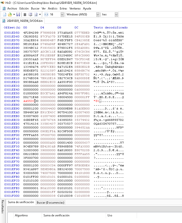

        no need to apologize, my question wasn't badly intended. So, you have to invalidate AbtState from VSS2 store for that open bios file with an hex editor and search for hex "410062007400530074006100740065" and change AA553F from above to AA553C. After that enter in bios setup and permanently disable Absolute.
Name:	Screen Shot 2024-10-30 at 02.11.04.png

          #64
          Thank you very much for the information, now I have an idea what to do.
          I really appreciate you taking the time to explain to me.​

            #65
            I just did the test with the instructions you gave me and it is indeed exactly as you indicated, now I can do it on my own without problems
            I really appreciate you guiding me​

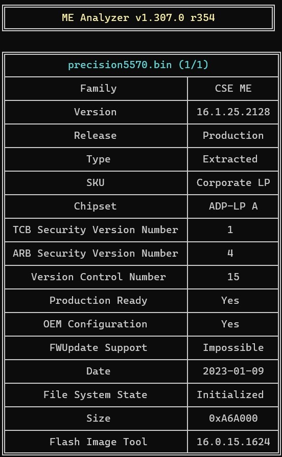

                #67
                Good Day,
                Need your support, and advise for the solution related with my laptop
                Precision 5570 got condition : booting logo, and 2/3 second restart itself.
                Service Tag ; 6WX0DK3
                and I have question, is there any guide how to synchronize ME Cleaning if sample my case
                ME ; 16.1.25. 2128
                FIT ; 16.0.15.1624
                I used both side either FIT 16.1 series or 16.0 series got problem CSE error and cant continue.
                Appreciate for your support

                          #72
                          Originally posted by bondminer009
                          still the same, now only dell logo 1 second and restart
                          I downgrade the bios version and ME cleaning, unit working back
                          Attached for the file, tested working well
