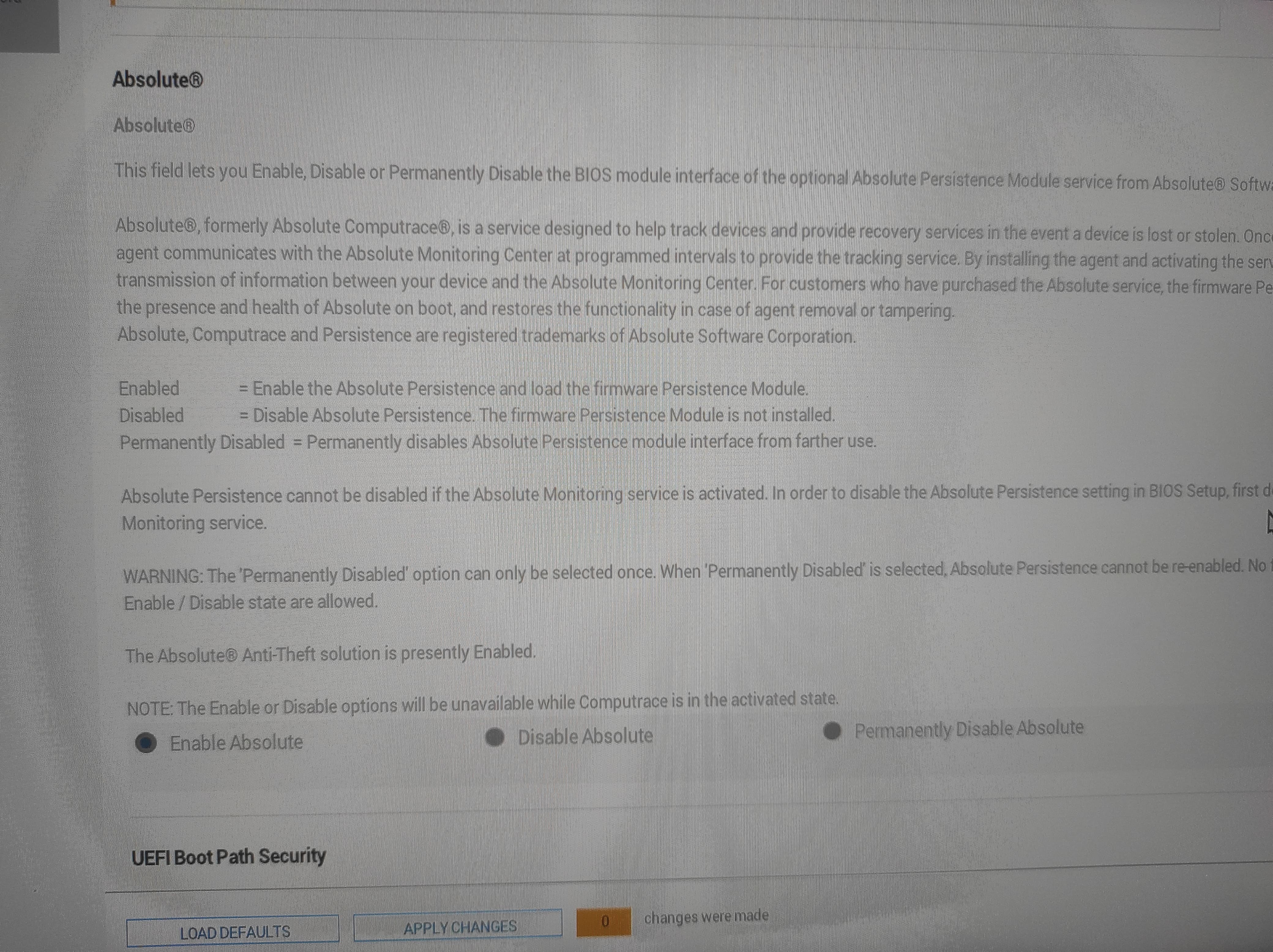

    try. After write new bios at 1st boot enter bios setup Security-Absolute and disable it or permanently disable it.
    Good morning, test the new file, however the block is still present in the absolute
    What do you think can happen?
    It should be said that this equipment has several bios chips
    Do you think it is possible that additional information is housed in the other chips?

      reset bios to factory defaults, you wrote bios with CMOS battery connected
        thank you so much
        In resetting the factory bios it opened the option to deactivate the absolute
        I understood something new today and I thank you very much for that and the help you provided.

          you are welcome, next time remember to disconnect CMOS battery

                            try. After write new bios enter bios setup and set Absolute to permanently disable.​
