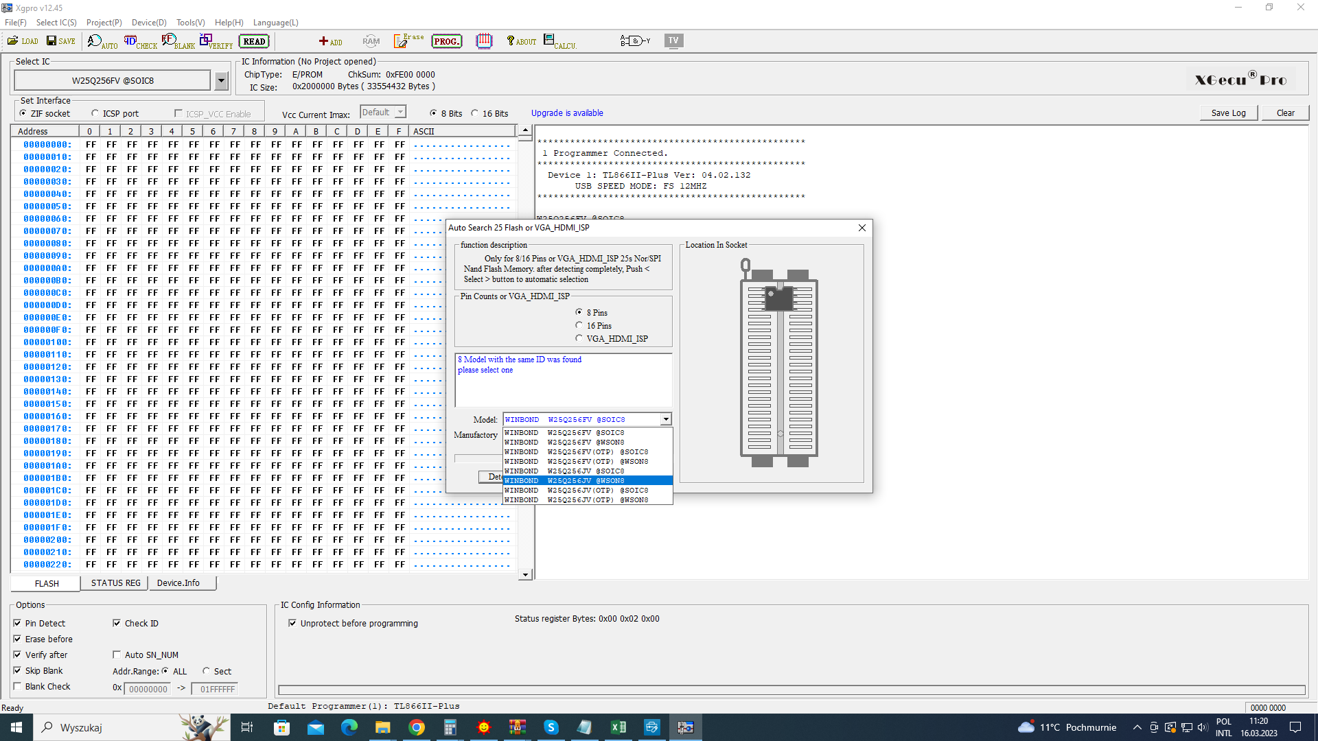

                                      • hardware1
                                        • Sep 2021
                                        • 2948
                                        • N/A
                                        #39
                                        Re: Dell Latitude 5430, LA-L591P Computrace setting unlock
                                        Originally posted by biniu1978
                                        de-soldering chip. try reading a few times and same result
                                        programmer is TL866 II Plus
                                        Attach a clear image for your Chip or what is written on it. Did you choose the same name of the Chip when you try to read it or auto detect?

                                          #40
                                          my chip is - 25Q256JVEN
                                          and my programmer have only that option - reading all same.
                                          see picture
