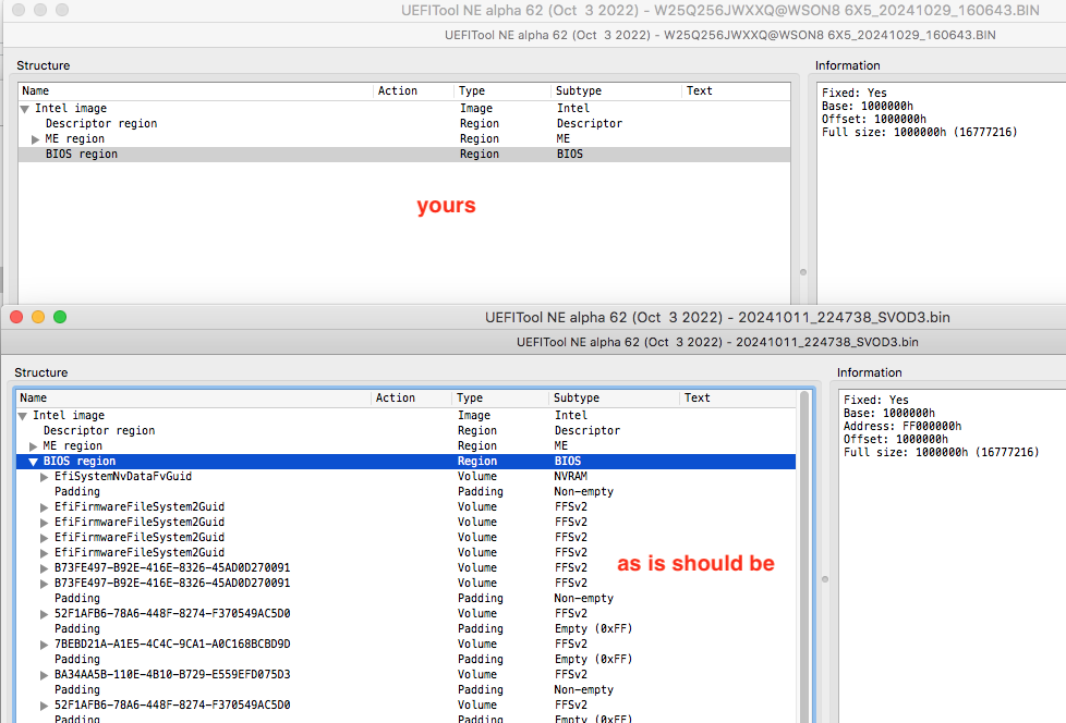

Microsoft Surface laptop 4 UEFI password
  • volinakis
    replied
    Originally posted by Marcos Yanez
    I tried again
    compare readings, when you have 2 identical it means you have a good backup. The size is due to chipset, if programmer detected as being 256Mb will always generate a 33.554.432 bytes file. If you use HxD see tab "Analyse" and you have there "Compare"
    Leave a comment:
  • Marcos Yanez
    replied
    Originally posted by Marcos Yanez
    Thank you! I'm using a WSON8 chip probe pin adaptor. I did 3 readings and the file come always with the same size.
    Can be the issue with the adaptor?
    I tried again
    Leave a comment:
  • Marcos Yanez
    replied
    read again bios chipset, Bios Region has no volumes...
Name:	Screen Shot 2024-10-29 at 23.34.12.png
Views:	267
Size:	131.8 KB
ID:	3495528
    Thank you! I'm using a WSON8 chip probe pin adaptor. I did 3 readings and the file come always with the same size.
    Can be the issue with the adaptor?
    Leave a comment:
  • volinakis
    replied
    Originally posted by Marcos Yanez
    First of all, I'm new to this, so please forgive any mistakes I may make.
    I have a Surface Laptop 4 that's blocked with DFCI.
    model Surface Laptop 4 / 1950 /
    motherboard / M1098028-008 /
    spi chip / WINBOND W25R256JWP
    SN/050321323057
    Any help will be really appreciated
    read again bios chipset, Bios Region has no volumes...
Name:	Screen Shot 2024-10-29 at 23.34.12.png
Views:	267
Size:	131.8 KB
ID:	3495528
    Leave a comment:
  • peste
    commented on 's reply
    post merged..
  • Marcos Yanez
    replied
    First of all, I'm new to this, so please forgive any mistakes I may make.
    I have a Surface Laptop 4 that's blocked with DFCI.
    model Surface Laptop 4 / 1950 /
    motherboard / M1098028-008 /
    spi chip / WINBOND W25R256JWP
    SN/050321323057
    Any help will be really appreciated
    Leave a comment:
  • abdulhashim
    replied
    Originally posted by hoaca388
    Unlocked
    Thank you!! its worked perfectly
    Leave a comment:
  • hoaca388
    replied
    Originally posted by abdulhashim
    hello
    I need one help
    this is surface laptop 4 1951 password locked
    031721714057
    ​thanks in advance
    Unlocked
    Leave a comment:
  • abdulhashim
    replied
    hello
    I need one help
    this is surface laptop 4 1951 password locked
    031721714057
    ​thanks in advance
    Leave a comment:
  • hoaca388
    replied
    Originally posted by tataie
    Please help to remove bios pass
    Model Surface Laptop 4 1951
    S/N: 018335122357
    Thank you!​
    Here
    Leave a comment:
  • tataie
    replied
    Please help to remove bios pass
    Model Surface Laptop 4 1951
    S/N: 018335122357
    Thank you!​
    Leave a comment:
  • Simon Halley
    replied
    Originally posted by hoaca388
    Try
    darn it. unfortunately, neither of those worked. computer still has the exact same behaviour. i guess a bricked Surface machine is unfixable. thanks anyway, hoaca388. i will keep investigating the issue though. would love to see this computer working some day
    Leave a comment:
  • hoaca388
    replied
    Originally posted by Simon Halley
    Could anyone be able to provide me with a working bios? Windows logo for 10 seconds. Can't get past that. Is the laptop bricked? Anyone can help?
    surface laptop 4 - 1951
    mb rev - WAYLAND MB REV:3.0
    sn - 033170714357
    Try
    Leave a comment:
  • Simon Halley
    replied
    Could anyone be able to provide me with a working bios? Windows logo for 10 seconds. Can't get past that. Is the laptop bricked? Anyone can help?
    surface laptop 4 - 1951
    mb rev - WAYLAND MB REV:3.0
    sn - 033170714357
    Leave a comment:
  • Akhlz001
    replied
    Originally posted by SMDFlea
    Thank you, I figured it out finally!
    Leave a comment:
    replied
    Originally posted by Akhlz001
    Hi, I've got another with a bios password, tried changed TPM clear variable to 3C and tried other methods, get set temp key to 3C, still password remains, what is this?! HP, Dell, Lenovo are easy one method, change few strings and done!
    Please help, attached BIOS dump.
    Model Surface Laptop 4 1951
    S/N: 007031313857
    Thank you!
    I`ll give you a clue, its in AWord on the first page of this thread
    https://www.badcaps.net/forum/troubl...20#post3177920
    https://www.badcaps.net/forum/troubl...post3178027​
    Leave a comment:
  • Akhlz001
    replied
    Hi, I've got another with a bios password, tried changed TPM clear variable to 3C and tried other methods, get set temp key to 3C, still password remains, what is this?! HP, Dell, Lenovo are easy one method, change few strings and done!
    Please help, attached BIOS dump.
    Model Surface Laptop 4 1951
    S/N: 007031313857
    Thank you!
    Last edited by Akhlz001; 09-11-2024, 01:43 PM.
    Leave a comment:
  • Akhlz001
    replied
    Originally posted by hoaca388
    Unlocked
    Thank you brother
    Leave a comment:
  • hoaca388
    replied
    Originally posted by Akhlz001
    Can someone please remove the admin password completely and allow full access to bios? I just need it once then I can hex edit for any others I get. I would be very grateful thank you.
    Unlocked
    Leave a comment:
  • Akhlz001
    replied
    Originally posted by Akhlz001
    Hi, I have tried to unlock this bios through various methods but still the password persists is this a new bios version? Can it please be unlocked.
    Surface Laptop 4 - 1951
    S/N: 007413613857
    Can someone please remove the admin password completely and allow full access to bios? I just need it once then I can hex edit for any others I get. I would be very grateful thank you.
    Leave a comment:
    09-06-2024, 08:47 AM
    Microsoft Surface Laptop Surface Laptop Go 2 Notebook Go 2 Specification for Upgrade or Repair
    This specification for the Microsoft Surface Laptop Surface Laptop Go 2 Notebook can be useful for upgrading or repairing a laptop that is not working. As a community we are working through our specifications to add valuable data like the Surface Laptop Go 2 boardview and Surface Laptop Go 2 schematic. Our users have donated over 1 million documents which are being added to the site. This page will be updated soon with additional information. Alternatively you can request additional help from our users directly on the relevant badcaps forum. Please note that we offer no warranties that any specification,...
    09-07-2024, 05:50 AM
    Microsoft Surface Laptop Surface Laptop Go 2 Notebook Go 2 Specification for Upgrade or Repair
    This specification for the Microsoft Surface Laptop Surface Laptop Go 2 Notebook can be useful for upgrading or repairing a laptop that is not working. As a community we are working through our specifications to add valuable data like the Surface Laptop Go 2 boardview and Surface Laptop Go 2 schematic. Our users have donated over 1 million documents which are being added to the site. This page will be updated soon with additional information. Alternatively you can request additional help from our users directly on the relevant badcaps forum. Please note that we offer no warranties that any specification,...
    09-07-2024, 05:50 AM
    Microsoft Surface Laptop Surface Laptop Go 2 Notebook Go 2 Specification for Upgrade or Repair
    This specification for the Microsoft Surface Laptop Surface Laptop Go 2 Notebook can be useful for upgrading or repairing a laptop that is not working. As a community we are working through our specifications to add valuable data like the Surface Laptop Go 2 boardview and Surface Laptop Go 2 schematic. Our users have donated over 1 million documents which are being added to the site. This page will be updated soon with additional information. Alternatively you can request additional help from our users directly on the relevant badcaps forum. Please note that we offer no warranties that any specification,...
    09-07-2024, 05:50 AM
    Microsoft Surface Laptop Surface Laptop Go 2 Notebook Go 2 Specification for Upgrade or Repair
    This specification for the Microsoft Surface Laptop Surface Laptop Go 2 Notebook can be useful for upgrading or repairing a laptop that is not working. As a community we are working through our specifications to add valuable data like the Surface Laptop Go 2 boardview and Surface Laptop Go 2 schematic. Our users have donated over 1 million documents which are being added to the site. This page will be updated soon with additional information. Alternatively you can request additional help from our users directly on the relevant badcaps forum. Please note that we offer no warranties that any specification,...
    09-07-2024, 05:50 AM
