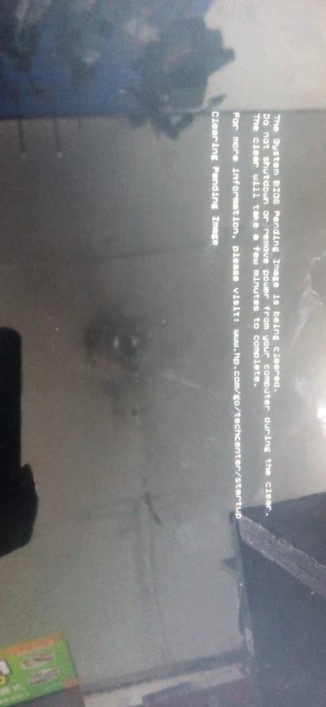

    hp 14-fq0020nr blackscreen
    i have an hp laptop 14 inches in size
    but its nolonger displaying, the screen only gets dark after i power on
    no caps signals no nothing.
    some one help please
    thnaks
    model : fq0020nr
    product id: 1f6e6ua#aba
    sn:5cd049d3dh

    Re: hp 14-fq0020nr blackscreen
    Bios from HP support -> https://ftp.hp.com/pub/softpaq/sp141...0/sp141506.exe
    Run the exe , choose Save to location. Your bios version is BID087B7 .Copy your DMI (serial number,feature-byte ) from your backup to the new bios using a hex editor using these off-sets 0-803F

        HP Laptop - 14-fq0020nr with DMI added.
          thanks but this is what happens
          it displays this message for 2secs and it remains in a loop of on with blackscreen then off like that
            Wait a moment, here is a virgin file extracted according to your DMI info.
                  thnaks
                  model : fq0020nr
                  sn:5cd049d3dh
                  rmn: TPN-q242
                  bios extracted from the HP website update, the laptop has two bios versions, yours is 087B7
                  DMI 0 - 1FFF
                  KEYWIN 8000 - 803F
