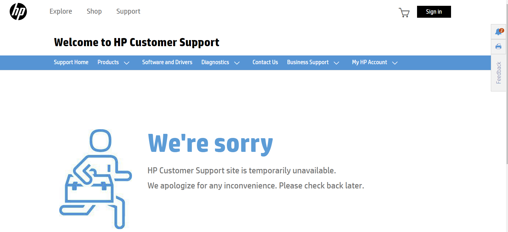

        HP's support page has a bit of a problem, I will continue tomorrow.

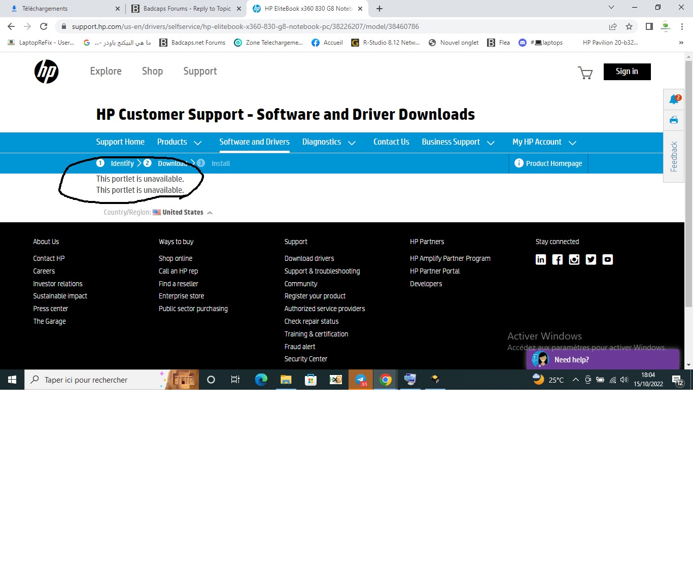

                                      Re: Hp X360 830 G8
                                      Originally posted by O.Szilárd
                                      I understand, but the writing was successful, verify ok, but maybe the chip is bad? What could be the reason? I'll try another one.
                                      I will try but i can t download your bios from hp site: This portlet is unavailable.

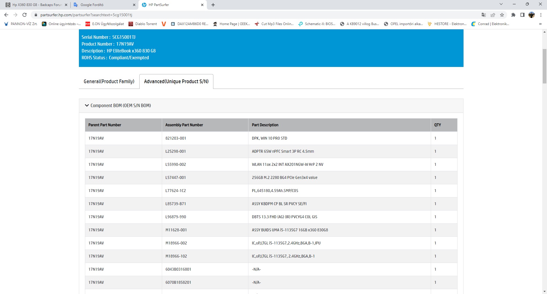

                                      • O.Szilard
                                        • May 2019
                                        • 161
                                        • hungary
                                        Re: Hp X360 830 G8
                                        serial number help?
