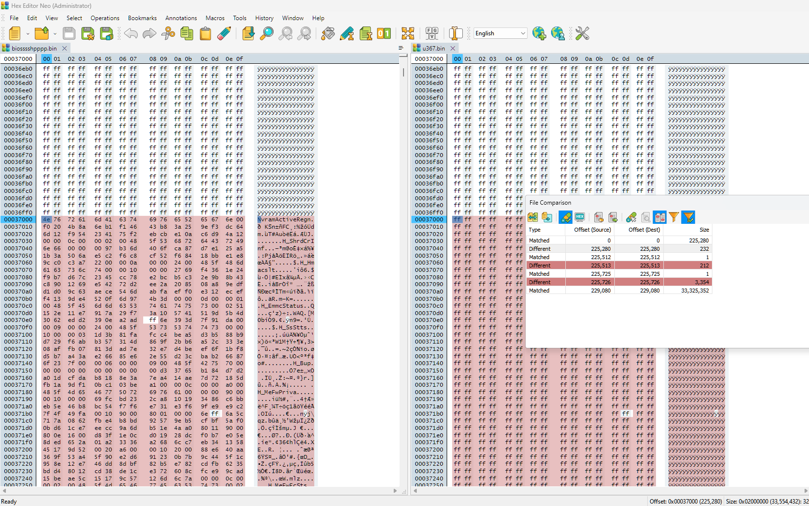

                    • coumcoum
                      • Dec 2015
                      • 36
                      • algerie
                      #71
                      Originally posted by rex98
                      serial number is always required!
                      sorry
                      SN : 5CG3282JVX
                      i try hex 37000 to 38000 but not work i upload other dump u367 thaanks

                    • rex98
                      • Feb 2023
                      • 1297
                      • Mandaue CEBU, Philippines
                      #72
                      Originally posted by coumcoum
                      sorry
                      SN : 5CG3282JVX
                      upload the main bios not this EC.

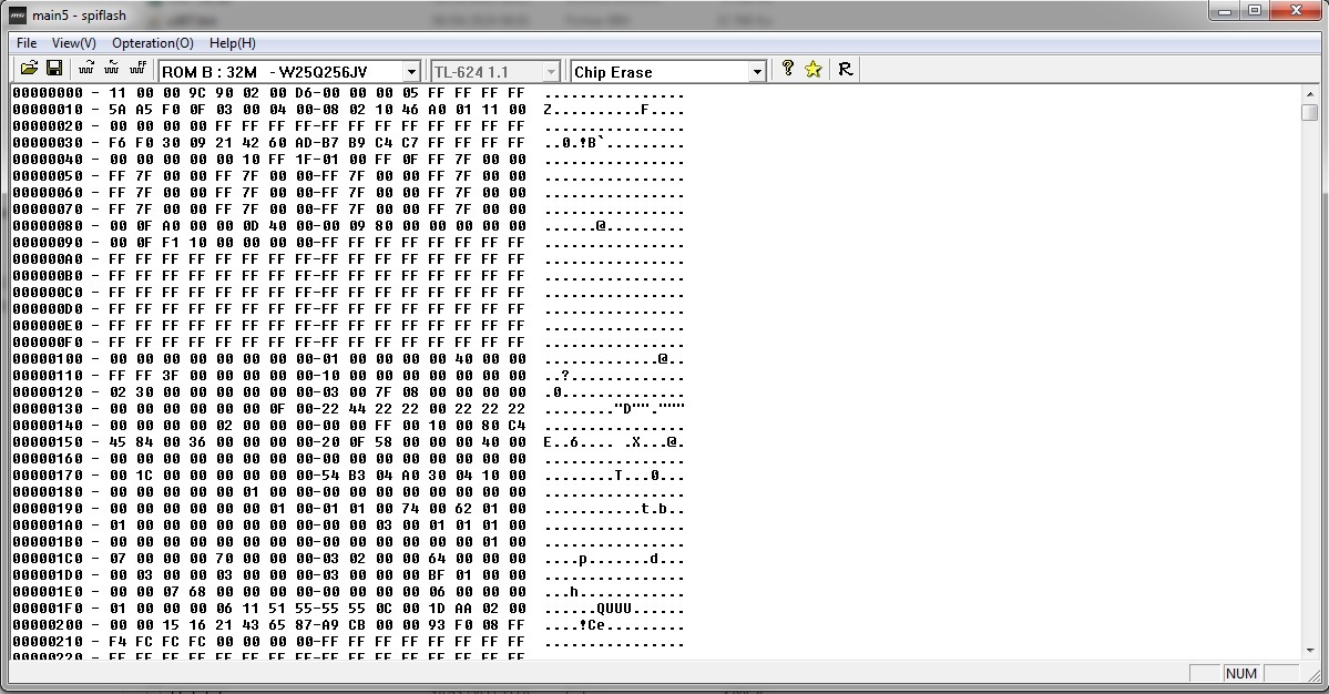

                          • coumcoum
                            • Dec 2015
                            • 36
                            • algerie
                            #75
                            im so sorry here is main bios
                            SN 5CG3282JVX
                            thanks
                            • hoaca388
                              Badcaps
                              • Jan 2022
                              • 12427
                              #76
                              SN 5CG3282JVX
                              thanks
                              File corrupted . read again.

                              • coumcoum
                                • Dec 2015
                                • 36
                                • algerie
                                #77
                                hi
                                i read it 5 times compare with hex i get always same dump
                                • rex98
                                  • Feb 2023
                                  • 1297
                                  #78
                                  hi
                                  verify after reading
                                  • coumcoum
                                    • Dec 2015
                                    • 36
                                    • algerie
                                    #79
                                    i don't have veryfing option there is my programmer
                                    you can help me with this corrupted dump pleas ?
                                    • rex98
                                      • Feb 2023
                                      • 1297
                                      #80
                                      simple throw that away and buy Cheap CH341A then use neo programmer.
