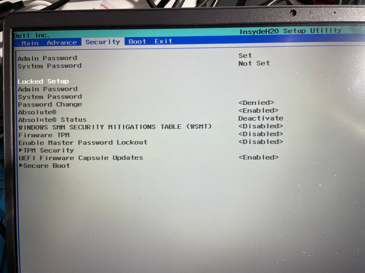

      Hello! i have admin password on my DELL Vostro 15 3515 (ryzen 5)
      MB: LA-L245P rev 1.0
      ST: 3YX5BL3
      Could you help me to fix this dump? does it needs to flash EC controller too?

        Originally posted by hoaca388
        Try
        No result...

              Originally posted by LBTT1121
              try, bios working
              No result, locked
              • rushouse77
                Futuretech Labs
                • Apr 2019
                • 25
                • Georgia
                try
                No result, password set and locked

                      #31
                      Originally posted by minhdigital
                      Send to you
                      dead bios, no init.

                        #32
                        try this one
                        locked bios, no result

                          Does anybody have KBC working firmware? KB9542QF2 model. Could i reflash it?
                          • rushouse77
                            Futuretech Labs
                            • Apr 2019
                            • 25
                            • Georgia
                            #34
                            I tried to reflash the multicontroller (ENE) and the BIOS - and in the end the password did not disappear. It turns out that this laptop has a separate chip with a password, like on Lenovo Thinkpads?
