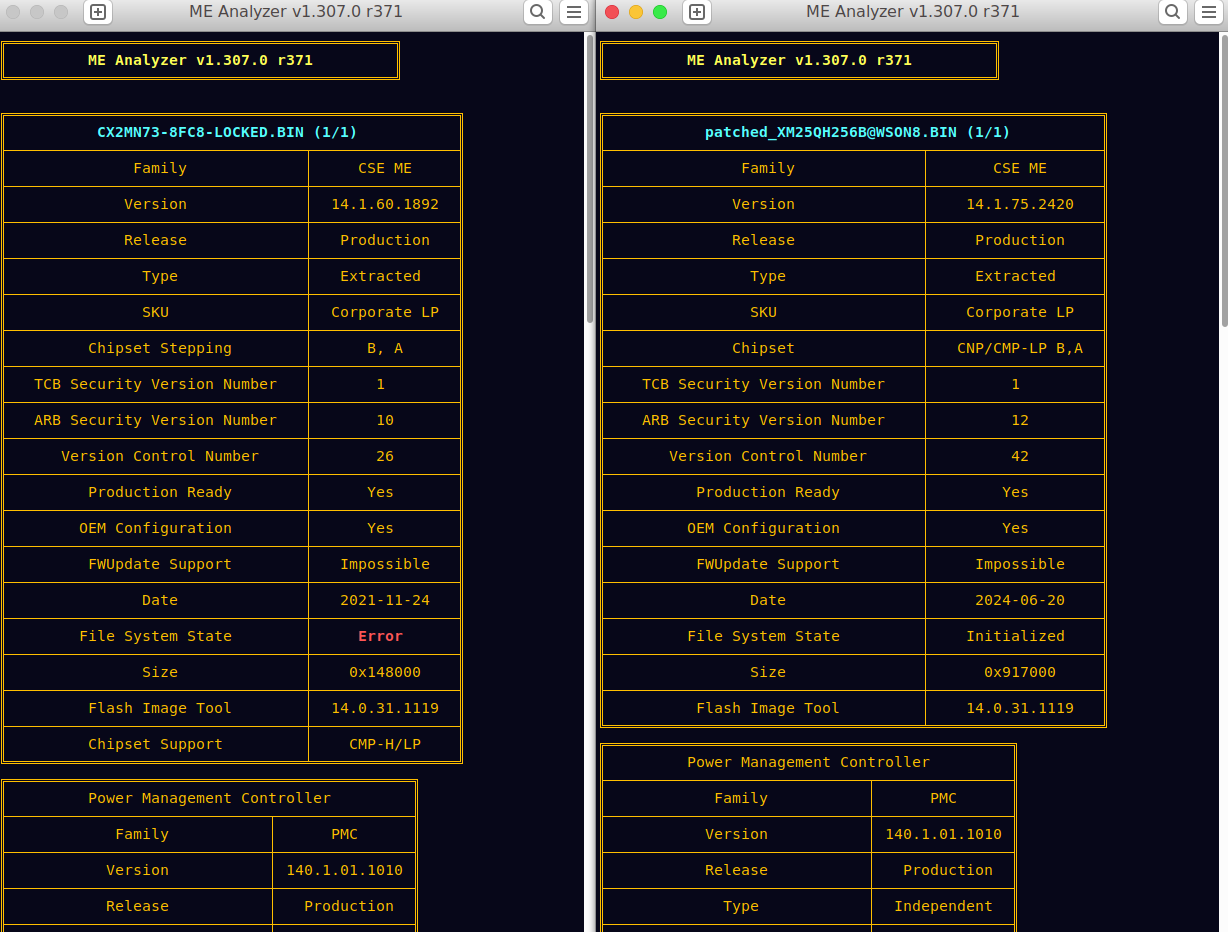

    Hello, I'll try to help.
    peste is quite right in saying that your original BIOS is defective.
    You are missing the entire block from 0-FFFFFF with a length of 1,000,000, or for some reason it is not displayed correctly in the UEFI tool.
    The ME Analyzer says File System State = ERROR, which is not good at all.
    I created a BIOS from Peste's unlocked file from the previous request.
    I copied the block from 0-FFFFFFF and pasted it into yours, and then cleaned up your original ME region.
    That is certainly not the best way, and it doesn't have to work.
    Please note that you do this at your own risk.
    What peste is very right in saying is that nothing beats a good, clean backup of your original BIOS. That is very important.
    Unfortunately, there seems to be a problem reading it.
    Your BIOS is corrupted.
    I'd rather not upload my BIOS file because I don't want it to cause you problems. But I can give it to you if you'd like.

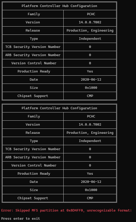

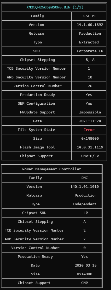

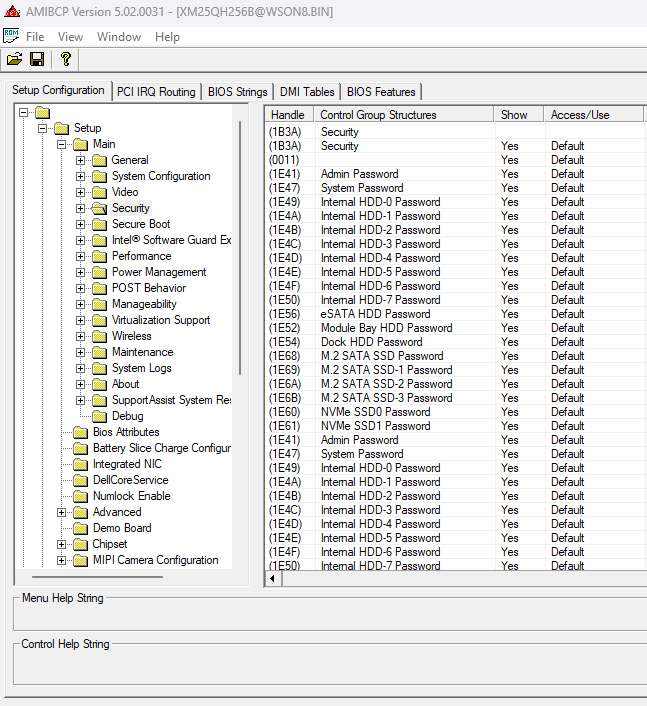

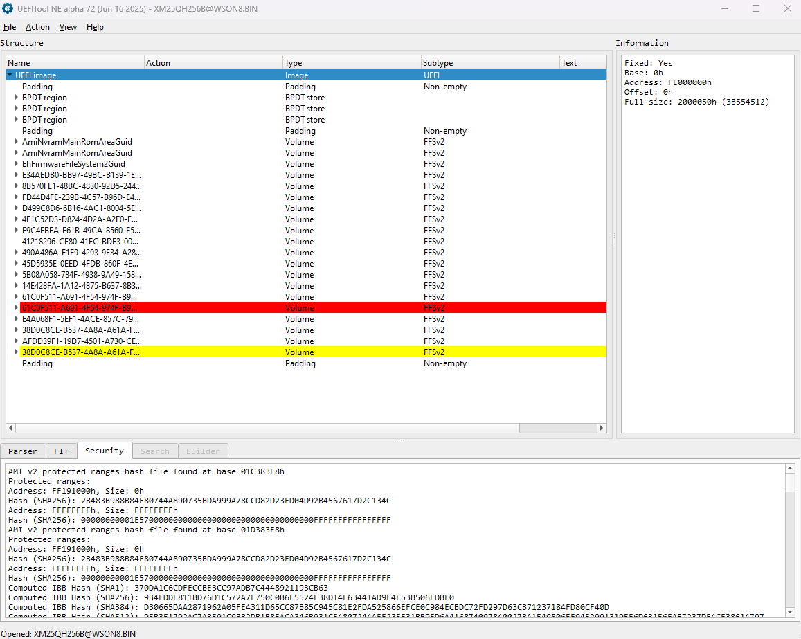

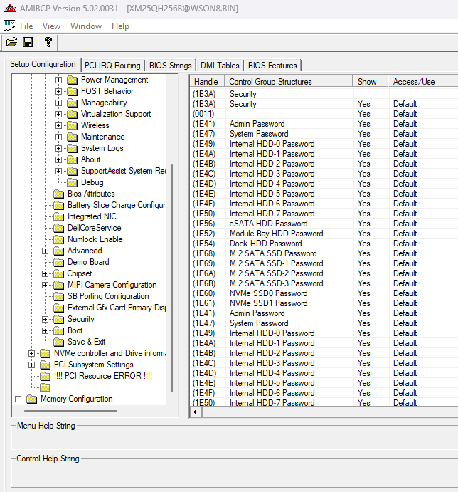

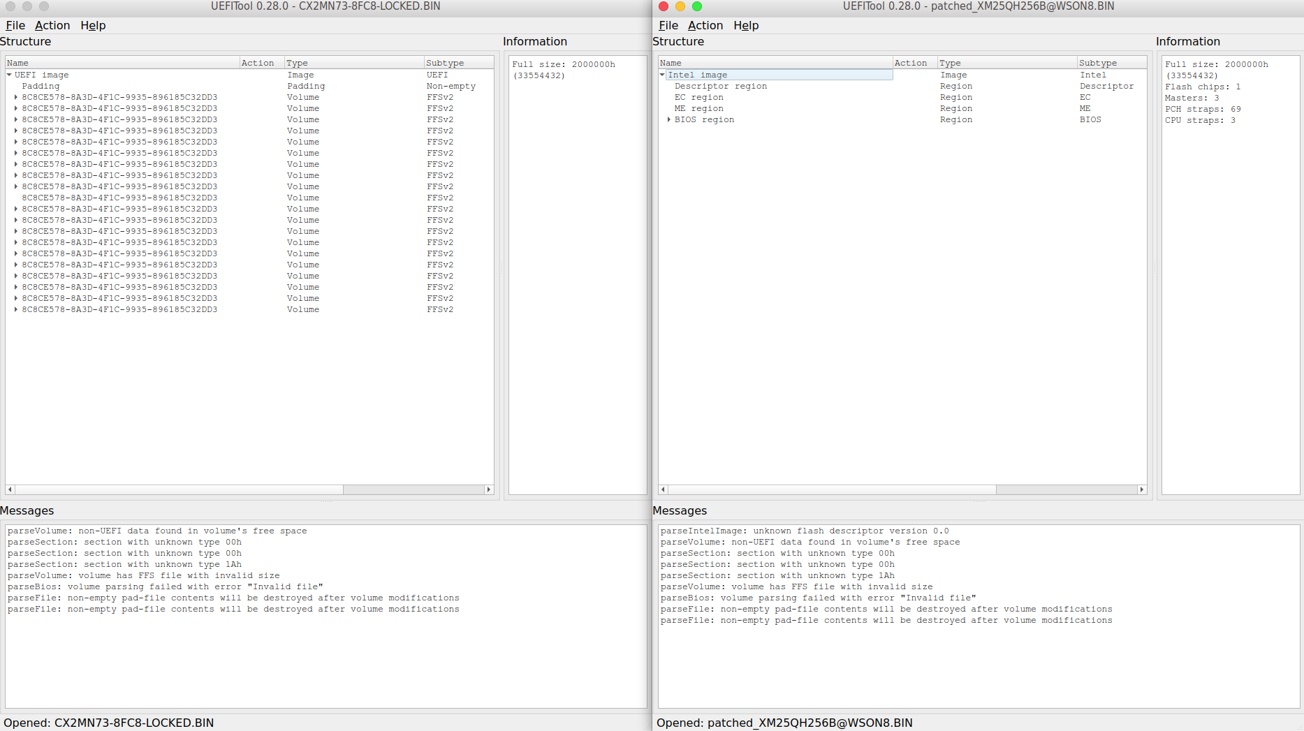

        Okay, I re-read the bios (removed from Board as I originally did) in both programmers, verified and saved bios files.
        Compared both in hex editor and are identical.
        Opened in ME Analyzer (latest version) and got the following;
        Opened in AMIBCP ,and got the following;
        Opened in UEFI Tool, and got the following;
        Is my file still corrupted ? thanks

          Based on what the ME Analyzer says, I'd say it's still corrupted. What does the UEFI tool say? It's strange that the ME Analyzer reports an error.
            updated prev post while you replied lol
            is there any way to prove my programmers are incorrectly reading my bios chip ? I mean this is a working bios, just needs the password removed from it...
