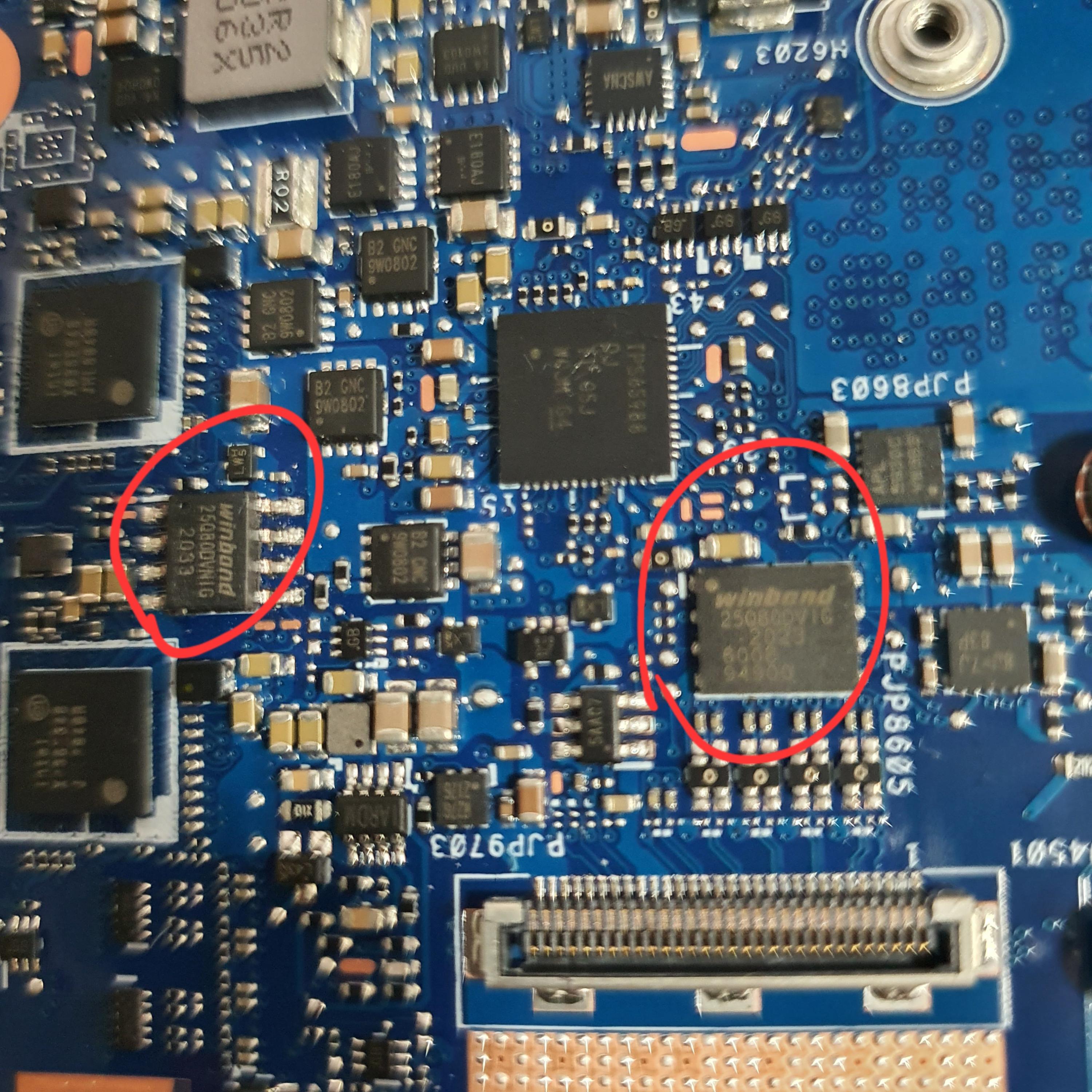

          • bilal767
            • Feb 2023
            • 43
            • United Kingdom
            Re: asus Zenbook Flip 13 UX363 bios backup
            Please see the picture attached. Thanks
            • Vesko356
              VIP Moderator
              • Aug 2018
              • 4386
              • Bulgaria 🇧🇬
              It's not the right chip.

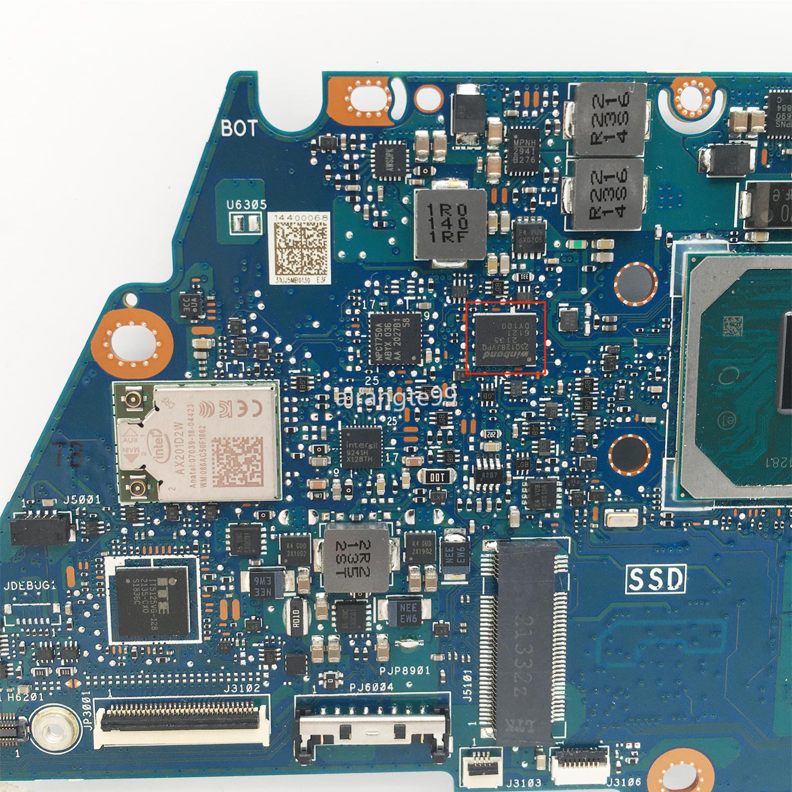

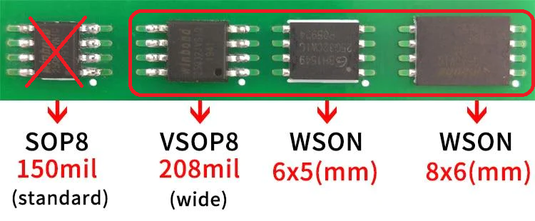

              • hardware1
                • Sep 2021
                • 2936
                • N/A
                This image can help you. Ignore the left one and look for the others.

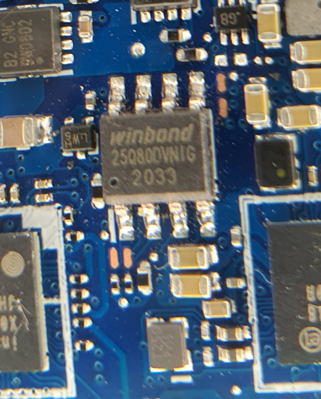

                • bilal767
                  • Feb 2023
                  • 43
                  • United Kingdom
                  Thanks for this. Please check if I have found the right one. I have encircled one in the picture. Thanks
                  • Vesko356
                    VIP Moderator
                    • Aug 2018
                    • 4386
                    • Bulgaria 🇧🇬
                    No. It's not the right one. Search the board further.

                    • hardware1
                      • Sep 2021
                      • 2936
                      • N/A
                      This is also 1MB size, it's the right shape/package but still not the right one.

                      • Vesko356
                        VIP Moderator
                        • Aug 2018
                        • 4386
                        • Bulgaria 🇧🇬
                        The shape you have to look for is already shown by the Hardware1 at #8
                        Could be any of the shown at the image.

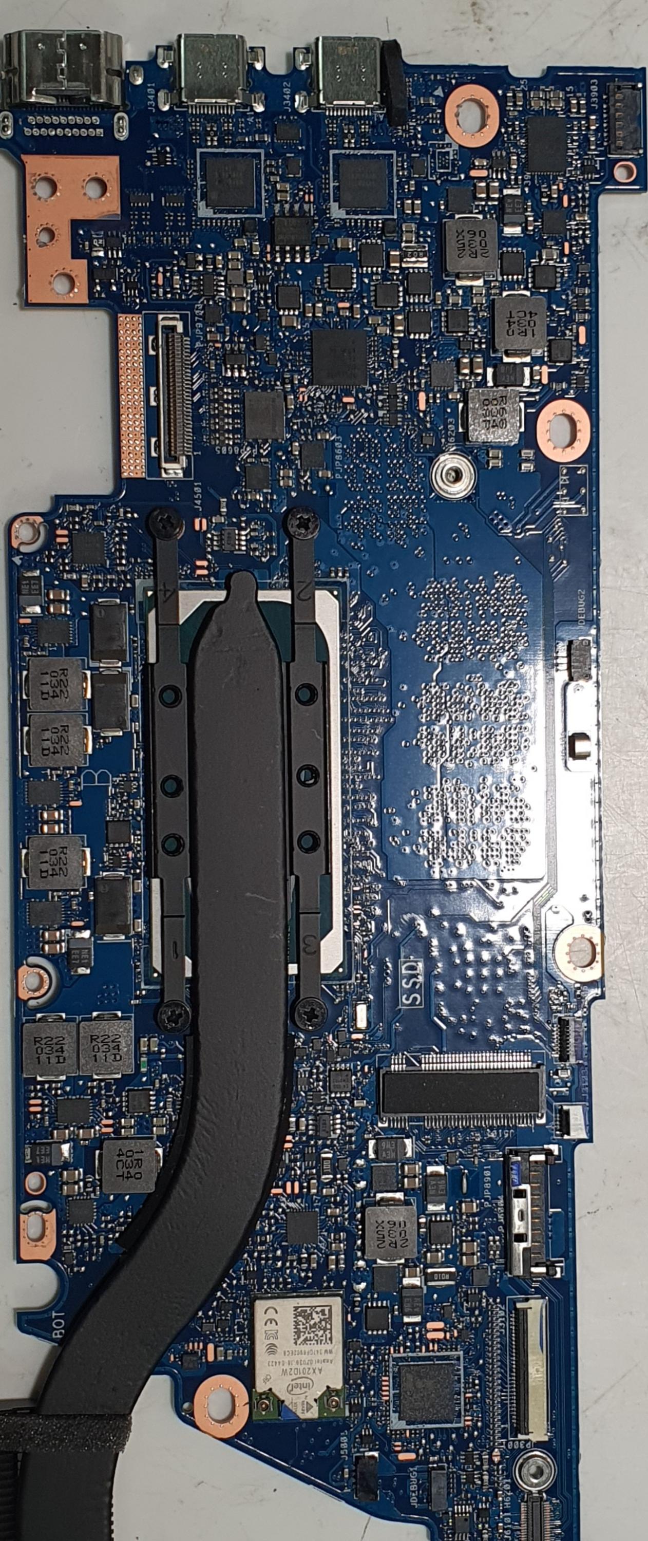

                        • GreenCoder
                          • Jul 2023
                          Originally posted by emaghanim
                          working bios 100%
                          ux363ja
                          Did you read out the chip yourself or copied the data from elsewhere?
                          In case you did that yourself, could you please describe the location of the bios chip?
                          Thanks in advance.
                          • Vesko356
                            VIP Moderator
                            • Aug 2018
                            • 4386
                            • Bulgaria 🇧🇬
                            Thanks in advance.
                            Upload high resolution image of the motherboard.

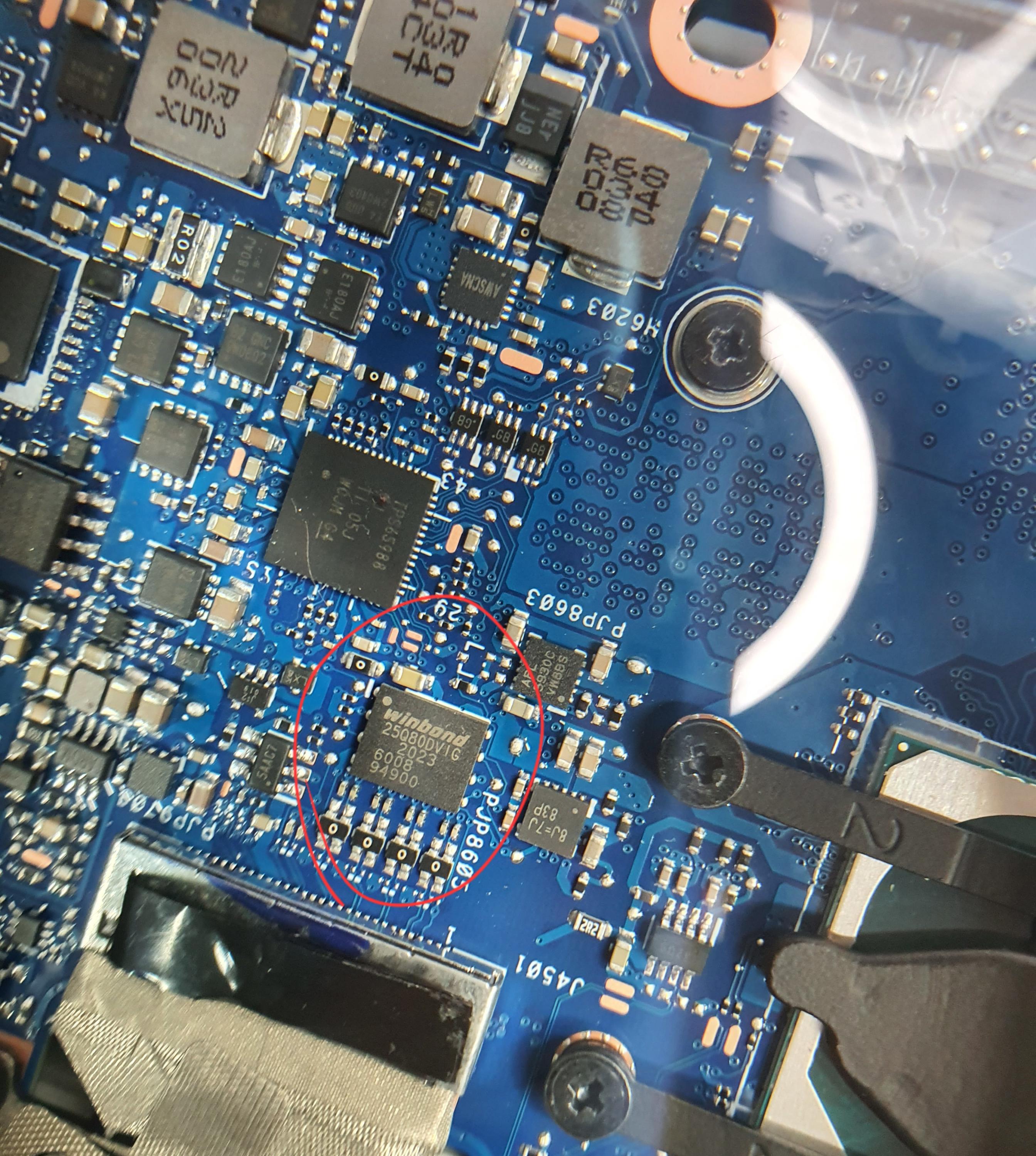

                            • bilal767
                              • Feb 2023
                              • 43
                              • United Kingdom
                              Could anyone please help me finding the right chip of ths motherboard. I have tried reading both chips encircled in the photo but the output file is only 1mb or less. RCunlocker gives error as its not the right file. Thanks in advance
                              • volinakis
                                • Jan 2021
                                • 2741
                                • N/A
                                You have to remove heatsink from CPU and you'll find it as in photo.
