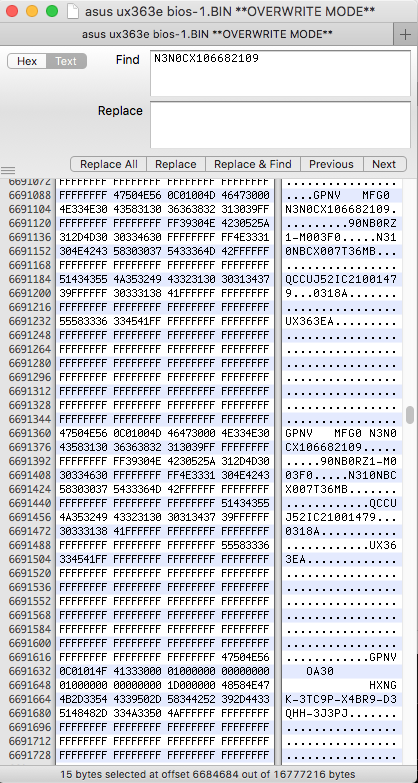

    bios is extracted from latest bios update and clean ME. You have to extract bios_region from bios update, then using proper Intel FIT version to your backup (you can find it using MEAnalyzer) replace Bios Region and ME Sub Partition with extracted bios and proper ME firmware and build new bios image. After that transfer DMI to new created bios image.
    Read this guide created by master SMDFlea, in addition to this guide you also have to replace Bios Region with bios_region extracted from bios update in decomposed image created by FIT.
    https://www.badcaps.net/forum/troubl...cleaning-guide
      Thanks. So i extracted the Bios Region and ME Sub Partition from the original Bios i have to the file you have provided through the correct FIT version, i already did the Build Image, i am partly lost on the last instruction
      "After that transfer DMI to new created bios image." what's DMI. thanks
        serial, snid, win key, etc.
