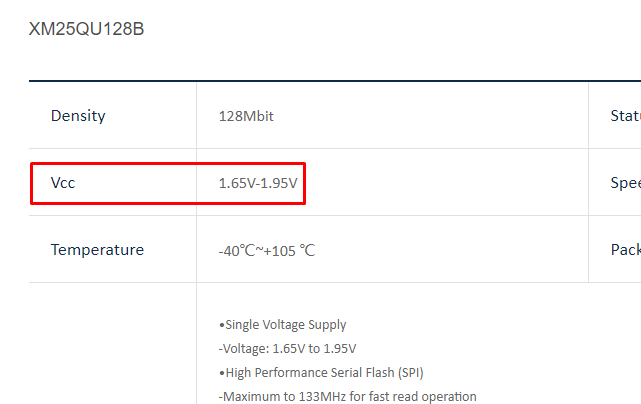

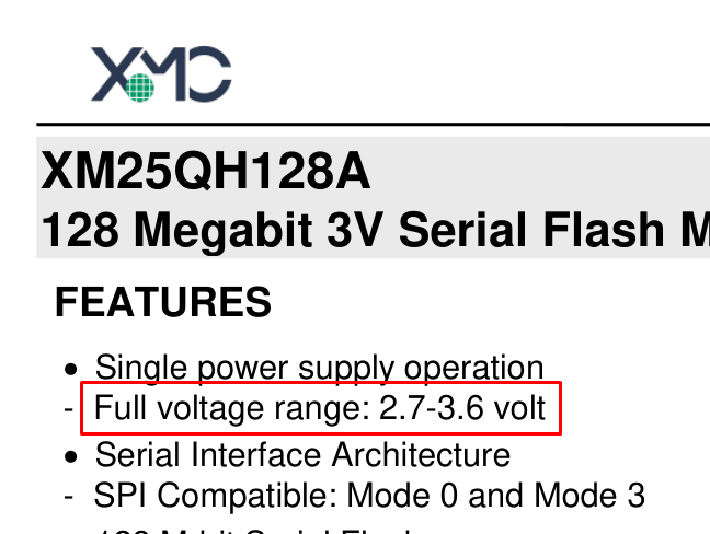

                      Re: Acer Nitro 5 / AN515-44 - need BIOS file
                      Actually the programmer could not pick up the correct BIOS Name & it actually number. So I picked up a generic number. For this model, ACER used a XMC BIOS 25QU128BH1Q. So I used a closet to this model. I think this is a 1.8V BIOS., pls. correct me if I am wrong & which one should I choose, thanks?
                      • DanielDacko
                        • Mar 2015
                        • 328
                        • Macedonia
                        Original chip is working on 3.3V and you have selected one that works on 1.8V. Google the chips before selecting.
                        I don't provide help for people using CH341A and a clip.
                          In my case ACER used this chip XM25QU128B which works from 1.65V~1.95V. I even checked the working voltage of this BIOS chip on the motherboard when I turned the MB on, VCC on pin 8 is full 1.82V, schematic even shows 1.8V. The PDF information on this BIOS is "128MB 1.8V SERIAL FLASH MEMORY WITH 133MHZ MULTI I/O SPI & QUAD I/O QPI DTR INTERFACE".... But the problem was that I could not find this series XM25QU128B in the listing. Please inform me what to select to get the Original BIOS read correctly. Thanks
