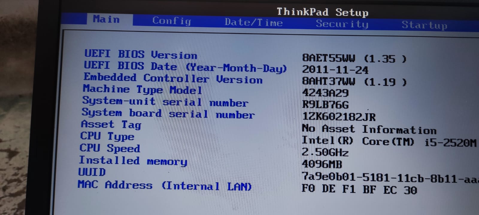

    BIOS PASSWORD Lenovo ThinkPad T520
    Any solution to remove Lenovo bios password removal
    Lenovo machine type model 4243a29
  • OKRPKCOMP
    • Dec 2020
    • 429
    • PAKISTAN
    Re: BIOS PASSWORD Lenovo ThinkPad T520
    Solved
    Just short 5+6 pin of u30 (L08 8 PIN IC)
    Open bios setup
    Remove shorting 5+6 pins of U30
    Change bios pass _______ save
    All is done
