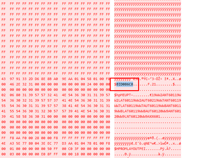

    can someone please check the bios dump if it's ok...the symptom is the same as a bios failure, at least I think so..it won't turn on, the power light is flashing.
    motherboard is da0padmb8g0 rev g

    Re: hp da0padmb8g0 rev g bios
    Serial number?
    EDIT: try this
    https://www.badcaps.net/forum/showpo...18&postcount=7
      5CD105B981 is the serial number. I tried this bios that you submitted to me before publishing my post, but without luck

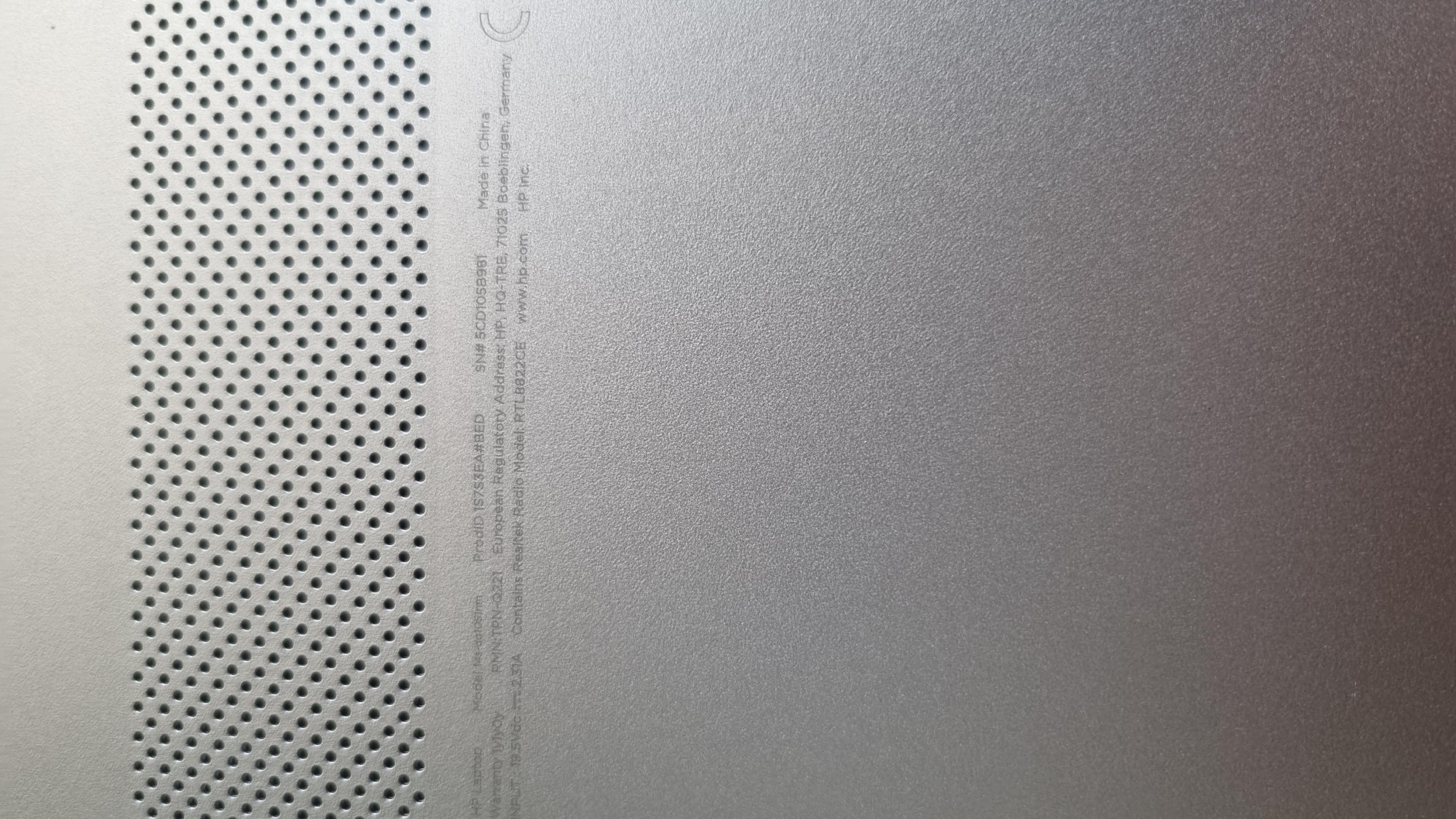

        here is picture of laptop
          Probably not a bios issue, that bios that I posted has the same BID as yours and is extracted from official HP update with clean ME.
