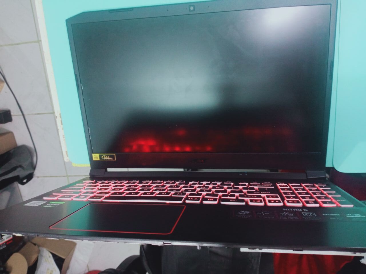

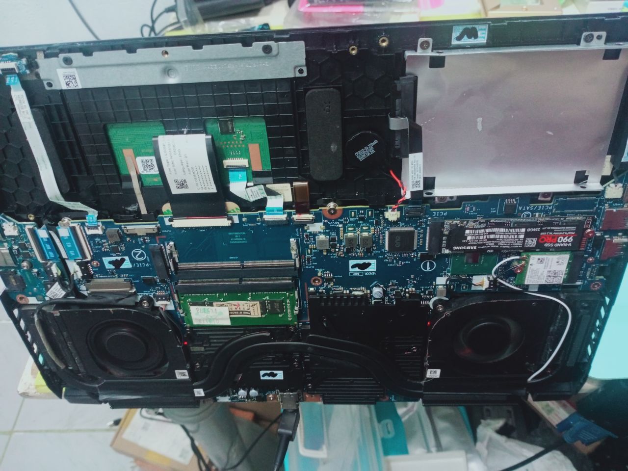

bios Nitro 5 FH51/FH51M LA-J871P
  • mnetobr
    replied
    Hello friends, I have a question, whenever I change a PCH on an Acer notebook, the machine does not turn on if the PCH is used and removed from a different brand notebook, it only works with a new PCH or one removed from another Acer, any chance of a change in the bios making it work? I have this board here (la-j871p), I got the PCH from a Lenovo, but it doesn't work, as expected, I tried different bios​, I have the original bios.
    Leave a comment:
    replied
    Originally posted by dad daaa
    Can someone upload BIOS file for my Acer Nitro laptop..black screen, just keyboard light. Bought new BIOS IC and have programmer tool. Done that before but i cant find bios file
    AN517-52-76YU
    SN: NHQ8KEZ008022054043400
    SNID:02202150834
    MODEL:N20C2
    Post your bios backup.
    Leave a comment:
  • dad daaa
    replied
    Can someone upload BIOS file for my Acer Nitro laptop..black screen, just keyboard light. Bought new BIOS IC and have programmer tool. Done that before but i cant find bios file
    AN517-52-76YU
    SN: NHQ8KEZ008022054043400
    SNID:02202150834
    MODEL:N20C2
    Leave a comment:
  • shiyab
    replied
    Originally posted by steilocants
    HELLO, PLEASE HELP ME WITH THIS BIOS, IT DOES NOT ENABLE VCC CORE AND VCC GT
    FH51M LA J871P REV 1B 2020 06 04
    AN515 55 576K
    SN NHQ7MAL00J051087433400
    SNID: 05103462734
    hi try
    Leave a comment:
  • steilocants
    replied
    HELLO, PLEASE HELP ME WITH THIS BIOS, IT DOES NOT ENABLE VCC CORE AND VCC GT
    FH51M LA J871P REV 1B 2020 06 04
    AN515 55 576K
    SN NHQ7MAL00J051087433400
    SNID: 05103462734
    Leave a comment:
  • hoaca388
    replied
    Originally posted by Jhay_09
    Thank you very much for your response sir Hoaca388..
    Already change BIOS and EC using my SVOD still has no display
    Find hardware issues.
    Leave a comment:
  • Jhay_09
    replied
    Originally posted by hoaca388
    Nitro AN515-55
    Thank you very much for your response sir Hoaca388..
    Already change BIOS and EC using my SVOD still has no display
    Leave a comment:
  • hoaca388
    replied
    Originally posted by Jhay_09
    I need help
    Problem: laptop has power with led lights on keyboard but no display..Thank you in advance
    Motherboard: FH51M LA-J871P REV 1B
    Acer Model: AN515-55 57DA
    S/N: NHQ7NSP004033179AB3400
    SNID: 03309668334
    Nitro AN515-55
    Leave a comment:
  • Jhay_09
    replied
    I need help
    Problem: laptop has power with led lights on keyboard but no display..Thank you in advance
    Motherboard: FH51M LA-J871P REV 1B
    Acer Model: AN515-55 57DA
    S/N: NHQ7NSP004033179AB3400
    SNID: 03309668334
    Leave a comment:
  • peste
    commented on 's reply
    merged post..
  • loris1987v
    replied
    Hi everyone, I need your help, I replaced a mosfset due to no net shorted power, I checked that I have all the voltages and they are correct, the keyboard starts electrically and turns on, I hear the fans starting but nothing on the screen.
    ACER NITRO 5 AN515-55-73PG
    SN: NHQ7MET00B026057803400
    SNID: 02602240034
    MAIN: FH51 LA-J871P REV:1A 2020-03-30
    Thanks so much in advance
    Leave a comment:
  • pronto
    replied
    not workink Blaze Tech maybe i need to falsh ec
    Leave a comment:
  • hoaca388
    replied
    Originally posted by pronto
    HI i need Bios ACER NITRO 5 FH51M LA-J871P REV1.0
    AN515-55-54C1
    S/N NHQ7MEF00M118025803400
    SNID 11800960034
    this is original bios
    Nitro AN515-55
    Leave a comment:
  • Blaze Tech
    replied
    Originally posted by pronto
    HI i need Bios ACER NITRO 5 FH51M LA-J871P REV1.0
    AN515-55-54C1
    S/N NHQ7MEF00M118025803400
    SNID 11800960034
    this is original bios
    try
    Leave a comment:
  • pronto
    replied
    HI i need Bios ACER NITRO 5 FH51M LA-J871P REV1.0
    AN515-55-54C1
    S/N NHQ7MEF00M118025803400
    SNID 11800960034
    this is original bios
    Leave a comment:
  • Blaze Tech
    replied
    Originally posted by TuxTaunk
    i have black screen and reboot
    TRY
    Leave a comment:
  • TuxTaunk
    replied
    Originally posted by TuxTaunk
    can you helpme please whit this bios? thanks
    SNID: 12106230034
    i have black screen and reboot
    Leave a comment:
  • TuxTaunk
    replied
    can you helpme please whit this bios? thanks
    SNID: 12106230034
    Leave a comment:
  • Destroyer-Br
    replied
    New problem ahead with my case.
    Notebook had turned on correctly, everything seemed fine, today I took it apart to finish the maintenance and then I would deliver it to the customer.
    But the notebook stopped turning on, the blue LED lights up, I have 3.3valw and 5valw, but I don't have SUSP# so 3.3VS and 5VS are inactive.
    Could it be that the EC was corrupted?​
    Leave a comment:
    replied
    Originally posted by Errol Reyes
    please clear me my orig bin file
    FH51M LA-J871P
    S/N:NHQ7NSP00C05208D1B3400
    SNID:05203612334
    THANKS IN ADVANCE!
    Attach files directly to your post in a zip or rar.
    RULES UPDATE for BIOS requests/offers AVOID BANNING, READ BEFORE POSTING
    https://www.badcaps.net/forum/troubl...before-posting
    You MUST NOT:
    • Post "clean me", "clear bios", "clean bios", "bios need", "clear me" or other such terms
    You MUST:
    • Provide a BIOS/EC dump if possible
    • Attach files directly to your post instead of linking to external websites
    • Post what the problem is, be specific, - black screen, no boot, running slow, password.Do NOT post "clean me", "clear bios", "clean bios", "bios need" or other such terms
    Leave a comment:
  • macabook
    by macabook
    🧩 Initial Issue
    07-24-2025, 02:17 PM
  • martin83
    Acer nitro 5 AN55-515 fh51m LAJ871P no picture
    by martin83
    Hello everyone.
    I'm here to ask for help troubleshooting an issue with my Acer Nitro 5 An55-515. Board number fh51m LAJ871P .
    The laptop turns on without any image, and after inspection, I noticed the 1.2V voltage was reading 8V spikes. The PQM1 MOSFET's gate was shorted to the source.
    I replaced PQM1, PQM2, and PUM1. After turning on the machine, the 1.2V voltage appears correctly for about 1 minute, but after that, PQM1 shorted again. The MOSFET and controller assembly has already been replaced twice and continues to blow. I can't understand what's going on. I should also add...
    07-14-2025, 06:31 AM
  • pirati
    by pirati
    10-27-2025, 04:20 PM
  • Vesko356
    by Vesko356
    08-11-2023, 03:27 AM
  • jbonavita
    by jbonavita
    Some issues
    Things I tried
    04-29-2025, 09:38 PM
