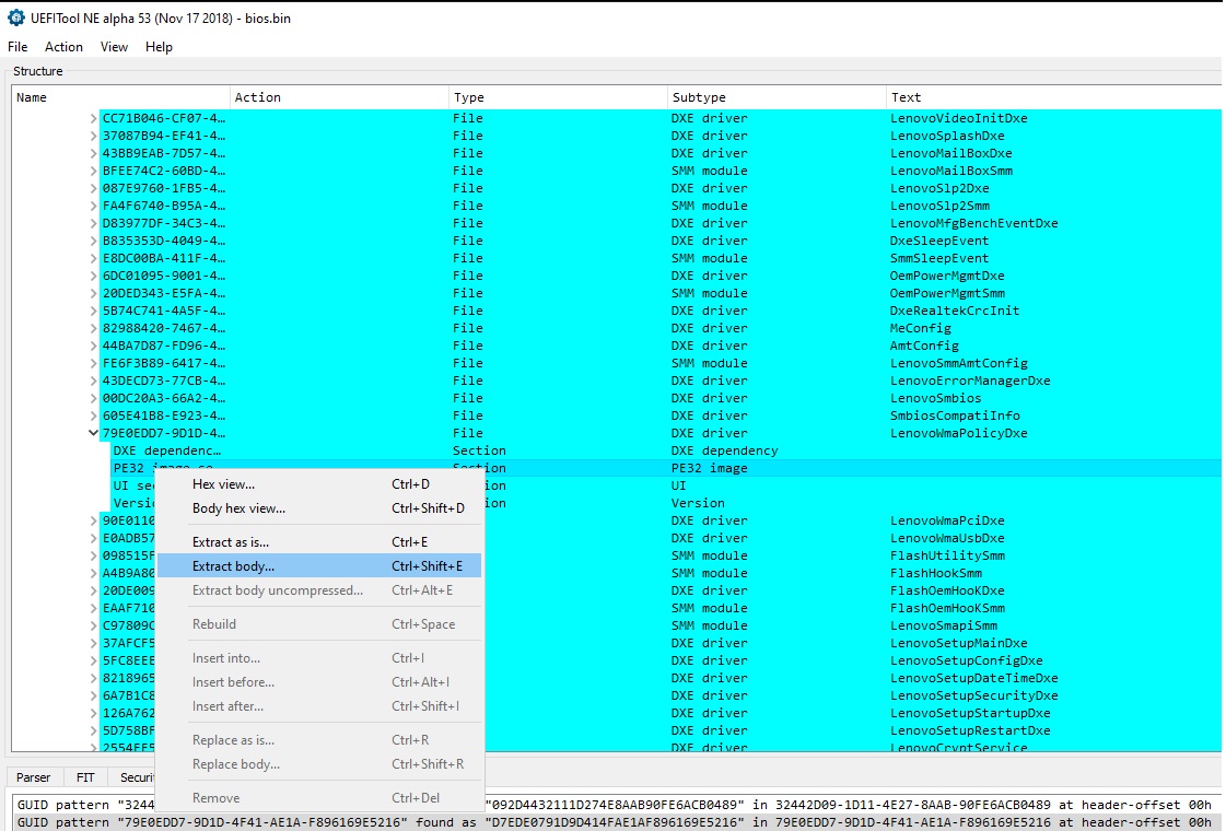

    Hi, I have searched but can't see anything on this for X260.
    I want to install network cards (LTE) that are not permitted by the whitelist in the Lenovo X260 bios - can anyone help if I dump the bios please?
    Cheers!

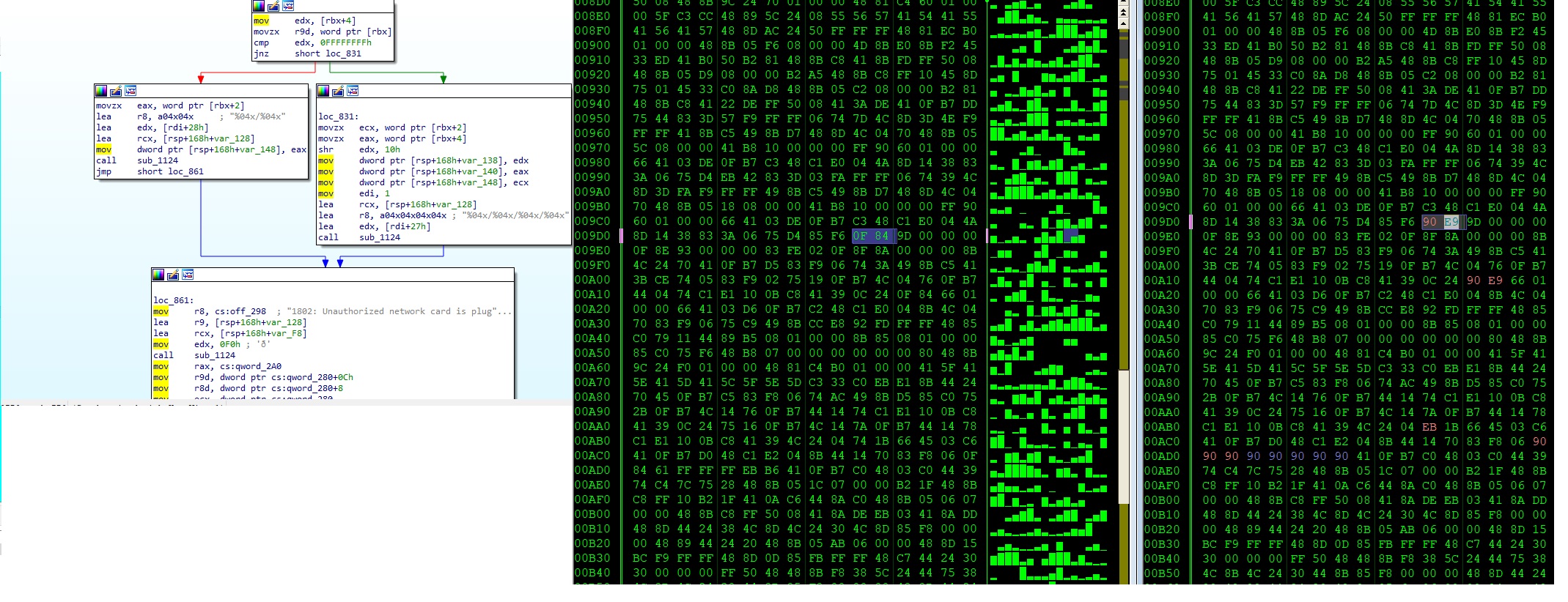

    Search LenovoWmaPolicyDxe GUID: 79E0EDD7-9D1D-4F41-AE1A-F896169E5216
    EXTRACT PE32 BODY (.EFI)
    Then modify conditionnal jumps .
