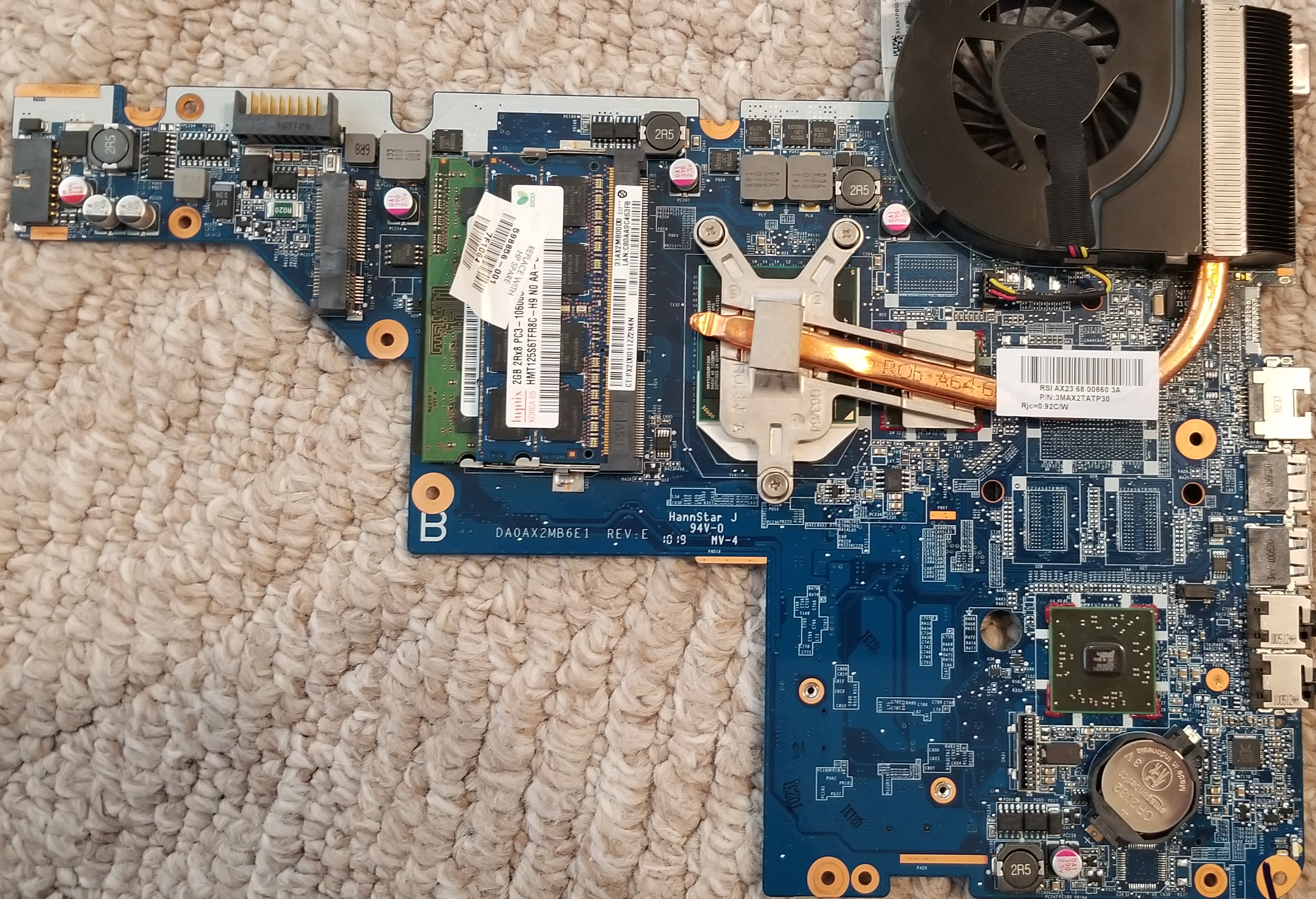

    I have a CQ62-228DX laptop with a DAOAX2MB6E1 REV E motherboard.
    I am 1. trying to locate chip on motherboard and 2. am I even able to reflash this chip.
    I searched thru these forums and others on the google and can not seem to find a solid answer.
    My laptop turns on, blank screen and Caps Lock and wifi lights come on. Caps light blinks.
    If I am able to flash, what version do I flash with?

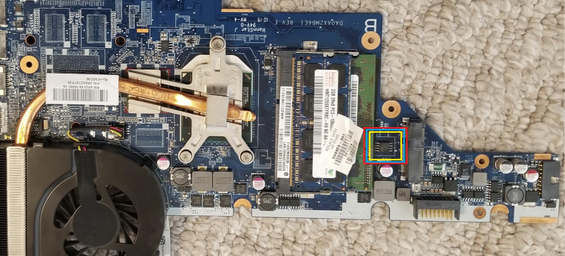

    I think the bios chip is between the RAM memory slot and the WIFI card slot ... post clear pictures with the motherboard ... these motherboards have problems with the video chip ... I would check this first ...

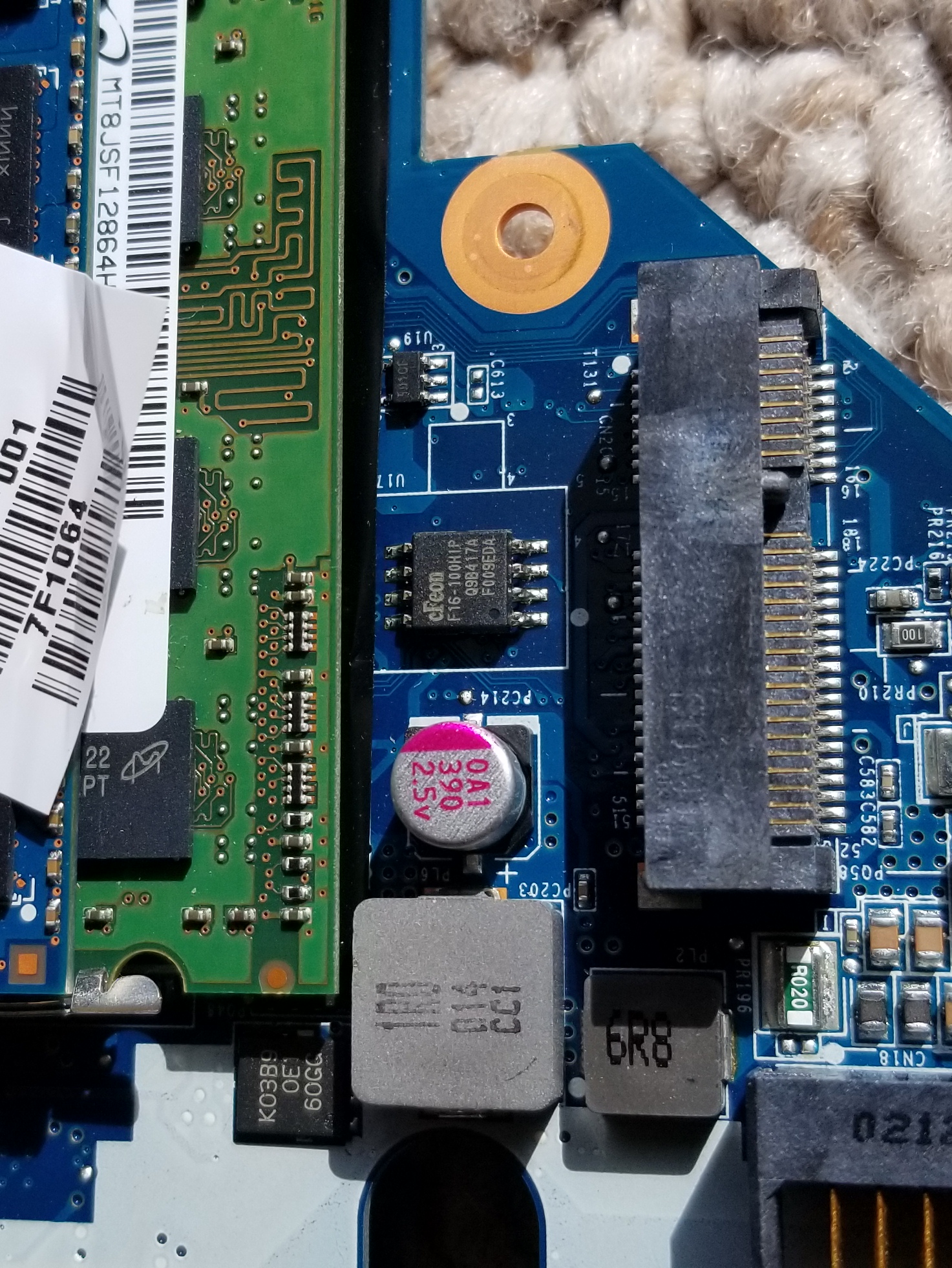

        Re: CQ62-228DX DAOAX2MB6E1 BIOS Chip location
        Originally posted by fritz614
        I have also tried booting with an external monitor and nothing appears there either, FYI
        What's name of chip ?
        • fritz614
          • Apr 2022
          • 6
          I think a fEON? never heard of that one, but I don't look at them often either
          • hoaca388
            Badcaps
            • Jan 2022
            • 11814

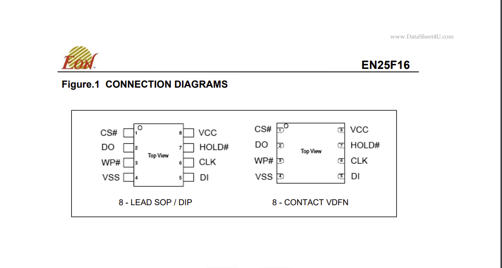

            https://datasheetspdf.com/datasheet/F16-100HIP.html
            I think it is CFeon F16-100HIP

              So, in theory, I should be able to flash it. Would I be able to use the CH341a flasher and if so, do you happen to know which bios file would go to that one?
                try this, but first make a copy of the original bios..you can use CH314A ..
