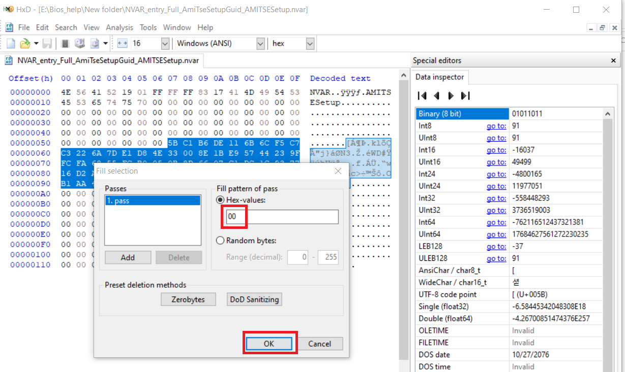

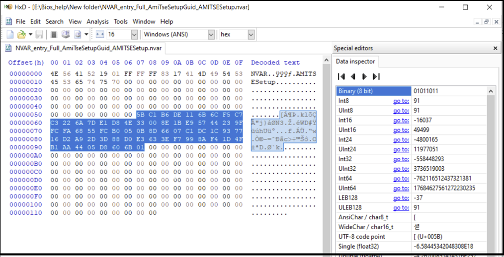

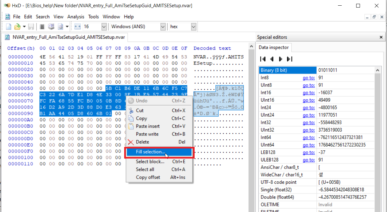

    Re: Panasonic CF-D1N bios password recovery
    Clear password guide :
