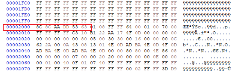

    hello,
    I have
    Lenovo T14 nm-c931 1th gen intel 10th with a difficult problem.
    everything like normal when installing a new fresh windows.
    but the problem is in the first step of configuration.
    when I skip the network connection there is no problem.
    bu when connect to a network, laptop is automatic connecting to a compay.
    laptop has no bios password.
    i have change the serial number
    i have program another bios with original ME.
    i cant find the correct ME for this model
    bu no luck.
    i share the the backup.
    can someone clear and rebuild the original bios?

              i have changed serial number.
              abosulute software (antitheft) is permanently disabled.
              imranromi how can i change the mac adres?

                    @osman68i
                    Any results with changing mac address directly in BIOS?

                      Re: Lenovo T14 nm-c931 1th gen intel 10th
                      same result,
                      i think there is a part in the mec.

                        can you disable the wireless card in the bios setup and try usb stick wifi if you have
                        or doing JTAG and reprogram the MEC with Vertyanov

                          You can try to put another wireless card if thats not help than rewrite Super IO chip.
