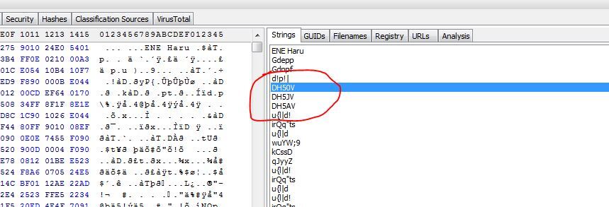

                • 21479
                Originally posted by Jane
                @Gcs_rma
                Thank you for the EC.rar file
                There are 2 files inside. Which file should I use?
                Originally posted by peste
                try them one by one...
                A text string in the KDFG104C.rom EC is EH5JP
                Three text strings in the KA8G116A.rom DH50V , DH5JV and DH5AV​

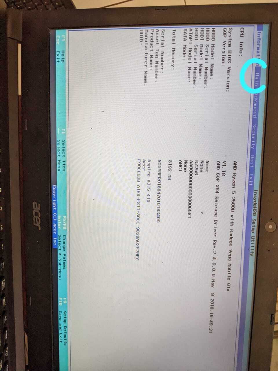

                  A315-41G-R867
                  board code : DH5JV-LA-G021P REV 1C
                  2018-03-02
                  SN : NXGYBER018847010183400
                  always restart logo acer, when enter bios go to menu "main" alway freeze. cannot booting anything(ssd/usb)

                    DH5JV
                    • made46
                      • Feb 2023
                      • 10
                      • Indonesia
                      Originally posted by hoaca388
                      DH5JV
                      thx, i will try
