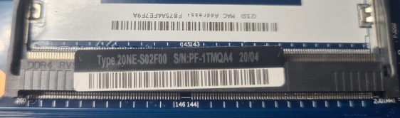

            Please, help me unlock Supervisor Password on ThinkPad E495,
            dump bios
            Thanks.

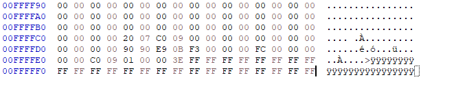

                Re: Lenovo Thinkpad E495 help unlock
                Your Backup Footer not good, try to read the Chip again correctly.
                there is no good backup.. programming another e495 pached dump.. now only a black screen, Caps Lock and nothing else .. how can I restore this notebook?
                  Try this Virgin file and see if the device will works or not.
                  Ignore the Password for now.
                  all donations are welcome,

                      #30
                      good
                      result..started
                      Now to remove the Password, you should to use thit Patched file and follow the steps Carefully.
                      [ HOW TO USE THE PATCH ]
                      STEP 1: Flash and replace current BIOS with the generated patch file
                      STEP 2: Boot the machine
                      STEP 3: Press ENTER/F1/etc. to enter BIOS settings
                      STEP 4: Enter any character when asked for Supervisor Password
                      STEP 5: Press enter when it shows Hardware ID
                      STEP 6: Press space bar 2x when asked
                      STEP 7: Turn off machine
                      STEP 8: Restore original BIOS
                      STEP 9: Reset BIOS settings to factory default
                      [ NOTES ]
                      When booting the patched BIOS you might have to:
                      - Hold the anti-tamper switch down the whole time (use tape)
                      - Remove the hard disk or replace it with a locked one
                      At step #8 you can use the file in Post #28 as your Original BIOS.
