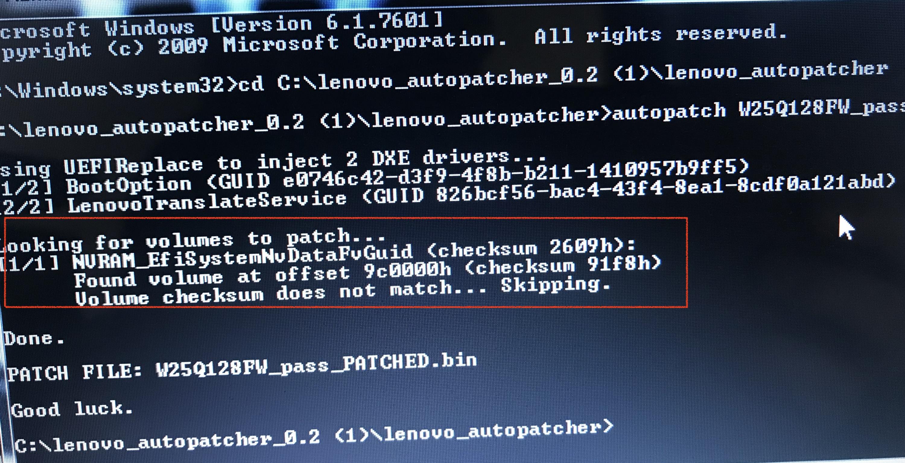

    Can someone help me unlock ThinkPad E495, patcher not working (black screen)
    This is my backup bios.
    Thanks.

                            patching method doesn't work on this model because is skipping inject NVRAM_Efisystem(...)
                              You are asking for patch and say patched method doesn't work! I can't Understand sorry.
                              all donations are welcome,
                              • volinakis
                                • Jan 2021
                                • 2875
                                • N/A
                                Re: Lenovo Thinkpad E495 help unlock
                                yes, the Knucklegrumble's autopatcher doesn't work on this model, dyccc has a method to patch this bios and it works in the same way: F1- any pass, any key, 2x space and replace with original bios. Got it now? how can you expect to work if you got message that is skipping NVRAM_Efisystem(...) when you patched? Same problem with X395 and X13 with Ryzen, it has 16Mb bios chipset but Knucklegrumble's autopatcher doesn't work.
