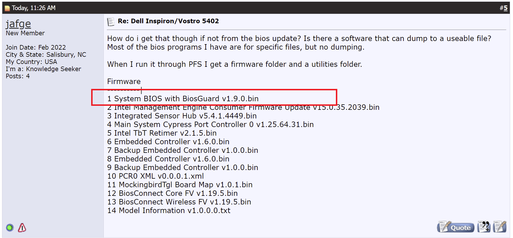

    I need to be able to enable the Thunderbolt security settings. The base thunderbolt settings are there, but the security settings aren't. (display port only, dock settings, etc.)
    I can see the settings I need in Dell Command (DCC/GTTK), but it can't write bios settings since it's not a business line laptop.
    I attached the official firmware. I can extract it with Dell PFS Extract, but I don't get what to do next. If someone could mod or help me mod this I would appreciate the help.

    Where's your original bios file ?

      I don't have a dump, just the update package from Dell that I attached. I know that's got the flasher and updates inside, but they don't extract like the old Dells used to. Now I get a bunch of separate Bin files.

        We need the original bios file to build the new bios file, the file extracted from the exe file is incomplete.

          How do i get that though if not from the bios update? Is there a software that can dump to a useable file? Most of the bios programs I have are for specific files, but no dumping.
          When I run it through PFS I get a firmware folder and a utilities folder.
          Firmware
          1 System BIOS with BiosGuard v1.9.0.bin
          2 Intel Management Engine Consumer Firmware Update v15.0.35.2039.bin
          3 Integrated Sensor Hub v5.4.1.4449.bin
          4 Main System Cypress Port Controller 0 v1.25.64.31.bin
          5 Intel TbT Retimer v2.1.5.bin
          6 Embedded Controller v1.6.0.bin
          7 Backup Embedded Controller v1.0.0.bin
          8 Embedded Controller v1.6.0.bin
          9 Backup Embedded Controller v1.0.0.bin
          10 PCR0 XML v0.0.0.1.xml
          11 MockingbirdTgl Board Map v1.0.1.bin
          12 BiosConnect Core FV v1.19.5.bin
          13 BiosConnect Wireless FV v1.19.5.bin
          14 Model Information v1.0.0.0.txt

            I don't know if there is any software that can do that.

              As you have a working machine try to update the bios to the latest,if it still doesn`t have what you want to achieve then contact dell and check if its even possible with the current bios. Modifying the bios might not be an option

                This is the latest BIOS. I just need to add the correct module to it so I have more functionality. I have a bios from a Latitude that has the upgraded functionality so I'm going to extract it and compare the bios to see what the difference is in the modules.
