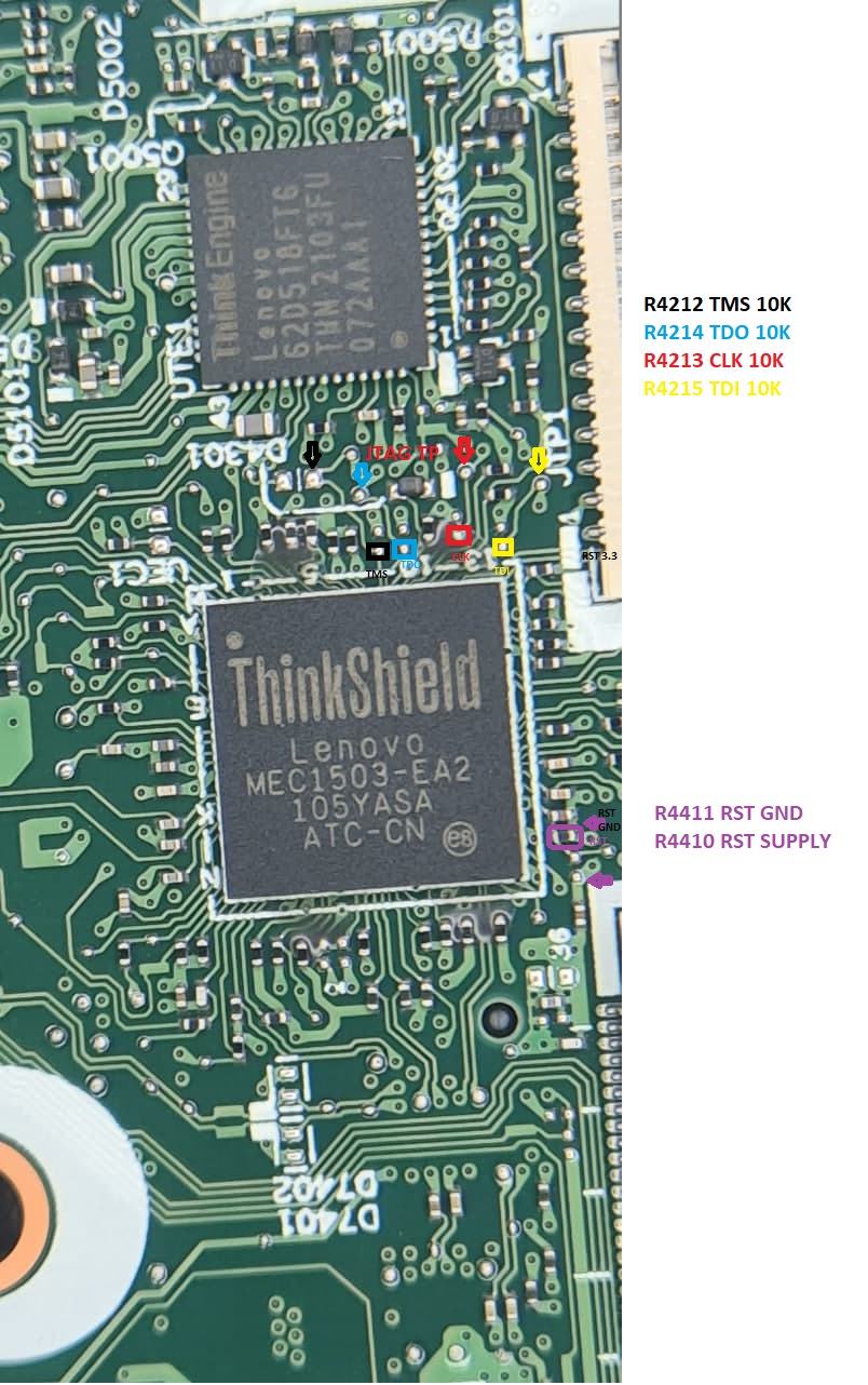

lenovo l14s g2 mec1503 pinout
  • ilias7790
    • Oct 2018
    • 36
    • Sverige
  • evserv
    • Jun 2014
    • 363
    • Russia
    Re: lenovo l14s g2 mec1503 pinout
    This chip is not yet supported by any programmer
      SVOD 3 programmer
      • evserv
        • Jun 2014
        • 363
        • Russia
        where is it written that the SVOD can work with this chip?
          SVOD 3 , SVOD 4 programmer has not seen support for MEC-1503 chip.
                        j-link segger can operate with mec1503
                            j-link can't dump mec1503 from thinkpad
                            log:
                            - Target interface speed: 1000 kHz (Auto)
                            - VTarget = 3.301V
                            - TotalIRLen = 18, IRPrint = 0x000001
                            - JTAG chain detection found 1 devices:
                            - #0 Id: 0x02232445, IRLen: 18, Unknown device
                            - Connect failed. Resetting via Reset pin and trying again.
                            - ERROR: CPU-TAP not found in JTAG chain
                            - ERROR: Failed to connect.
                            Could not establish a connection to target.
                            - ERROR: Connect failed​

                              I WORK WITH J LINK TOO BUT I CANT HAVE ID FOR THIS CHIP MEC1503 MOTHERBORD NM-D341
                              • anhbanxoi
                                • Sep 2021
                                • 180
                                • VN
                                Remove the JTAG_STRAP resistor then you'll see the ID but unable to read with J-Link
