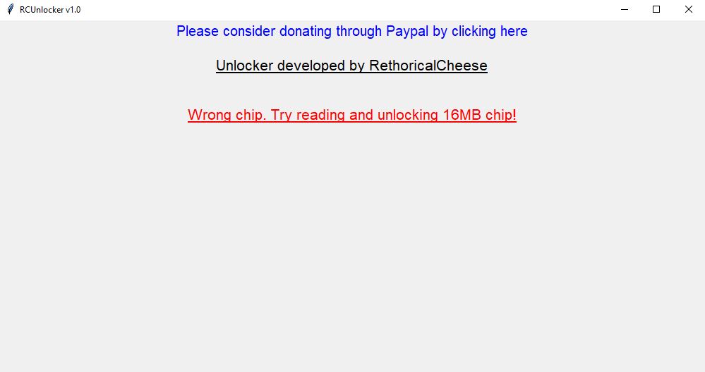

    No, i was build a new file from your file. Of course it should be 16MB.
    The file you build still gives the same error....any other ideas on how to get rid of the error message ? or other code that could disable that message?
