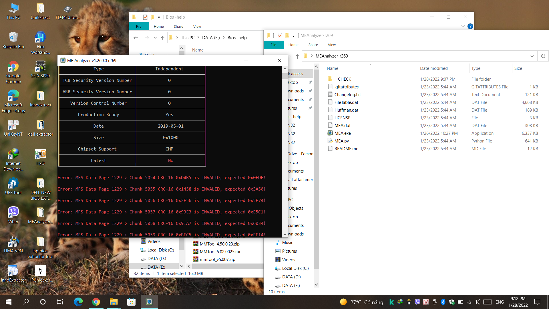

    Please help
    This laptop came from another repair shop it was no power after measurements the pch was the problem i replace pch ic and now the laptop came for life again but no display knowing that this was the main problem
    i attach the laptop bios file if any one can help
    my question is after pch need clear me or no
    laptop model predator triton 300
    SN:NHQ7AAA003033128323400

    Check your file with ME-Analyzer , it's show :
      can you tell me where i can find bios chip on this mbo
      i have 2 bios chip and both when reading and check with me analyzer give erro
      the first one attach in the first post , the second one give me no intel engine firmware.
        Have you tried flashing the file I posted above?
