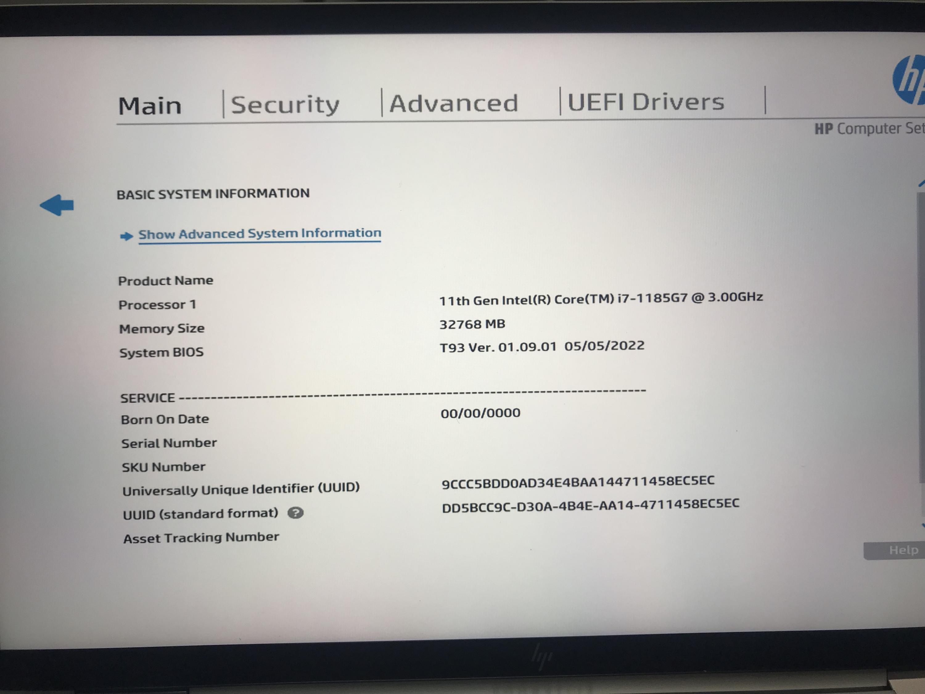

              HP EliteBook x360 1040 G8 PORFAVOR ME PUEDES DESBLOQUEAR ESDTA BIOS
              try. it will enter in MPM mode, press F10 and you have a tab under "Main" named " set machine unique data" and you'll find all data on stickers of back of the bottom cover. to exit MPM mode use BCU 4.0 under windows or restart laptop how many times counter shows.

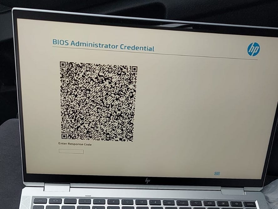

                elitebook x360 1040 g8 HELP ME TO UNLOCK
                  • 21874
                  Re: elitebook x360 1040 g8 Unlock this bios please.
                  Learn how to use a hex editor, compare the bios at posts 6 and 7 ,then you can do it yourself. Maybe when you do learn to hex edit you can help others with their bios problems and contribute something back to the forum.
                            I use hpunlocker hex edetor not worked
                            Backup another chip on other side of the board.
                            • anhbanxoi
                              • Sep 2021
                              • 180
                              • VN
                              no result admin password
                              Try this file.

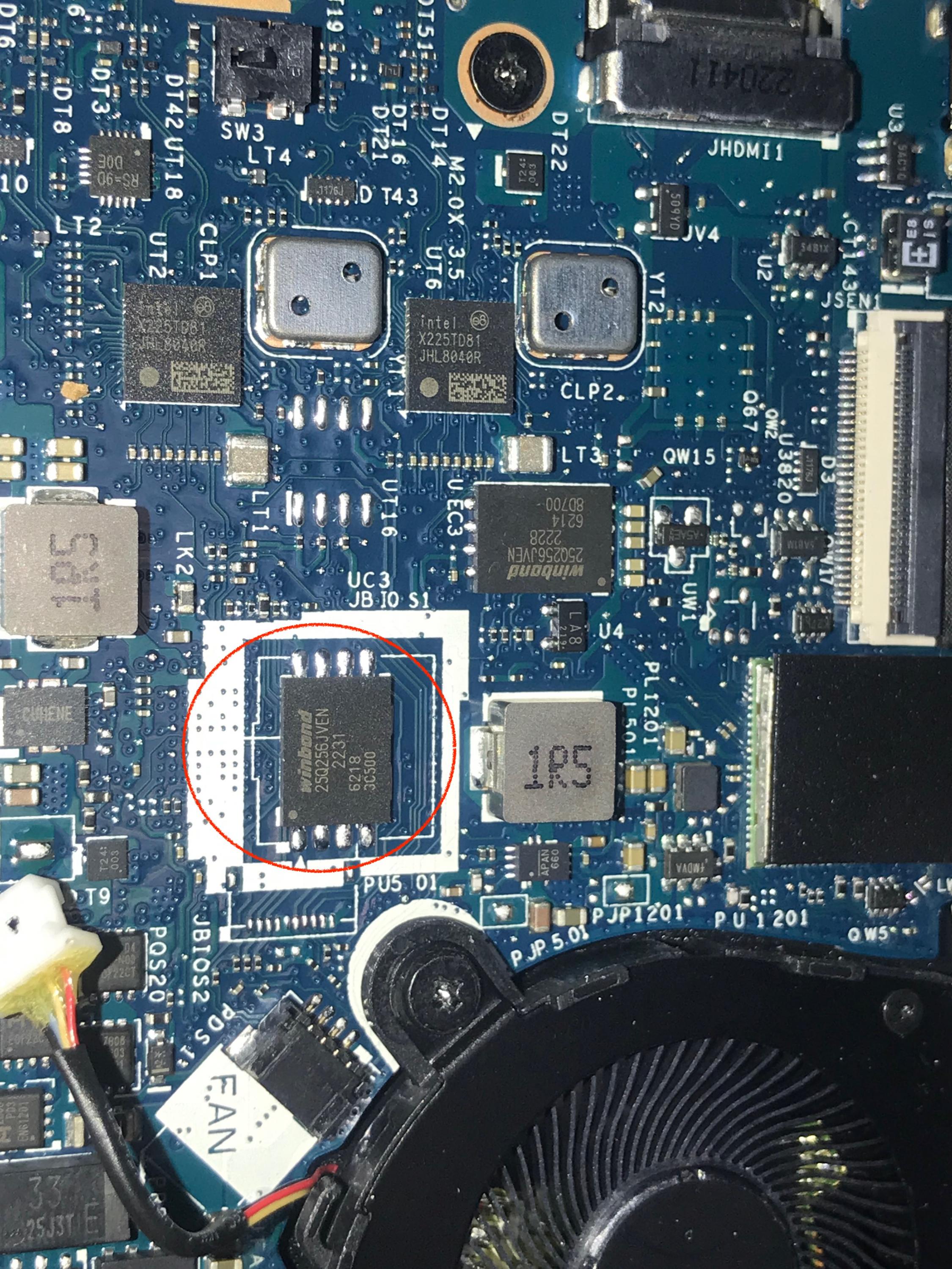

                                    Upload the dump from the other chip - EC3.

                                      THIS IS DUMP FROM EC3 thanks in advance
                                        Program this chip only, leave the other as is. At first boot enter the bios and reset bios settings to factory default, then reset security settings, then apply (save), restart and you're good to go.
