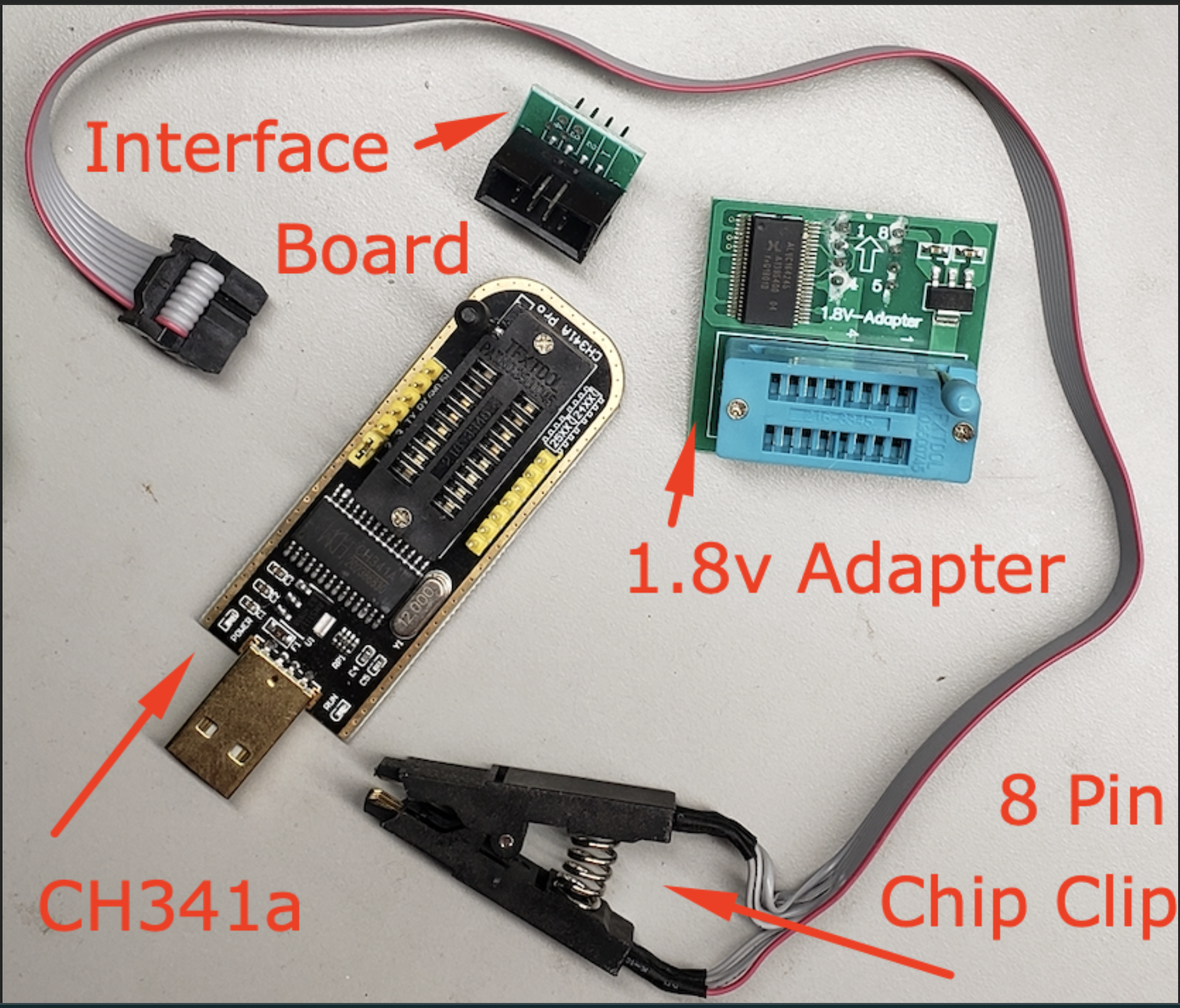

AMITSESetup Decryptor
  • axeba
    • Feb 2025
    • 4
    • Italia
    #161
    Thanks you so much! and sorry for english (translate), Saved this computer from trash !!!!
    • Chipsi
      • Jun 2018
      • 3
      • Finland
      #162
      Tried this but didn't succeed to find password, any ideas?
      Machine is Asus GL10CS-NR113T
      SN: K7PDCG001024270​
      • hoaca388
        Badcaps
        • Jan 2022
        • 12347
        #163
        Originally posted by Chipsi
        Tried this but didn't succeed to find password, any ideas?
        Machine is Asus GL10CS-NR113T
        SN: K7PDCG001024270​
        SN: K7PDCG001024270​[
        • Gspot
          • Mar 2025
          • 2
          #164
          Please I ned help to decrypt password or else just to unlock. thank you
          Panasonic / Toughbook CF-195MAC3CA
          SN:4KKSA05211
          Motherboad: DFU2123ZB
          • hoaca388
            Badcaps
            • Jan 2022
            • 12347
            #165
            Originally posted by Gspot
            Please I ned help to decrypt password or else just to unlock. thank you
            Panasonic / Toughbook CF-195MAC3CA
            SN:4KKSA05211
            Motherboad: DFU2123ZB
            Panasonic / Toughbook CF-195MAC3CA
            • Bozog
              • Jan 2022
              • 125
              #166
              Hi, can someone help unlock this file, I tried zeroing out the password in 2 locations but it didn't seem to work - just black screen, what am I missing?
              Toughbook CF-20GV-52TE
              Serial 2EKCD30382
              • Bozog
                • Jan 2022
                • 125
                #167
                Originally posted by Bozog
                Hi, can someone help unlock this file, I tried zeroing out the password in 2 locations but it didn't seem to work - just black screen, what am I missing?
                Toughbook CF-20GV-52TE
                Serial 2EKCD30382
                Don't worry, I fixed it - one of the tiny resistors had broken.
                Now the BIOS is unlocked the HDD doesn't seem to work anymore, aaargh
                • stevebeef
                  • Mar 2025
                  • 9
                  • germany
                  #168
Name:	image.png
Views:	422
Size:	12.4 KB
ID:	3605113
                  this is what i get?​
                  • Gspot
                    • Mar 2025
                    • 2
                    #169
                    Originally posted by hoaca388
                    Panasonic / Toughbook CF-195MAC3CA
                    Sorry for late reply ..!
                    With my trial and error, I manage to get it worked. and just comparing the bin file I got the same result as you do
                    so from this I have learned something new
                    And thanks for your response knowing i'm in the right paths
                    • Areos
                      • Jun 2020
                      • 36
                      • México
                      #170
                      Thank you!! works great for vivobook E1504F.
                      • My3Rckio
                        • Apr 2025
                        • 6
                        • Italy
                        #171
                        Hi, I have an Asus E510MA with an administrator password in the BIOS that I don't know and I can't find a way to delete it. The Alt+R method doesn't work, the Decryptor doesn't find anything and with the Freeware Hex Editor software the probable password is not decoded from the site https://www.rapidtables.com. I also managed to update the BIOS but the password remained. What should I do? Thanks​
                          SMDFlea commented
                          Editing a comment
                          post your backup ,and laptop serial number.
                      • My3Rckio
                        • Apr 2025
                        • 6
                        • Italy
                        #172
                        The serial number is:
                        MANOCX27H786434​
                        • Bios Cracker
                          • Oct 2024
                          • 322
                          • India
                          #173
                          Originally posted by My3Rckio
                          The serial number is:
                          MANOCX27H786434​
                          Try and Update.
                          • My3Rckio
                            • Apr 2025
                            • 6
                            • Italy
                            #174
                            The WinFlash software does not let me update the BIOS because it tells me that "it is previous to the current version"!!! 😫😥
                            • My3Rckio
                              • Apr 2025
                              • 6
                              • Italy
                              #175
                              I tried with the command "/nodate" from cmd and the software starts but in this case it tells me that the BIOS file is not valid....
                              • hoaca388
                                Badcaps
                                • Jan 2022
                                • 12347
                                #176
                                Originally posted by My3Rckio
                                I tried with the command "/nodate" from cmd and the software starts but in this case it tells me that the BIOS file is not valid....
                                Use this
Name:	2025-04-20 09_46_10-.png
Views:	387
Size:	3.09 MB
ID:	3618920
                                https://www.youtube.com/results?sear...mer+how+to+use
                                • My3Rckio
                                  • Apr 2025
                                  • 6
                                  • Italy
                                  #177
                                  Is it not possible to decrypt the password from the bios backup I sent you? If via software it tells me that the bios you corrected is not valid, what happens if I flash it forcibly with a programmer? And in any case, since I had updated the bios to the latest version but the password remained, could it be that this is saved on another chip?
                                  • Stefan Steff
                                    • Mar 2024
                                    • 368
                                    • Romania
                                    #178
                                    Originally posted by My3Rckio
                                    Is it not possible to decrypt the password from the bios backup I sent you? If via software it tells me that the bios you corrected is not valid, what happens if I flash it forcibly with a programmer? And in any case, since I had updated the bios to the latest version but the password remained, could it be that this is saved on another chip?
                                    I can't decrypt your password but I can remove it if it's ok...
                                    • My3Rckio
                                      • Apr 2025
                                      • 6
                                      • Italy
                                      #179
                                      Unfortunately it tells me that the BIOS file is not valid like the other one that had been kindly unlocked for me. I don't understand why this happens. If I were to forcibly flash this unlocked BIOS I fear that I could completely brick the notebook
                                        • 21998
                                        #180
                                        Originally posted by My3Rckio
                                        Unfortunately it tells me that the BIOS file is not valid like the other one that had been kindly unlocked for me. I don't understand why this happens. If I were to forcibly flash this unlocked BIOS I fear that I could completely brick the notebook
                                        Buy an SPI programmer.
                                          09-12-2024, 02:20 PM
                                        • Jaime Morillo
                                          by Jaime Morillo
                                          08-18-2025, 11:38 AM
                                          HP ProBook 450 G6 + Image Load & Asset Tag Notebook 400 Specification for Upgrade or Repair
                                          This specification for the HP ProBook 450 G6 + Image Load & Asset Tag Notebook can be useful for upgrading or repairing a laptop that is not working. As a community we are working through our specifications to add valuable data like the 450 G6 + Image Load & Asset Tag boardview and 450 G6 + Image Load & Asset Tag schematic. Our users have donated over 1 million documents which are being added to the site. This page will be updated soon with additional information. Alternatively you can request additional help from our users directly on the relevant badcaps forum. Please note that we...
                                          09-06-2024, 10:56 AM
                                          HP ProBook 430 G6 + Image Load, Asset Tag & Testntag Notebook 400 Specification for Upgrade or Repair
                                          This specification for the HP ProBook 430 G6 + Image Load, Asset Tag & Testntag Notebook can be useful for upgrading or repairing a laptop that is not working. As a community we are working through our specifications to add valuable data like the 430 G6 + Image Load, Asset Tag & Testntag boardview and 430 G6 + Image Load, Asset Tag & Testntag schematic. Our users have donated over 1 million documents which are being added to the site. This page will be updated soon with additional information. Alternatively you can request additional help from our users directly on the relevant badcaps...
                                          09-06-2024, 10:56 AM
                                          HP ProBook 450 G6 + Image Load, Asset Tag & Testntag Notebook 400 Specification for Upgrade or Repair
                                          This specification for the HP ProBook 450 G6 + Image Load, Asset Tag & Testntag Notebook can be useful for upgrading or repairing a laptop that is not working. As a community we are working through our specifications to add valuable data like the 450 G6 + Image Load, Asset Tag & Testntag boardview and 450 G6 + Image Load, Asset Tag & Testntag schematic. Our users have donated over 1 million documents which are being added to the site. This page will be updated soon with additional information. Alternatively you can request additional help from our users directly on the relevant badcaps...
                                          09-06-2024, 10:56 AM
