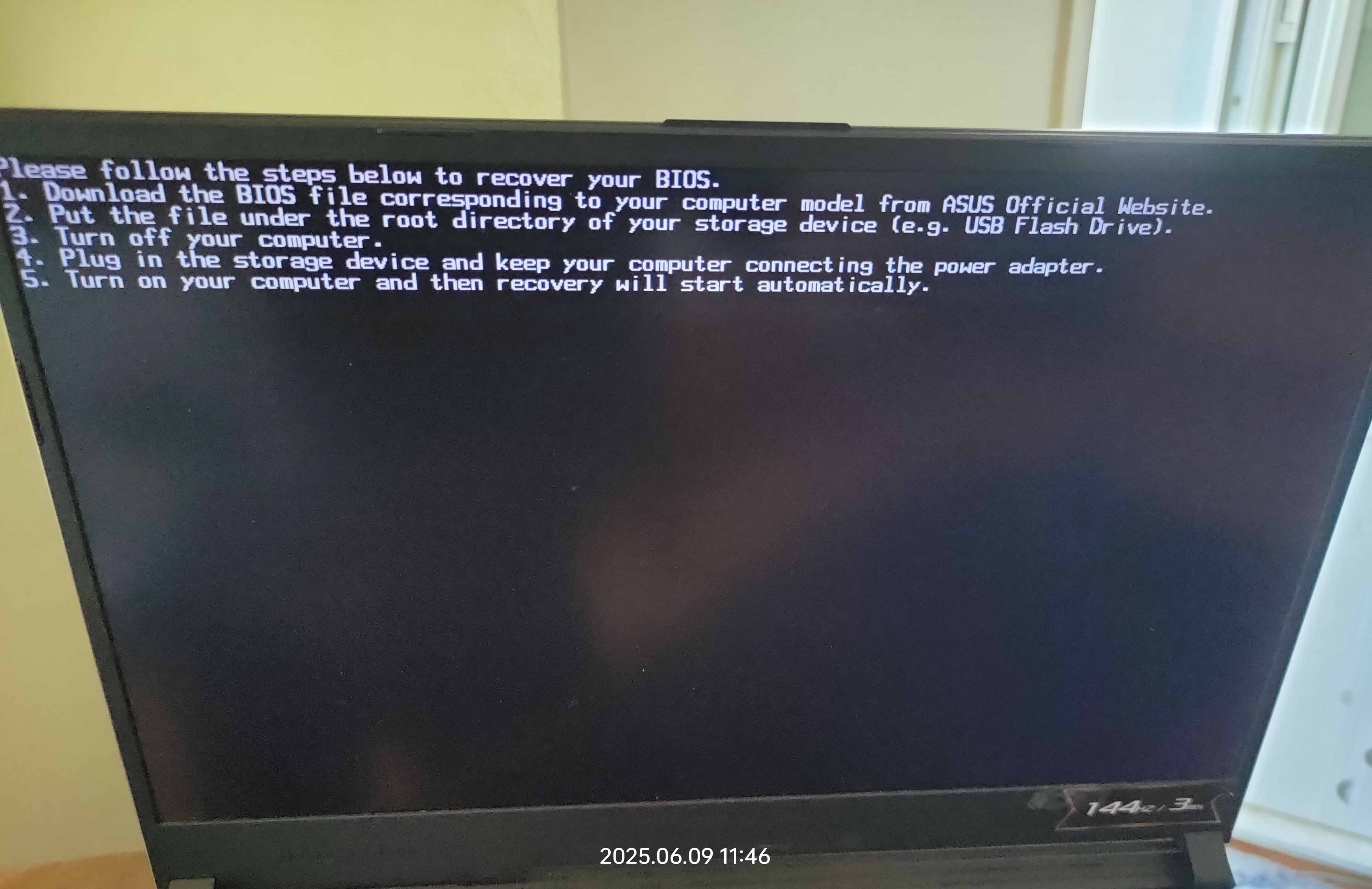

        the screen in the image below showed up after i installed the patched version you provided using this command line:
        .\AFUWINx64.exe G712LWS_patched.rom RECOVERY /B /N REBOOT
        and it retained for like 2 to 3 minutes and then the device booted by itself to windows, but the password still exist.
        also the AFUWIN GUI kept giving me errors, so i used the terminal instead, errors like 18 and 32, (unable to read sectors or something)
        ...and did you try the presented recovery method ?
        I downloaded your recovery file, so copy it to the root of a USB stick and reboot your laptop.
        At least we try to unlock your device. If you will manage to read the BIOS flash with a programmer then are more chances to reset your forgotten password...

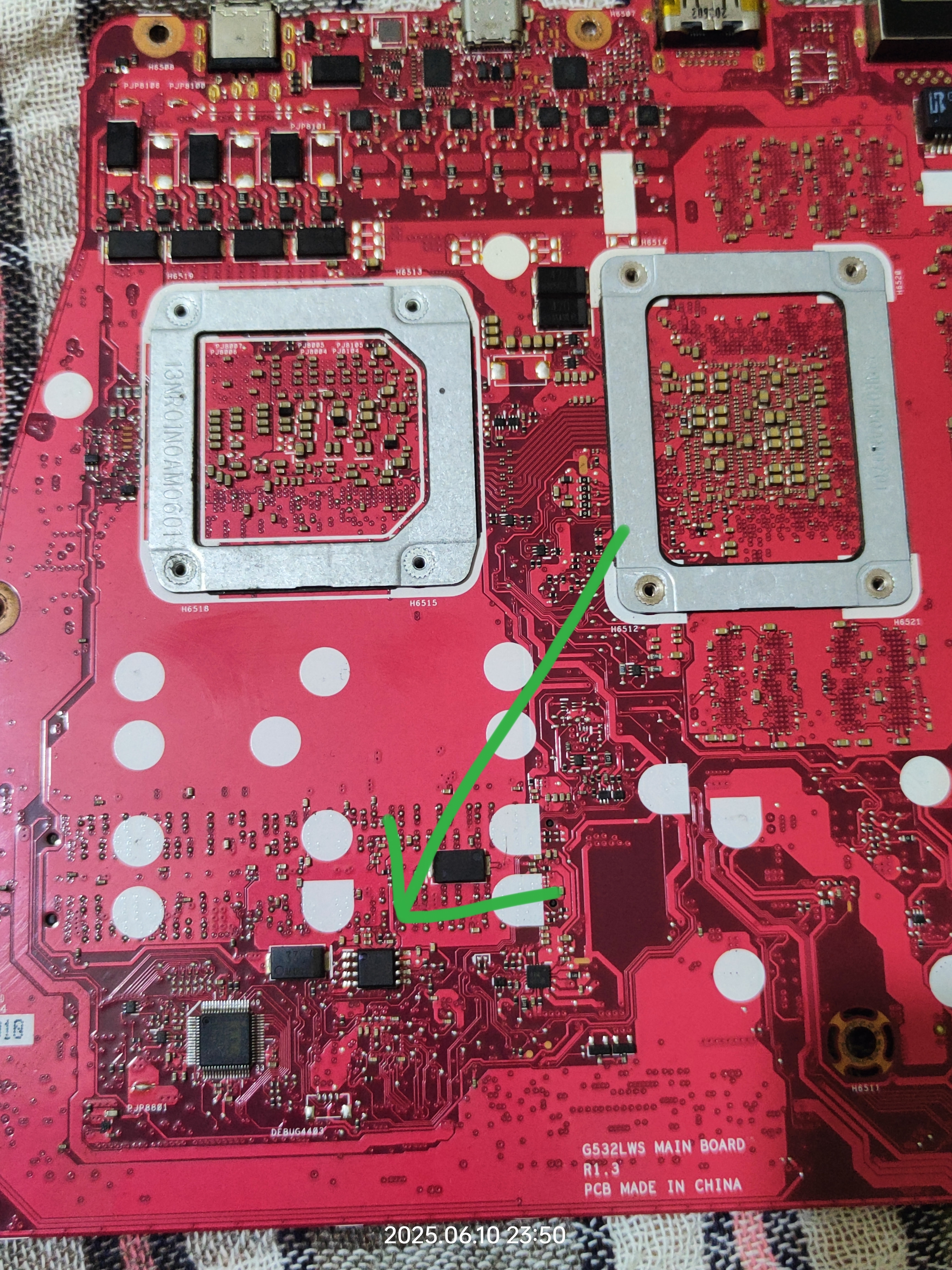

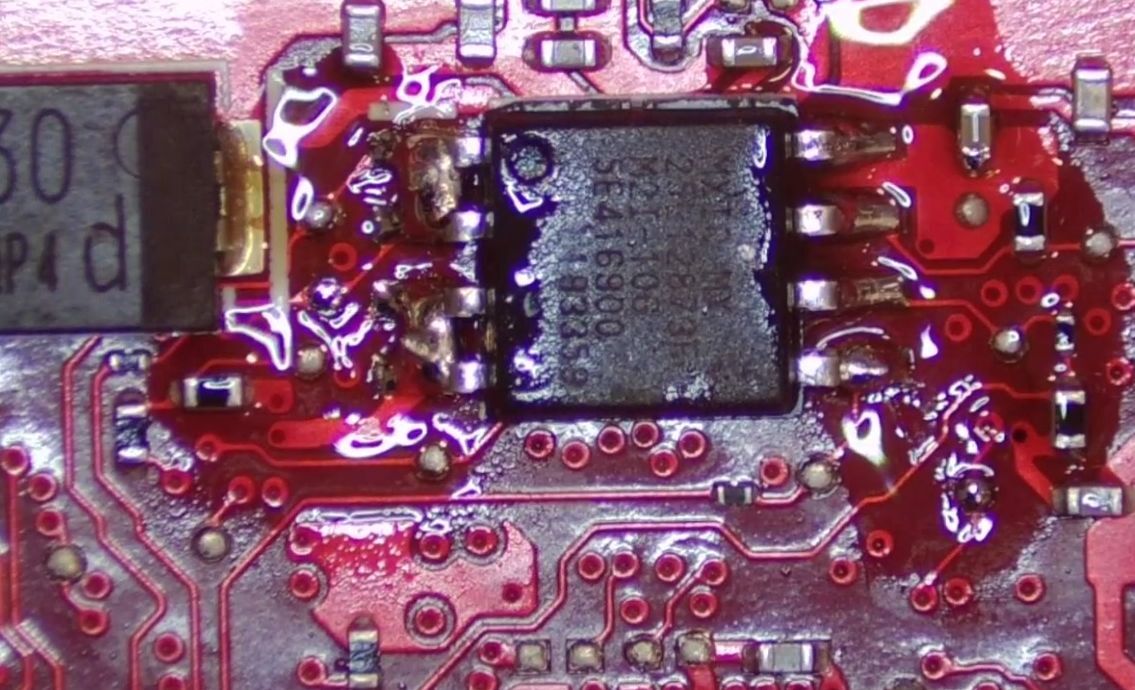

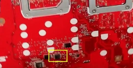

                                isnt it this chip?
                                there isn't any other chip on the motherboard that the clip can stick on except this one in the image, also the programmer detected it automatically.
                                WINBOND 25Q80EWNI15 2015
                                • Stefan Steff
                                  • Mar 2024
                                  • 357
                                  • Romania
                                  #216
                                  Originally posted by TraJikar Mac
                                  isnt it this chip?
                                  No, No...must be something like 25Q128JV or FV...anyway '128' must be in the name of the chip.
                                  Look on the other side too

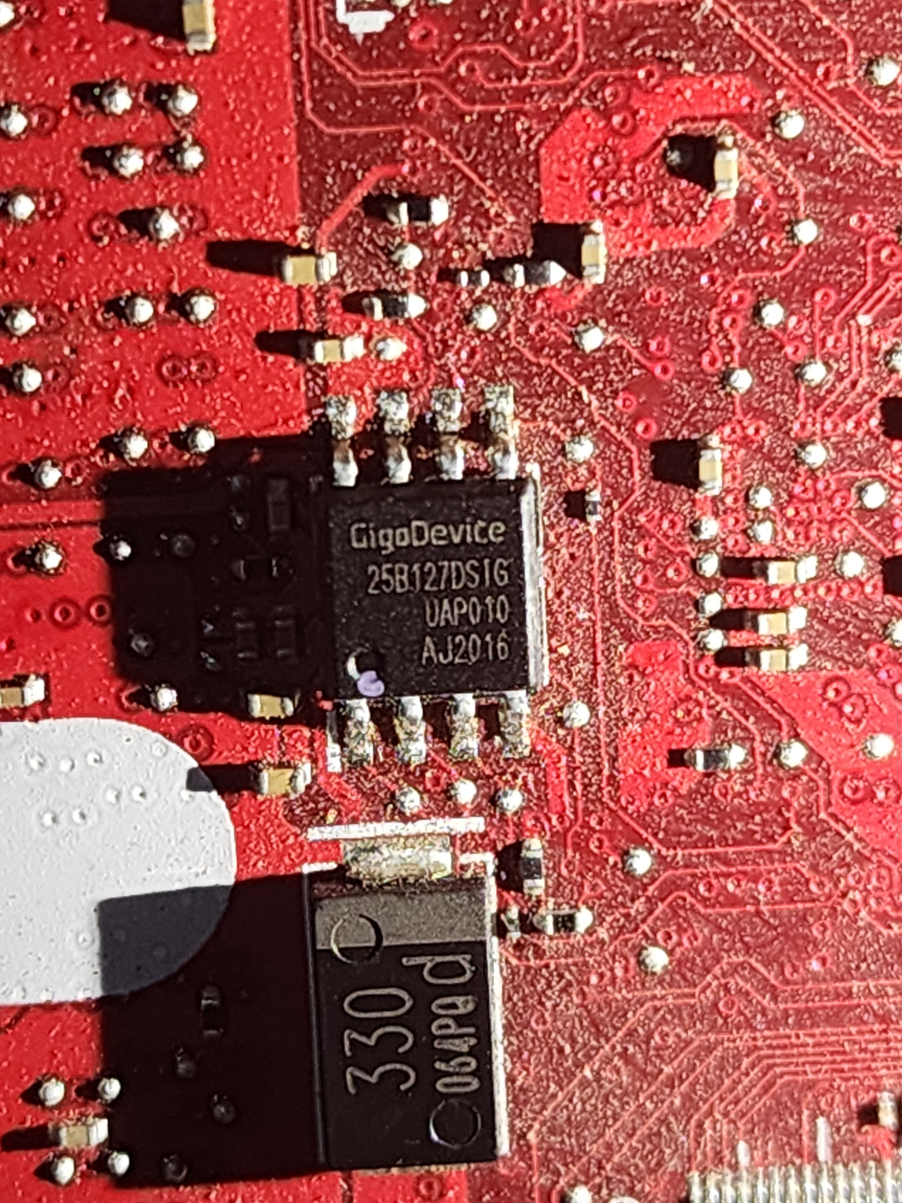

                                    is it this one?
                                    and another question, if the flashing succeeded, after turning on the device, will the other chip recover its code? because its erased automatically when i tried to write that BIOS file into it.
                                    EDIT:
                                    I have 3 valid backups with the same md5 value that I extracted from the chip "WINBOND 25Q80EWNI15 2015" today, but the chip doesn't accept to flash any of them.

                                      EDIT:
                                      Last update:
                                      After I have made tens of researches,
                                      1: I figured out that the WINBOND chip needs an adapter (1.8v) plugged into the ch341a programmer to be able to write on it without problems (luckily I'm it is not broken because of the many times i tried to write back the backup images into it).
                                      2: Later I decided to connect the bios into the flasher, and i took many backups (see the attachment file), they were all with the same md5 value.
                                      Problems I faced:
                                      - Firstly, the flasher couldn't read the real name of the bios chip, but a one the is really close to it, and from the internet, some people faced the same problem and flashed on the different bios name and the claim that they succeeded.
                                      - - I found the reason that was causing this problem and how to fix it.... It was the USB port of the laptop that i plugged the flasher into it, and I fixed it by connecting into a hub that uses its own power supply charger (Ugreen hub 7 ports), and then plugged the hub into laptop's USB port and (NeoProgrammer) was able to get the exact name of the BIOS. OR the clip might not be plugged correctly on the chip, so make sure you try many times before you decide to plug the flasher into, i.e. a usb hub or external power source ==> BTW, this tip was from ChatGPT o4-mini-high
                                      - I also learned that before you try to write any rom/bin/firmware image, you have to click on READ and then VERIFY to make sure that the flasher you use will not fail while its trying to inject/install the firmware image, so you know that you are using the right adaptor or working flasher (not broken).
                                      - from some videos i watched, modifying the flasher may lead to install modified firmware images that gets modified during the installation process. (so don't modify the flasher you bought, just make sure that you are using the right adaptor for the chip you want to flash, and connect it to the adaptor, and connect/plugin the adaptor into the flasher). ==> here I'm talking about CH341A Black flasher cases.
                                      - I need someone to that know how to modify the manufacturer bios file so it's size become equal to one of the backup files' size. I'll be very thankful for who can help me doing this, as I don't know how to do it.
                                      Thanks in advance.
