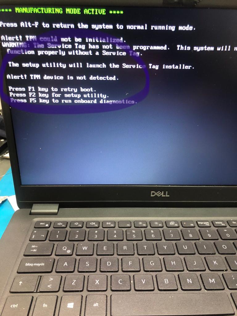

          Please Dell Latitude 3410 with a admin password
          I have tried all the files on this forum and they work why service tag number loop error. Thanks for the help.

            Re: Please Dell Latitude 3410 with a admin password
            Originally posted by MICHAEL_2013
            I have tried all the files on this forum and they work why service tag number loop error. Thanks for the help. My ST:3GKX763
            The Dell BIOS is unique to each laptop, it should not be shared. The service tag is not only an identification, it is linked to the location and security of the owner.
              Thanks. Erased. PLease erase your replay

                • MICHAEL_2013
                  Originally posted by tdelfy
                  try it
                  Thanks for your time. You bios working 50%, I can't change asset tag or service tag. Bios loop and does not allow to change them.
                      you try it
                      Thanks for your time. now have a new TPM message but are unable to change the Asset Tag and Service Tag
                        @MICHAEL_2013
                        Return with original BIOS for laptop, this is important for KBC! Check operation. Being normal, I will perform the unlock.
                          @MICHAEL_2013
                          Yes sir, I already left it original again
                            Update: Everything solved thanks to all. I used UEFI tools, I extracted ME region and put it in another bios that I found in the forum. Closed topic.
                              This is the wrong way when trying to do the right thing...
                              With that you lost the original service tag, serial number, MAC, etc...
                              Not to mention the malfunction of some devices.
                                Service tag. Asset Tag change in Bios. (ALT-F).
