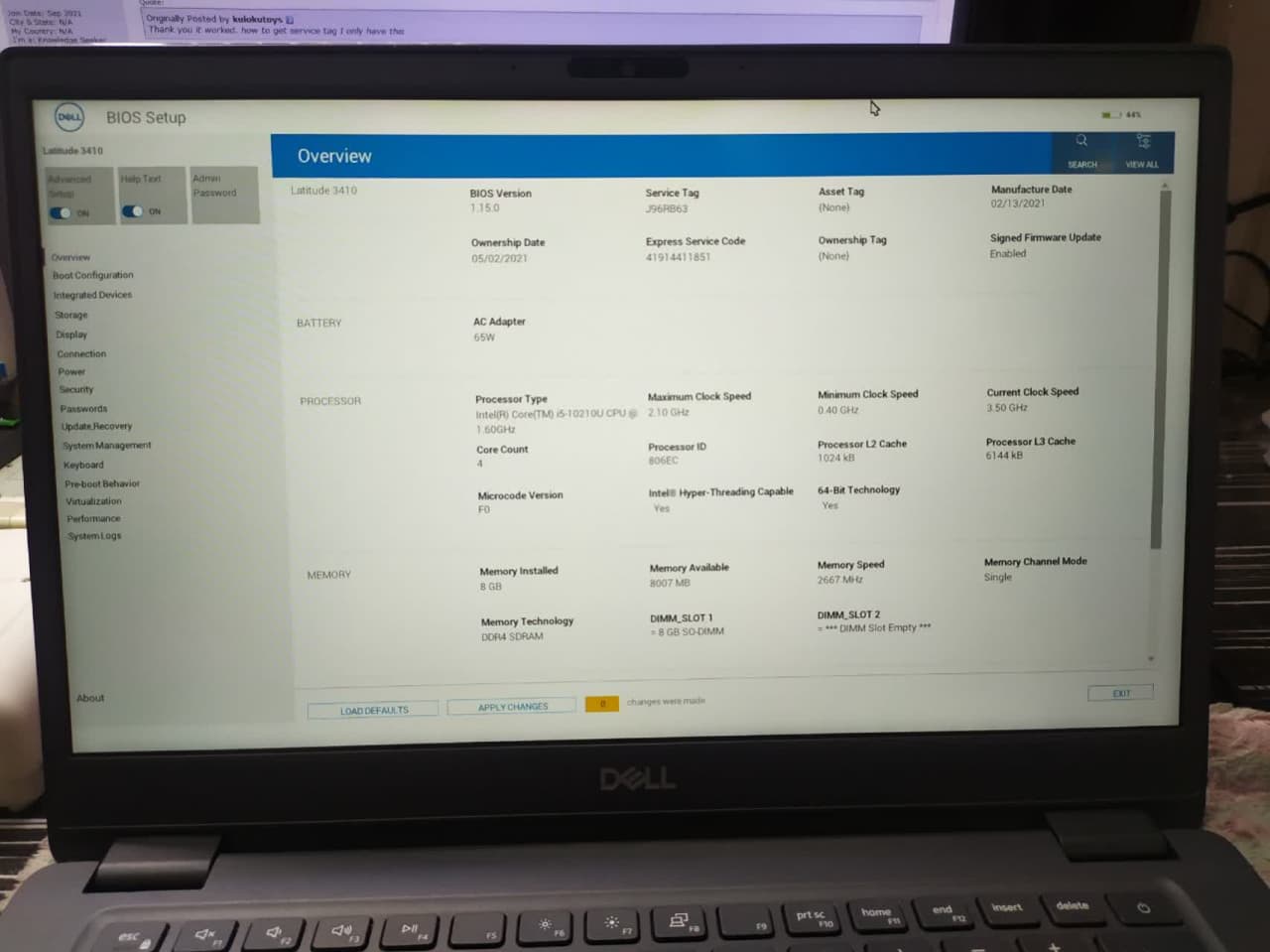

    Thank you it worked. how to get service tag I only have this
    • hardware1
      • Sep 2021
      • 2925
      • N/A
      #102
      Re: Please Dell Latitude 3410 with a admin password
      It's in the Picture: FCT6T93.
