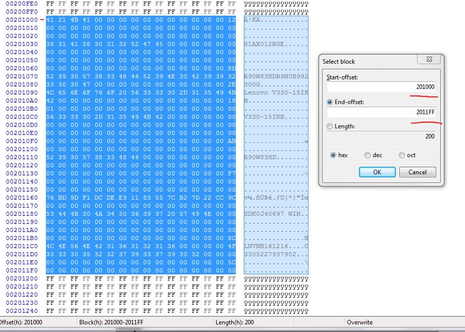

    Hello together,
    I friend of mine brought a Lenovo V330 to me with a BIOS password.
    I tried to flash a bios from this site, the password was then removed, but windows key and UUID etc. are gone.
    So could anybody please remove the password from the following dump?
    Thanks in advance.
    • 21444
    Re: Lenovo V330 Bios Password Removal

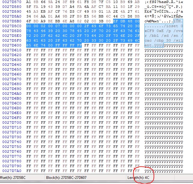

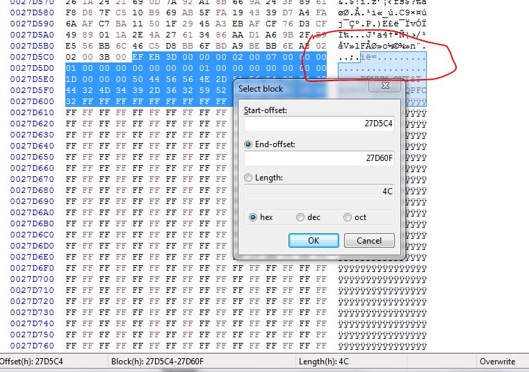

    Copy the DMI from your backup to the working bios. Its an Insyde bios,the DMI is usually in 1 big block,so its easy to copy,the only thing to watch out for with these lenovos is copying the win key, make sure to copy the ie= ,the dots and the whole key (Length 4C)
    HxD hex editor https://mh-nexus.de/en/downloads.php?product=HxD20
