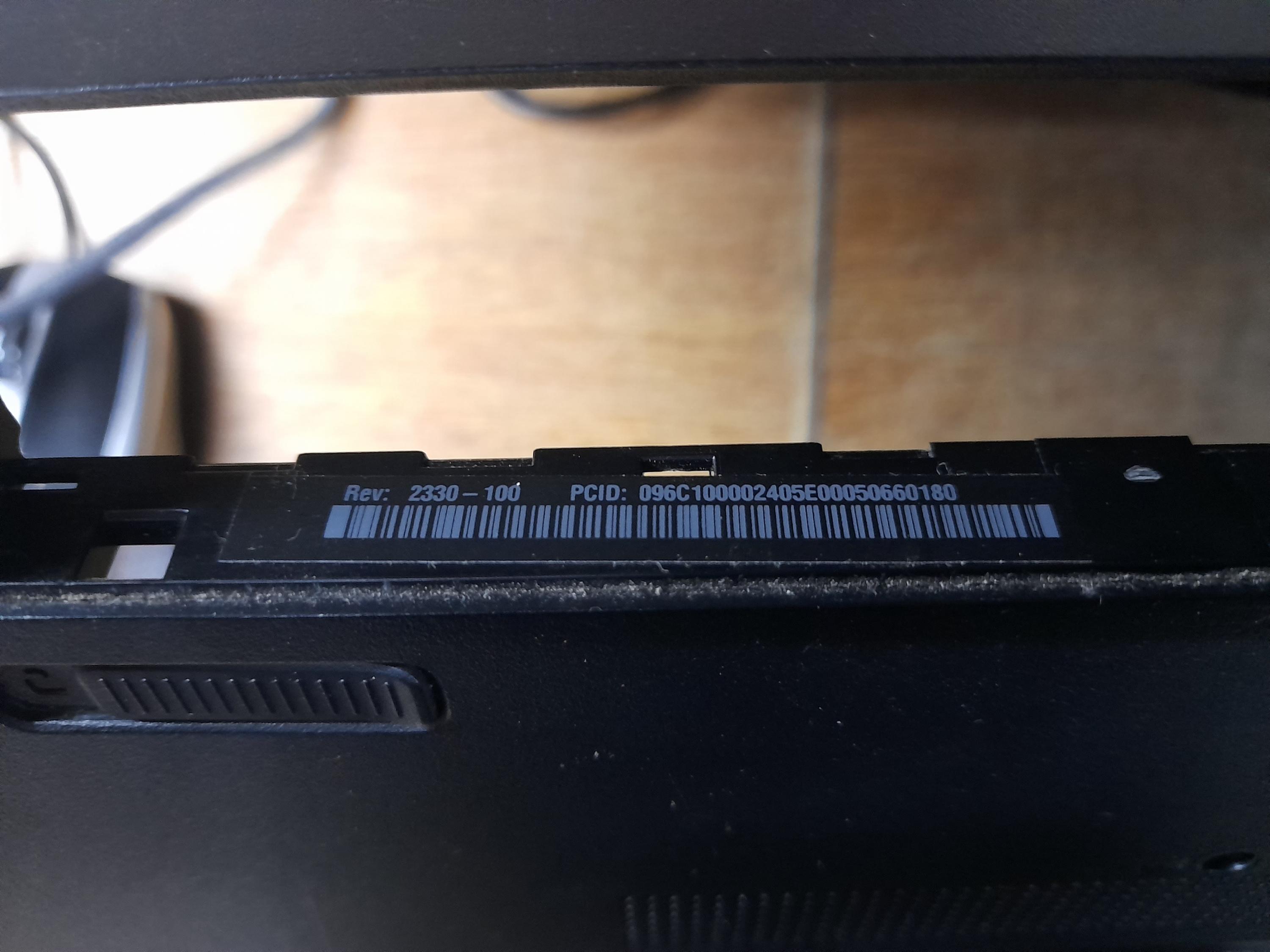

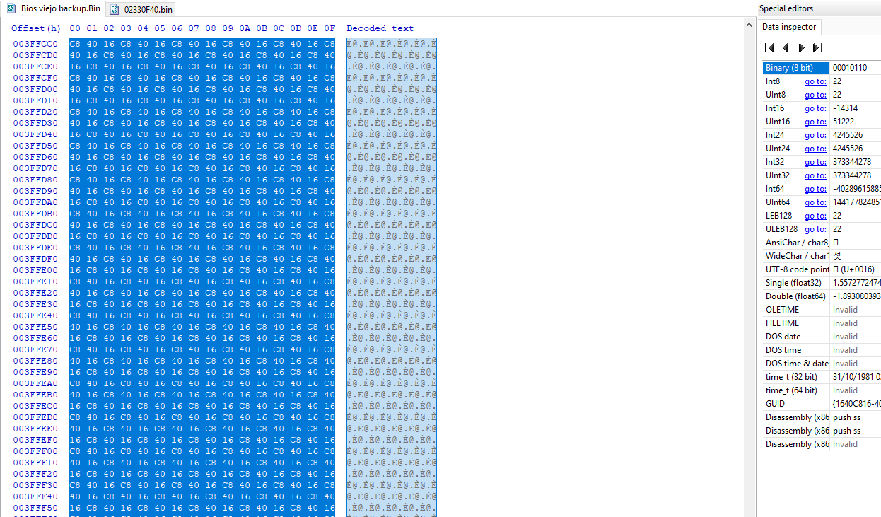

    hi folks, im looking for this bios
    Model hp 15 2330-100
    Motherboard: DA0U93MB6D2 REV D u93
    (allready tryed the one posted in another treat but doesn't work)
    backup here

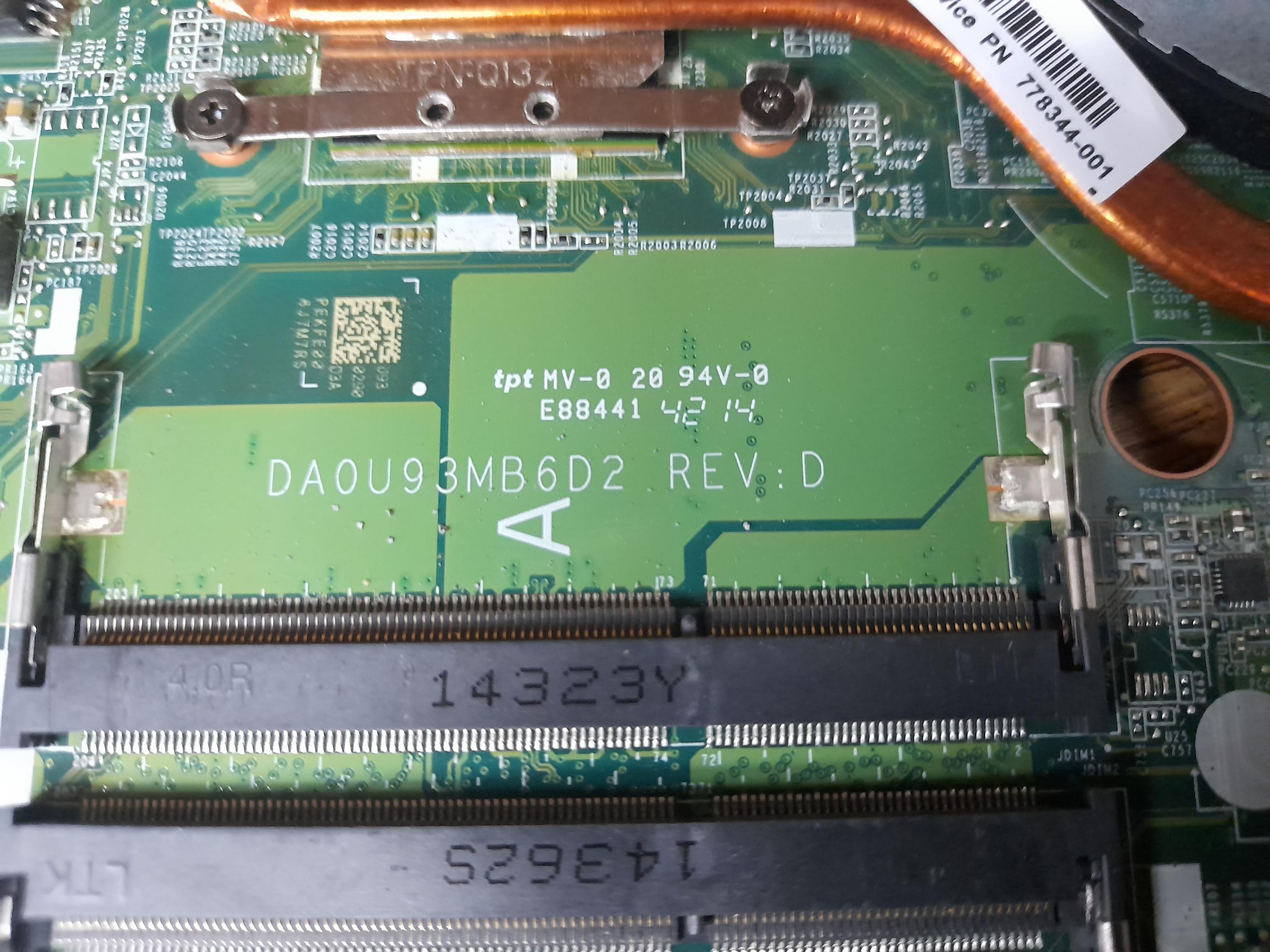

    2330-100 ? ,post the full laptop model number
    DAU93MB6D2 ? ,post the proper motherboard part number

      Re: hp 15 2330-100
      theres a pic

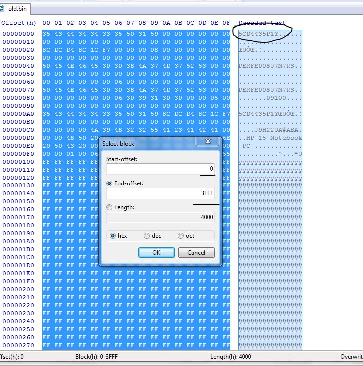

        • 21517
        Re: hp 15 2330-100
        Originally posted by el panke
        theres a pic
        If you open the bios with a hex editor you`ll see the serial number, 5CD4435P1Y
        Go to HP support,enter the serial number,download the bios update.https://support.hp.com/us-en/drivers...A&ssfFlag=true Run the exe,it will give you the option to save the bios to a location,the full bios will be decrypted and saved. Copy the DMI info from your backup to the virgin bios using the off-sets in the picture

          Re: hp 15 2330-100
          Hex editor https://mh-nexus.de/en/downloads.php?product=HxD20
          can u tell me what im doing wrong?

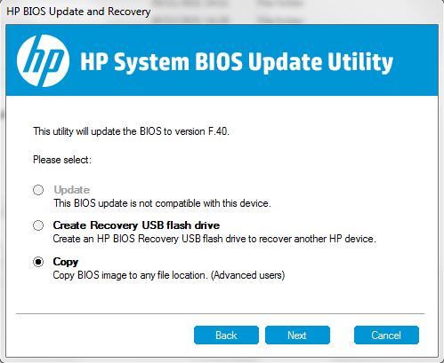

            Re: hp 15 15-f004dx DA0U93MB6D2 REV D
            this is the file extractd from hp bios update
              im confuse, the new file is 8mb, and the laptop bios backup its 4mb
                • 21517
                https://ftp.hp.com/pub/softpaq/sp870...00/sp87356.exe .Run the exe ,choose save,save it to the desktop .For some reason you downloaded the wrong bios,or you have a folder called swsetup already with a different bios in it.
                  ok, i got it now
                  but says access denied when i trayed to paste the block
                    can u check if it correct?
                    changed the file attribs and seems like its done

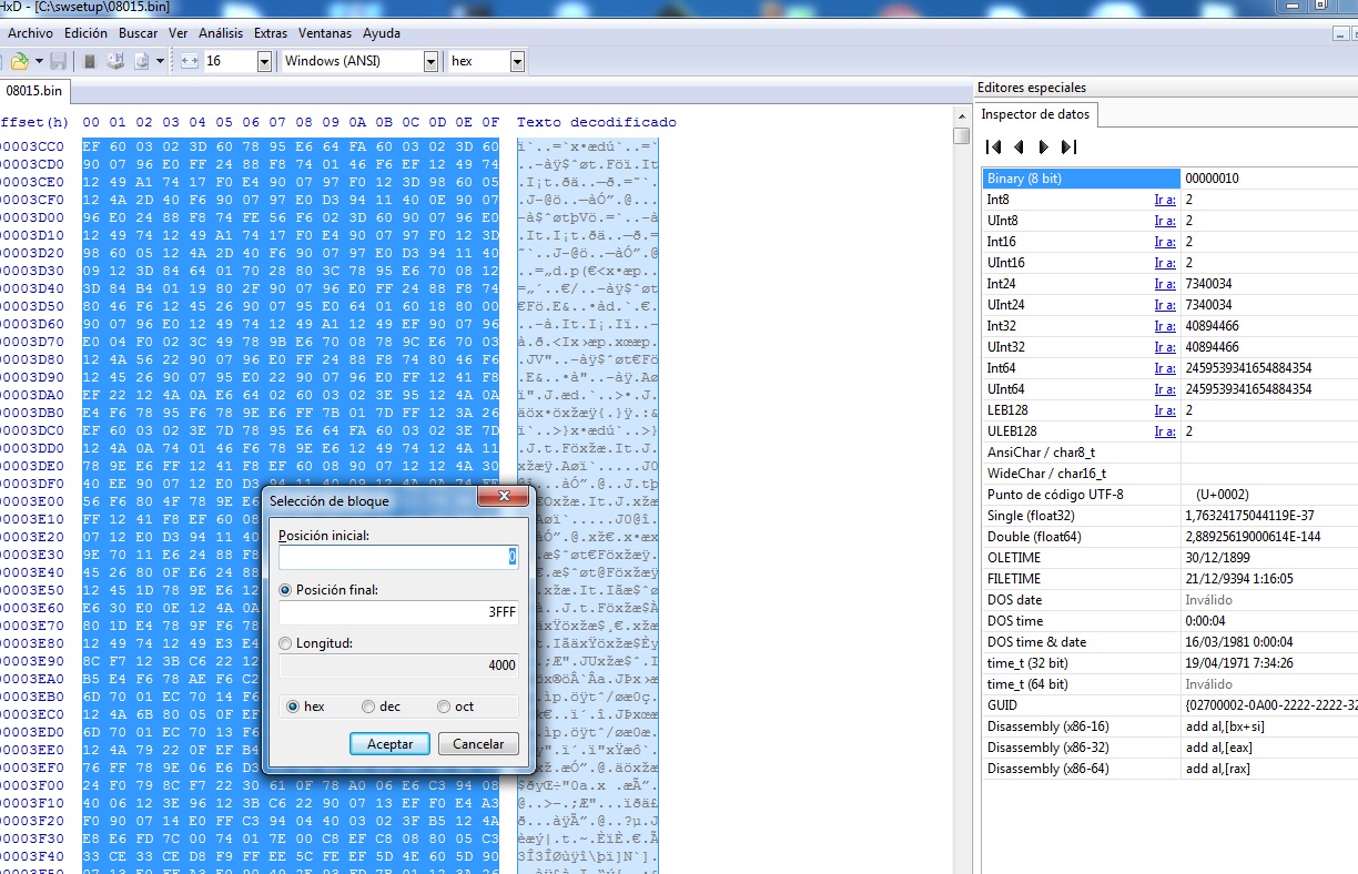

                        Hello guys im new in this and i have the same motherboard and i use the bios file in this post but doesnt work for me...
                        canyou please help me!
                          with hex editor my old bios copy look like this!!
                            Read it three times and use hex editor to compare with the analysis tab, two at a time. They should be identical. Post it here, I or someone will fix it.
