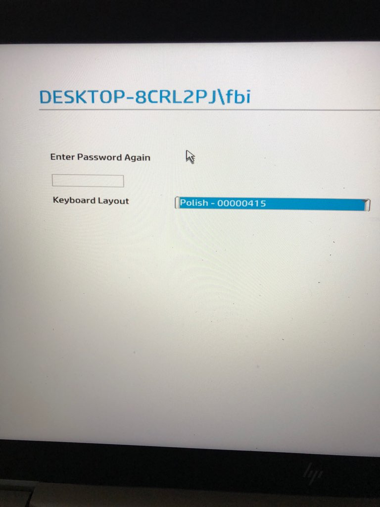

                            • irek40pl
                              • Mar 2023
                              • 3
                              • Polska
                              #34
                              Re: HP Elitebook 850 G6 BIOS UNLOCK
                              Niestty does not work, after uploading such screens appear, the unlocker does not work
