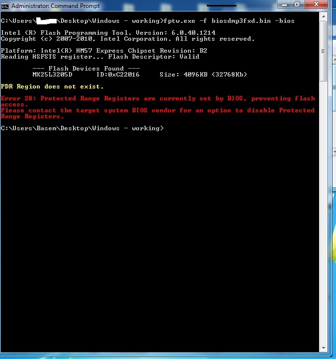

            While the descriptor is unloceked, I tried to flash the unlocked/fixed file to the “bios region” using Intel ME command >>> fptw.exe –f (filename).bin –bios
            It did not go through and, displayed the following message:
            “Error 28: Protected Range Registers are currently set by BIOS, preventing flash access. Please contact the target system BIOS vendor for an option to disable Protected Range Registers”. [Picture is attached for reference]

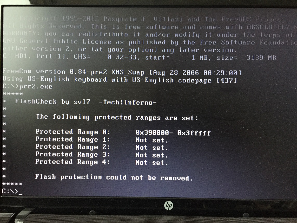

            After getting this negative outcome, I searched this forum and other forums about the possibility to overcome this issue. After a long and through searching I got to know that there's a tool called “prr2.exe” that can circumvent the protected range registers. Regrettably, it did not work! [Picture is attached showing failed output]
            This laptop is stone walling every possible way for flashing without using a programmer!
            Considering the above, I like to ask:
            1- Is there any other way to bypass bios flash protected range registers?
            2- If the answer to no.1 above is no, is there any way or method to figure out the admin password from the full bios dump?
            Looking forward for your feedback and advice.
