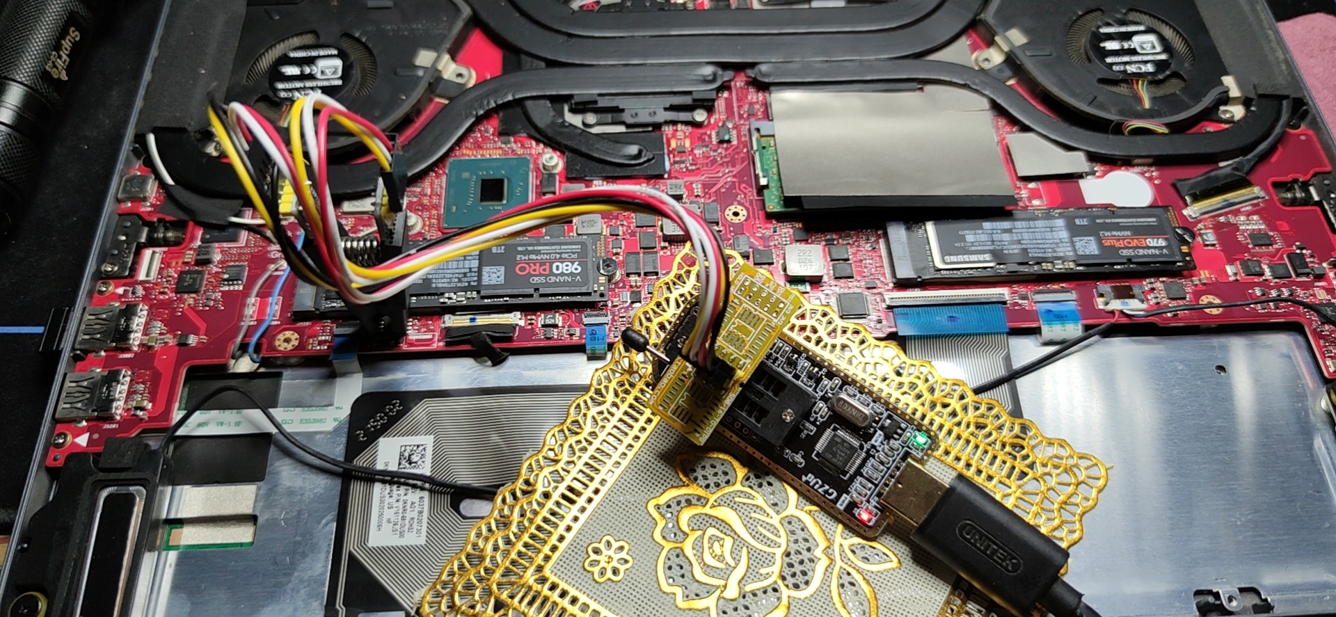

            Re: I need bios: asus GX550LXS
            this rar of bin file is read from the winband chip

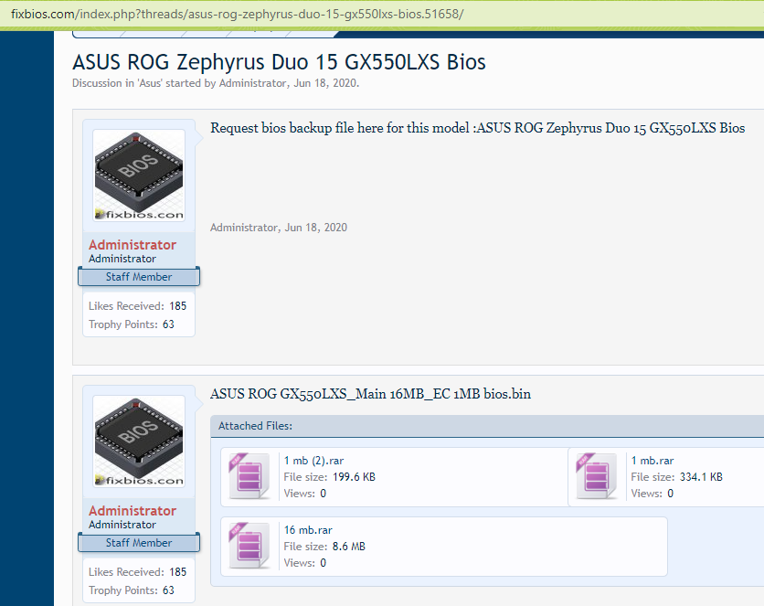

                    these files size very same to: https://************/index.php?threa...xs-bios.51658/

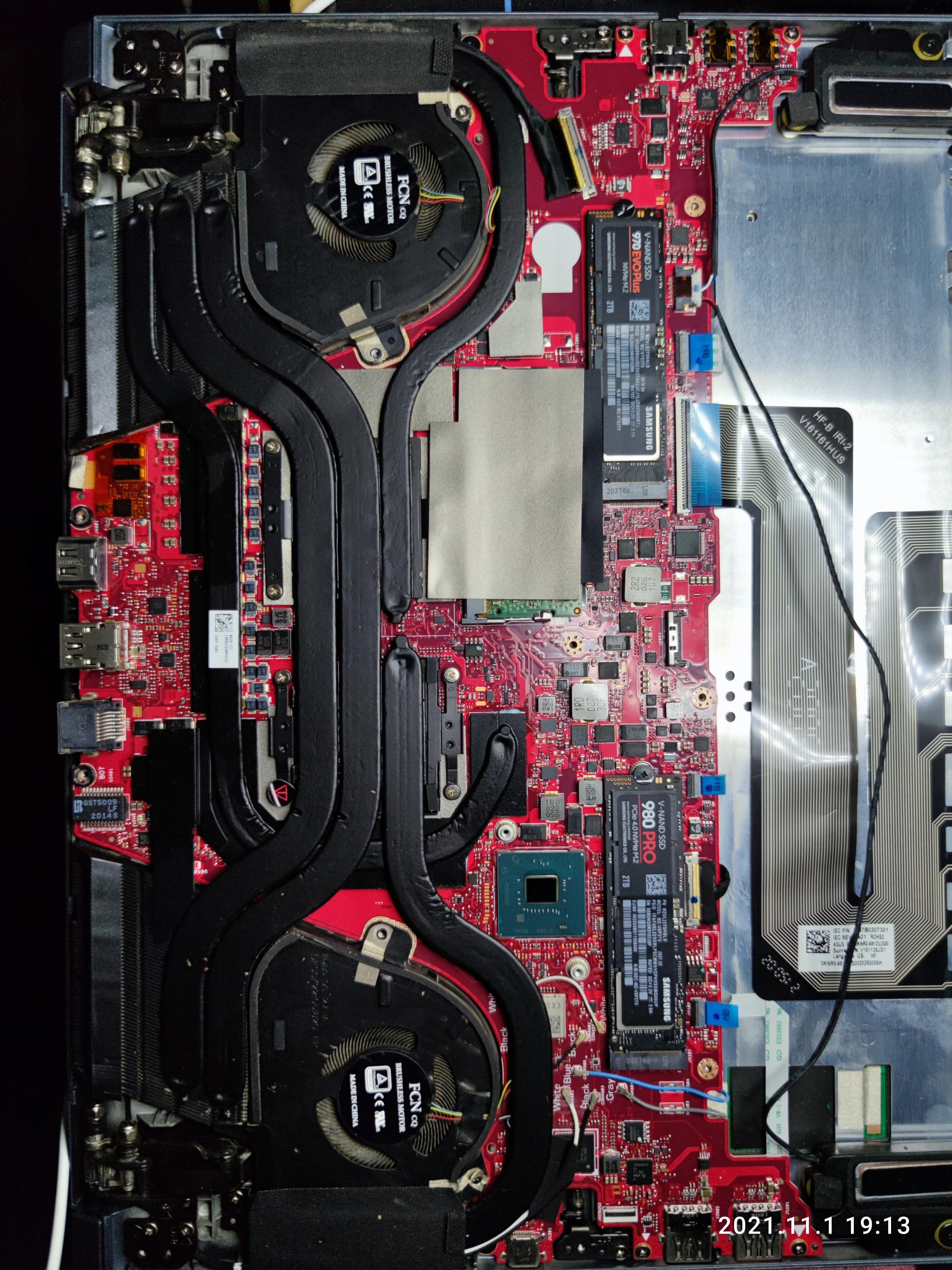

                          cant boot up, screen is black...

                            reflash it, still cant boot up.
                            auto power off after power on 3 seconds

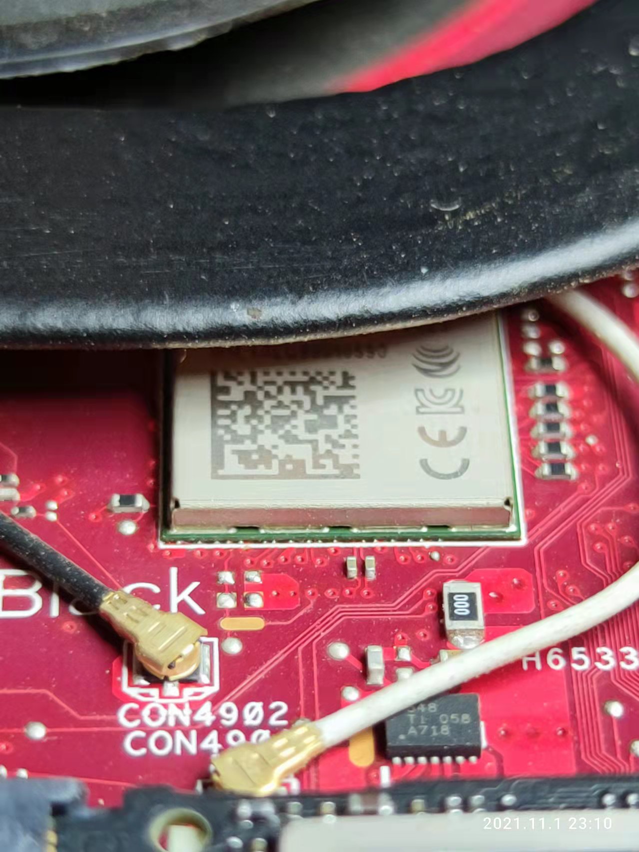

                              Do you have the motherboard out of the case and disconnected from everything ? .Can you post a picture of the small QR code sticker just above the LVDS screen connector,under the heatsink.Disconnect the main battery first before even touching the lvds cable

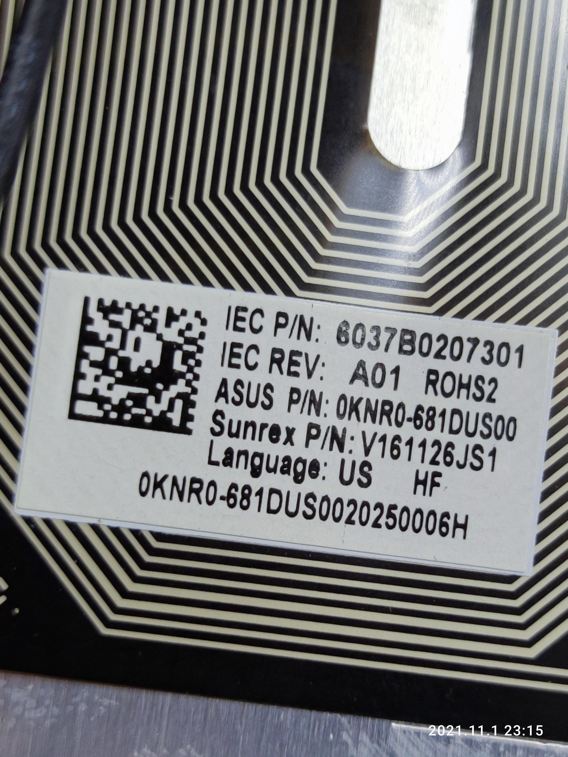

                                  this qr?
                                    • 22286
                                    Originally posted by opensoce
                                    this qr?
                                    No, it doesn`t matter, i thought it was a sticker flat on the board,not on top of the wifi card.
