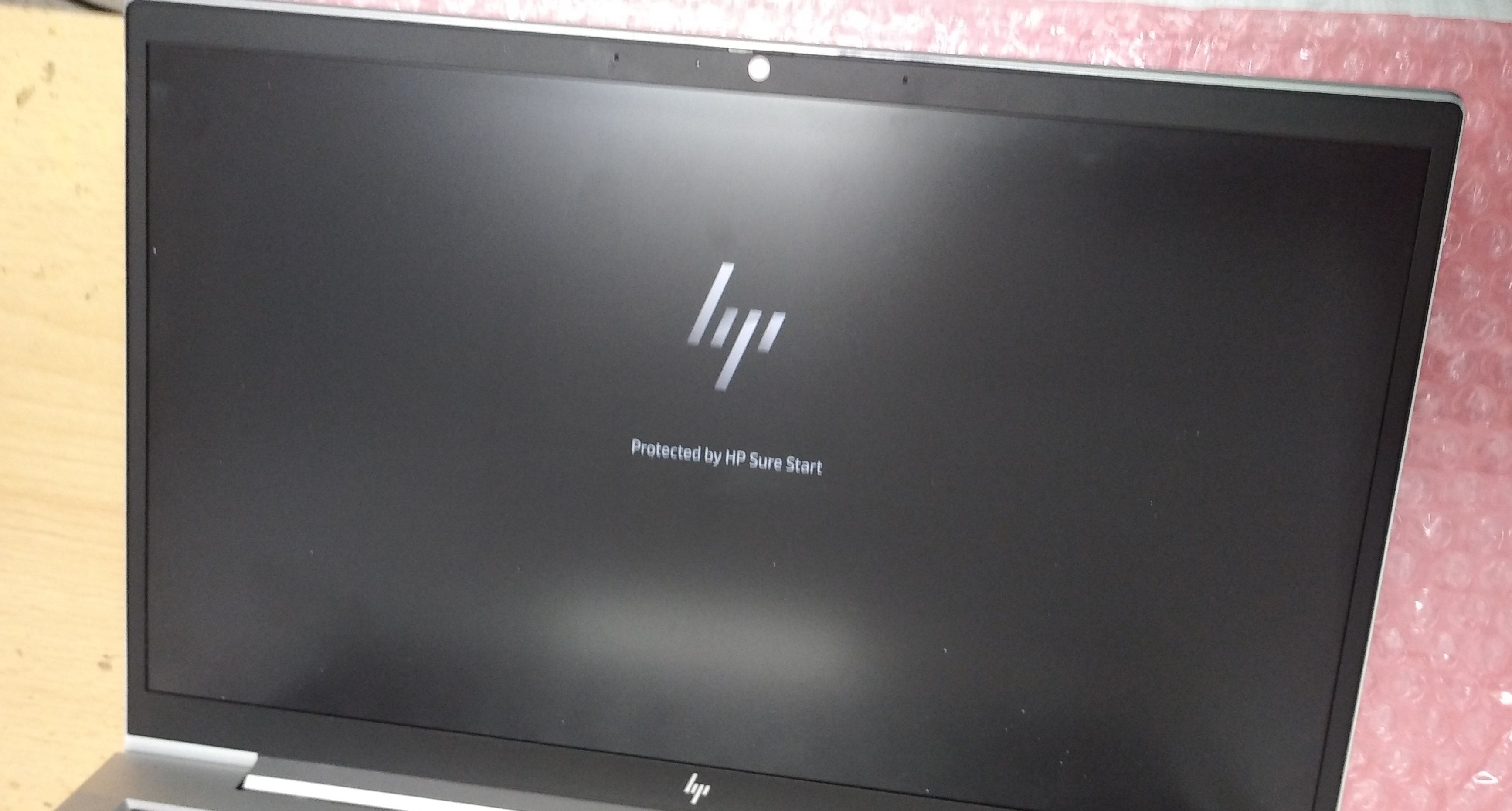

    Thank you verry much Hoaca388,
    But still remain the same issue, it starts until it shows HP Logo and Protected by HpSureStart and it reboot, when I try to enter Bios Setup it won't and it keep rebooting.
      Check hardware.

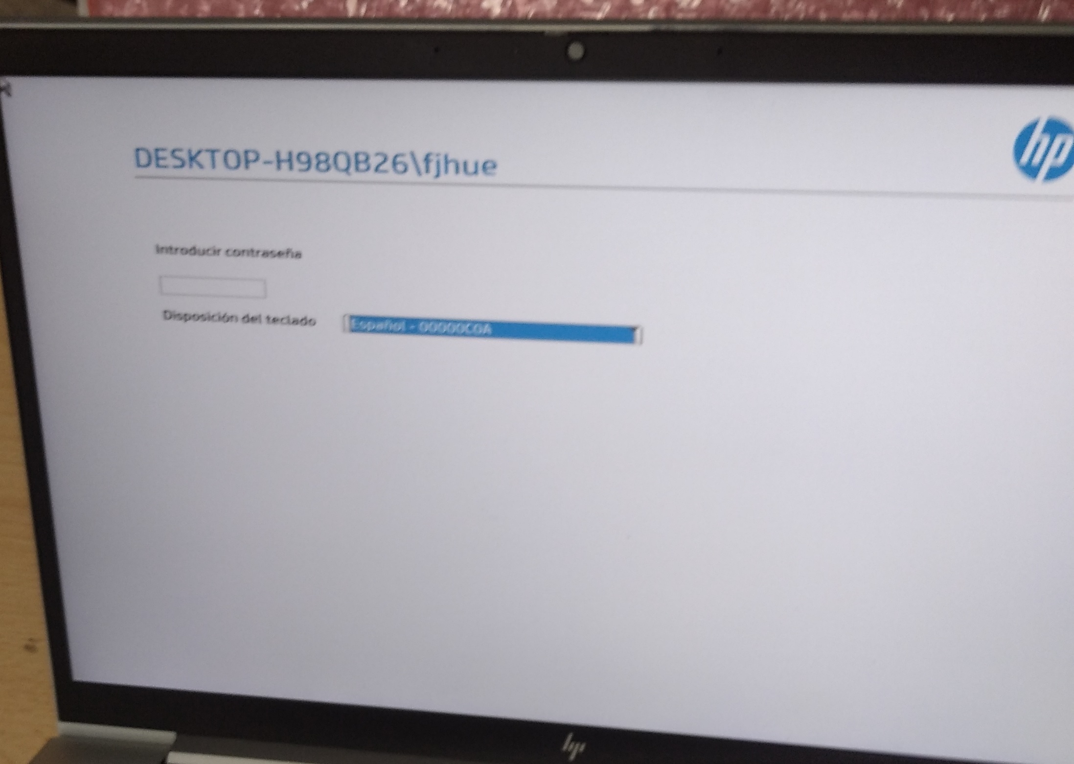

                              Please, I need to clear bios password
                              HP ELITEBOOK 840 G7
                              MB CAMELLIA-6050A3136201
                              S/N: 5CG10250M8
                              P/N: 1J5Y0EA
                              Thanks in avance

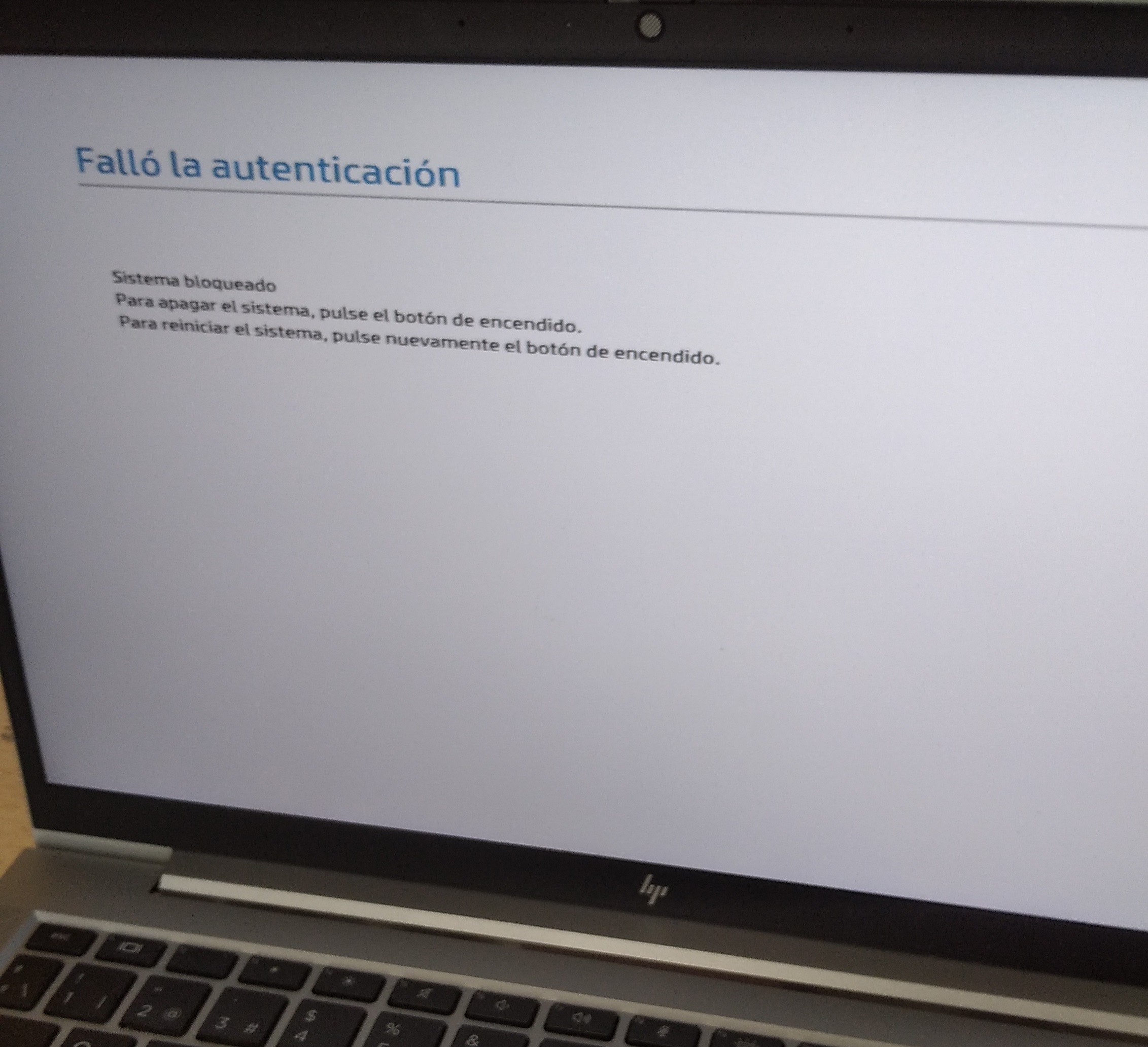

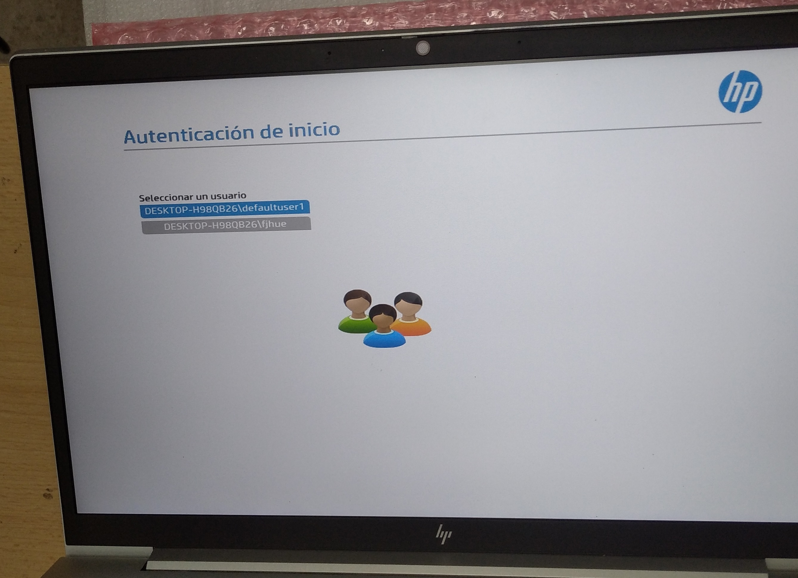

                                  #36
                                  Originally posted by shiyab
                                  hi try unlock file flash ec file 16 mb
                                  Thank you but it keeps asking for the password
                                  Please, can someone try again?
                                  Attached are pictures of the boot sequence. The number 4 image appears when trying different passwords.

                                      #38
                                      FLASH 16mb o
                                      Sorry, but 16MB_UNSS.ROM and W25Q128JV_ORIG_unlocked.BIN are identical.
                                      It keeps asking for the password
                                      Thanks anyway for your help
                                      Please, can someone help me?​
                                      • rex98
                                        • Feb 2023
                                        • 1293
                                        • Mandaue CEBU, Philippines
                                        #39
                                        do not touch the EC. Only flash this main.
                                        first boot press f10 apply factory defaults and restart, 2nd boot reset security settings to defaults and exit.
                                        use BCU. you can permanently disable Absolute lock in BCU.
                                        here's your DMI:
                                        Serial Number: 5CG10250M8
                                        Product #/SKU: 1J5Y0EA#ABE
                                        CT Number: PJSCQ00WBEPG8J
                                        Description: HP EliteBook 840 G7 Notebook
                                        BuildID: 20WWCMBT601#SABE#DABE
                                        Feature Byte: 3X476J6S6b7B7H7M7Q7W7m7saBaEapaqauawbUbhcAdUdpdqfAfPguhKhkjhk8mE.nA
                                        MAC Address : 3C:18:A0:C1:F6:32​

                                          #40
                                          here's your DMI:
                                          Thanks! It worked!
