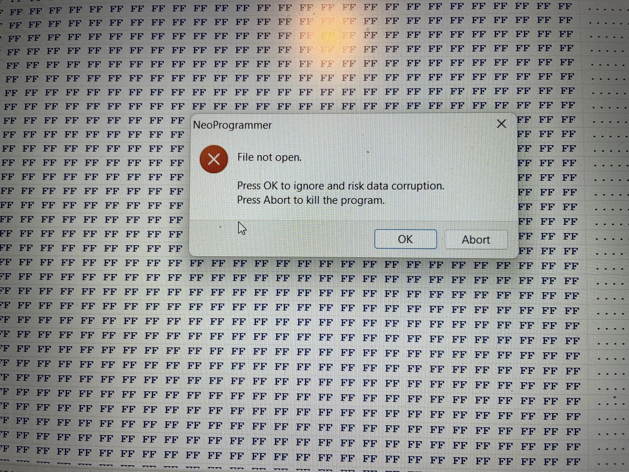

                          hp 1050 g1 bios needed
                          hello. can someone give me fully working bios for hp 1050 g1 DA0XW1MBAI1 REV1
                          16MB
                          AND
                          32MB PLEASE !!!!!!!!!!!!!!!!!!

                            Re: hp 1050 g1 bios needed
                            Post your corrupt bios file and serial number.
                              thats the 32 mb bios file .
                              serial number 5cd9418fth
                                HP EliteBook 1050 G1 Base Model Notebook PC
                                  Maybe you know why its show this kinda error ?

                                    Re: HP EliteBook 1050 G1
                                    So i sorted out everything. Bios is working . Many thanks . But there is small problem , its takes around 40 sec to turn on , both fans spins and black screen long time and after its show hp logo and then everything is ok
