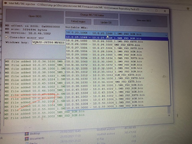

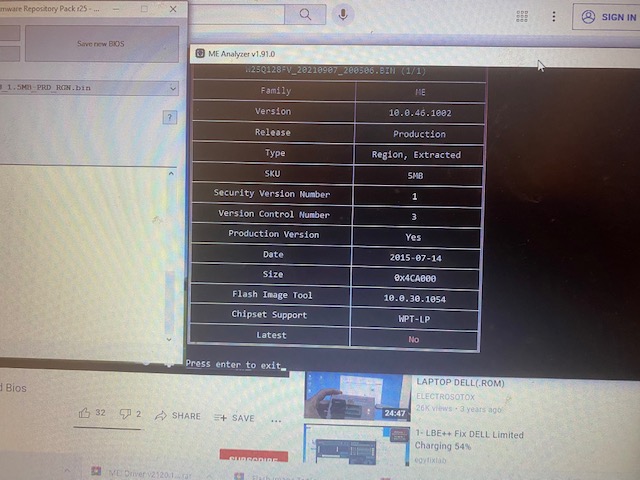

                  Re: lenovo t450 not starting can someone repair plese
                  hi guys i know this is bios request only, i am just trying to understand and sort out this file, me analyzer gives version 10.0.46.1002 i am using intel me / txe injector, i loads all the 10.0 firmware but when i click the button to select it (suitable mes) 10.0.46.1002 5mb is not on the list but the 10.0.46.1002 1.5mb is on the list , i have uploaded 2 pictures
                    • 21685
                    See post #6 it has the links to all the firmware and system tools. I wouldn`t use ME/inject for anything above version 6 FW, but each to their own.
                    Try this bios .

                      i will read again thanks, in regards to this bios laptop still the same stuck on to lenovo to interrupt normal startup press enter
