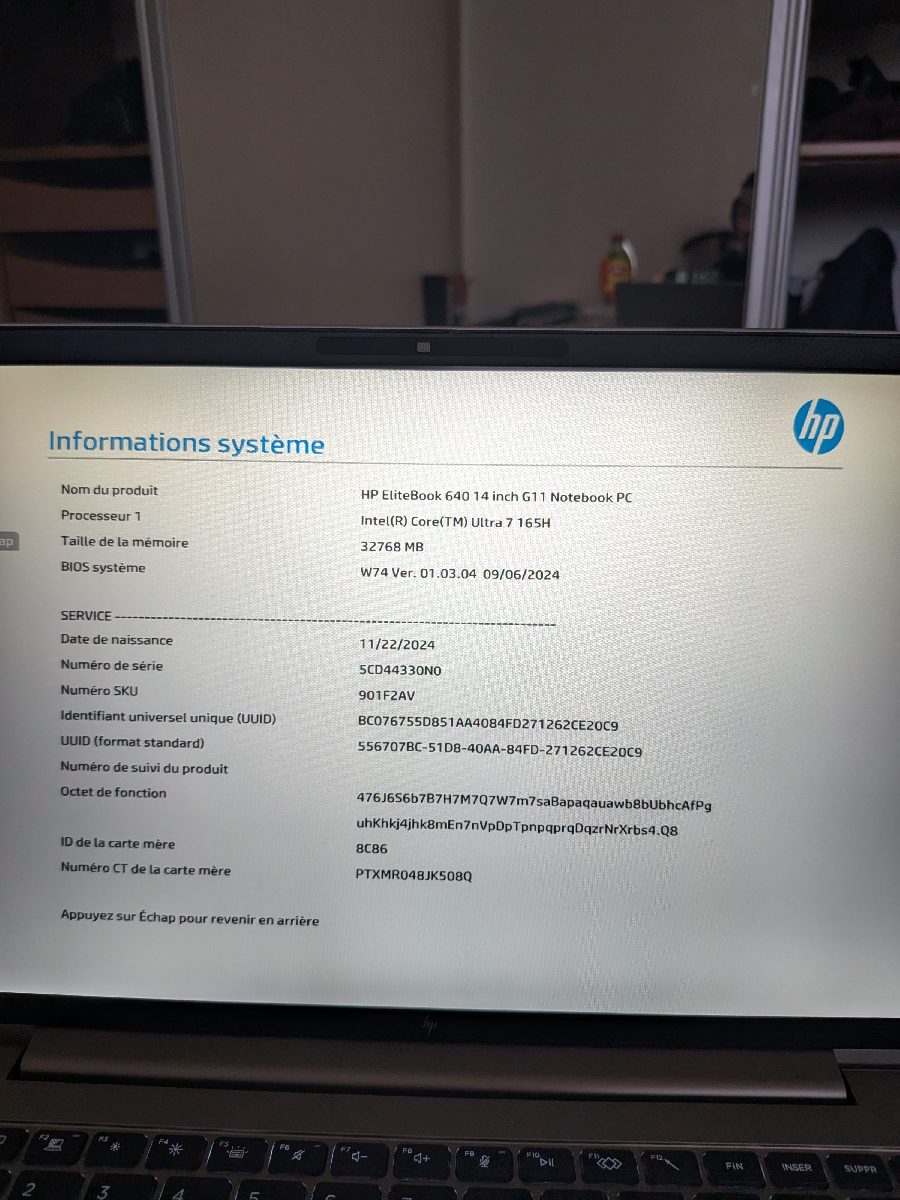

                    • Almiki
                      • Dec 2024
                      • 2
                      • France
                      #1151
                      Hi !
                      I'm sorry if I misunderstood the topic, I'm having trouble accessing my BIOS as it was passworded by my collegue who left and doesn't give me the password.
                      Could you help me please ?
                      Here's a file with all the data about my computer.
                      Thanks for your time
                      • peste
                        • Dec 2016
                        • 12652
                        • ROMANIA
                        #1152
                        Originally posted by Almiki
                        Hi !
                        post the original content of the bios chip
                        • Almiki
                          • Dec 2024
                          • 2
                          • France
                          #1153
                          Hi ! Peste
                          Actually I just have a password screen, when I miss the password 3 times it shows no code but just a message telling that I can shutdown or restart my computer.
                          I hope it's what you were asking, if it's not I'm sorry
                          • peste
                            • Dec 2016
                            • 12652
                            • ROMANIA
                            #1154
                            Hi ! Peste
                            you need an SPI programmer..here is a video as an example...https://www.youtube.com/watch?v=DWWigscuQDY
