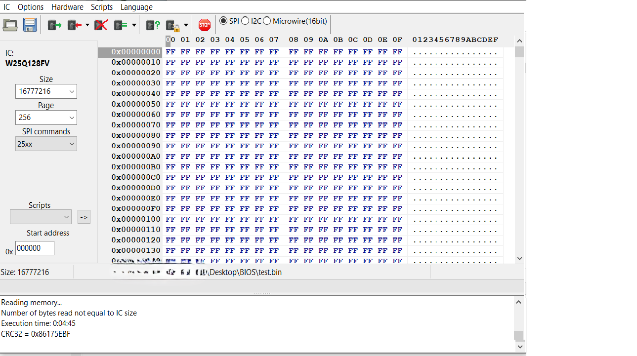

            HP Probook 650 G1 - Need to remove bIOS admin password.
            I'm a newbie and do not want to throw out the laptop as yet.
            Serial # CNU416D98Z Prod# G3C19US#ABA
            CH341 Mini programmer with ASProgrammer 2.0
            I've also tried the application that comes with CH341 and Neoprogrammer.
            Marking on IC: W25Q128FVSQ
            using miniprogrammer 25 series and clipped to the IC chip.
            Unable to grab a dump without crc errors and all FFFF's
            See my screenshot of the error and the programmer setup.
            What am I doing wrong?
            Looking for suggestions?
            -if I unsolder the chip - can it be tested in my mini programmer or do I need to buy more adapters?
            -do i unsolder the chip and buy a new one?
            -do I ask for a dump file and overwrite it on the chip?
            TIA.

            Is the chip type SOP8 (with legs) or WSON8 (no legs,flat on the motherboard) .What adapters did you get with the programmer,if any

              I have done many Probook 650 G1 before, it's best to desolder the IC.
              It should be possible to solder the IC on the PCB where your IC clip is connected to.
