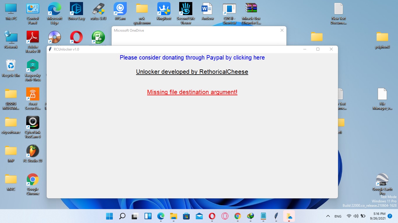

                    I am trying to use the tool and it is saying 'Missing File Destination Argument!'. I have a HP Zbook 14u G6. It has HP Surestart enabled as well.
                    What do I need to make us of this tool and remove the password from the bios?
                    This help would be greatly appreciated, thank you!
                      You need a BIOS dump obtained using an SPI programmer, then using that dump with this software. Read my comments from this page (#4) and from the previous page (#3)

                                its dosnt work. show me this message :Missing file destination argument

                                  Well, did you read what you quoted? The usage part to be exact.
