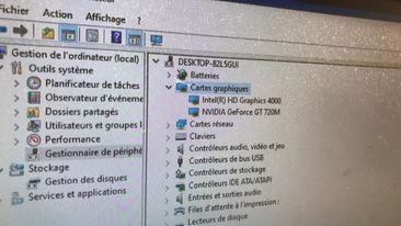

    NEED BIOS X450CC REV2.1 NVIDIA 720M
    My original is corrupted, no display
    work with another file but card graphics nvidia error 43 on windows

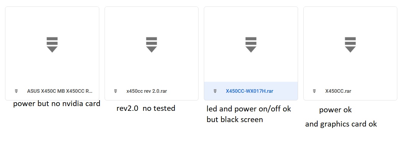

    You can try this my friend, to see if it's OK with the 720m.
    Hope it will do the job.

    • Maxpower3
      Bad Veteran
      • Feb 2018
      • 1321
      • France
      Re: Need bios x450cc rev 2.1 nvidia 720m
      not work
      power buton ok led green
      no consumption 0.02a (same with original)
      test 2 times

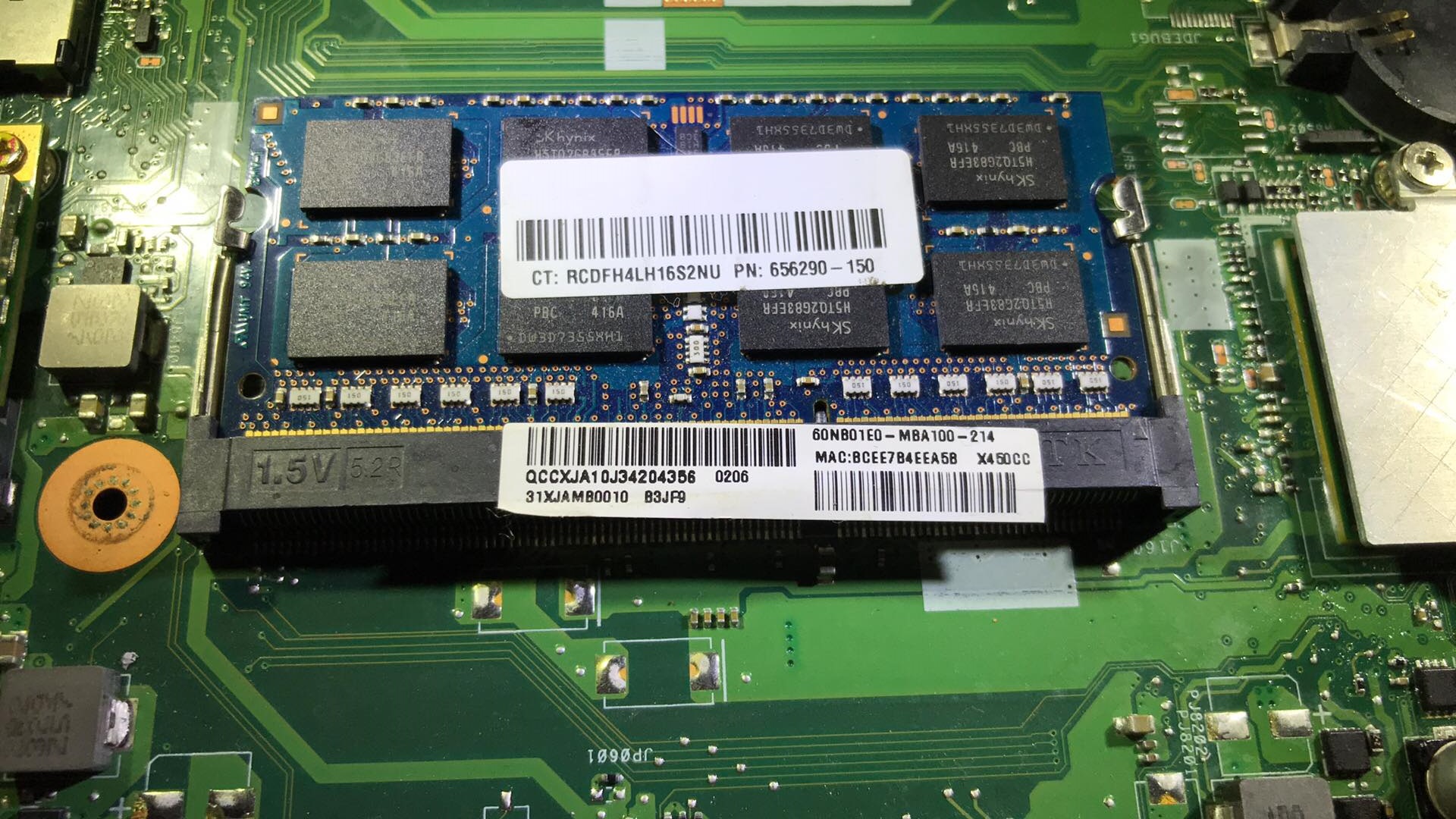

        Can you post a clear picture of the white sticker on the ram slot .
          thanks,I think it's good
          edit @vesko356
          thanks for Mp
          look picture
          you think need to clean ?
          not neccessary may be ,fast boot

            • 21678
            Try this one .
              Try this one .
              ok i try
              you put windows key and good serial thanks
                edit @vesko356
                thanks for Mp
                look picture
                No, no need to clean ME on the working one (the fourth - X450CC.rar), it's a engineering (F1) bios so should be good as is, and as the 720m is working too it's fine.

                • Maxpower3
                  Bad Veteran
                  • Feb 2018
                  • 1321
                  • France
                  Try this one .
                  Lcd bios ok but Black screen on bios with HDMI
                  Works only after on windows
                  Graphics card it's ok on windows with your file
                  With file of @vesko HDMI and LCD it's OK on BIOS and graphics cards too on Windows
