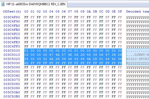

    halOoh guys, good day...^_~ anyone who got a working bios bin for this
    HP 11-ak0035nr DA0Y0QMB6C1 REV_C
    tnx in advance.......^_~
    i also attached back up bios to anyone who can help me clean....^_~

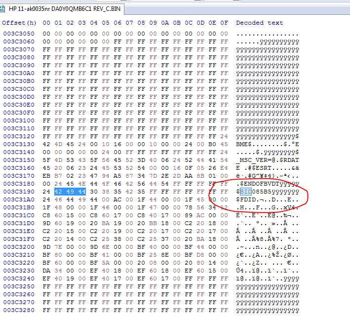

    Open your backup with a hex editor and search for the word BID, you`ll see that your BID is 085B5 .HxD Hex Editor - https://mh-nexus.de/en/hxd/

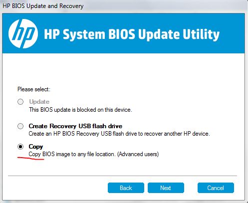

    Download the bios from the support page, https://ftp.hp.com/pub/softpaq/sp108...0/sp108755.exe
    Run the exe and choose copy,it will decrypt 2 bios to a location you choose (your desktop for example).

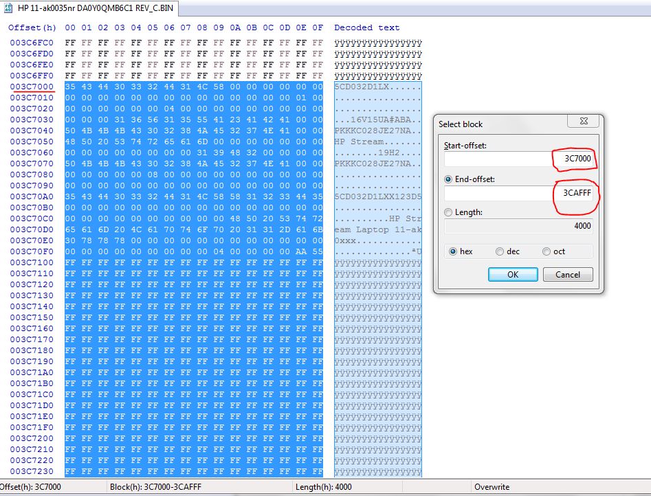

    Now you need to copy your DMI (serial etc) from your backup to the virgin bios using your hex editor.Select the start and end offset from 3C7000 - 3CAFFF .Copy that into the new 085B5 bios using the same block range.
    Next,select the block from 3C5000 - 3C503F ,thats the win key,and copy it into the same block range in the 085B5 bios ,and select SAVE.
    Now you have a virgin bios with all your DMI intact.
