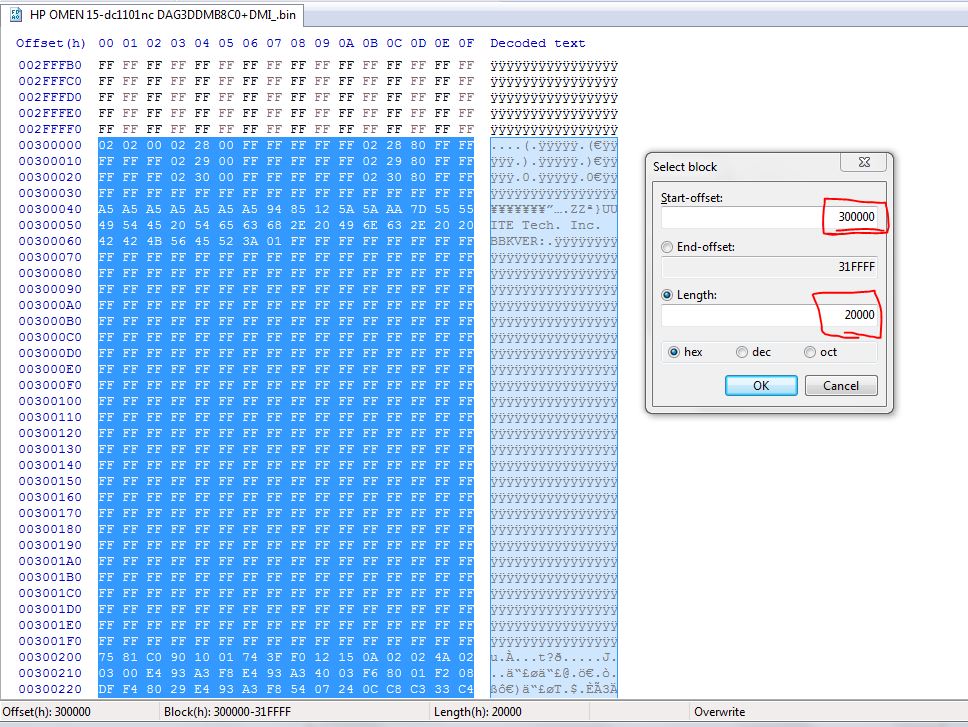

    Guys im in need for BIOS HP OMEN 15-dc1101nc DAG3DDMB8C0

      have 3long and 2 short blinks on capslock/memory problem/, but i want try to flash bios first
        • 21182
        Re: Need BIOS HP OMEN 15-dc1101nc DAG3DDMB8C0
        Download the bios https://ftp.hp.com/pub/softpaq/sp113...0/sp113709.exe
        Run the exe and choose the copy option,theres only one bios in the update (BID08574). Copy the DMI from the backup to the new one, job done.
        D 340000 - 3410FF
        W A9E000 - A9E03F
          Here You Go
          BIOS+DMI

            thx guys. can u provide me with EC bios dump?
              • 21182
              What part number is the ITE chip, need to check if its 128kb or 256kb
                • 21182
                Here. 128kb EC .
                  sry for late answer. ITE is IT8987E
                    but i have 1024kb EC BIOS IC
                      Do you mean the IT8987E has an external SPI chip ,and its 1Mb (not programmed through KB connector) .Whats the part number on the chip ,if there is one. Post the backup
                        here
                          • 21182
                          here
                          It isn`t the EC FW,its for something else, don`t know what as there`s no readable plain text in it.Maybe thunderbolt FW.
