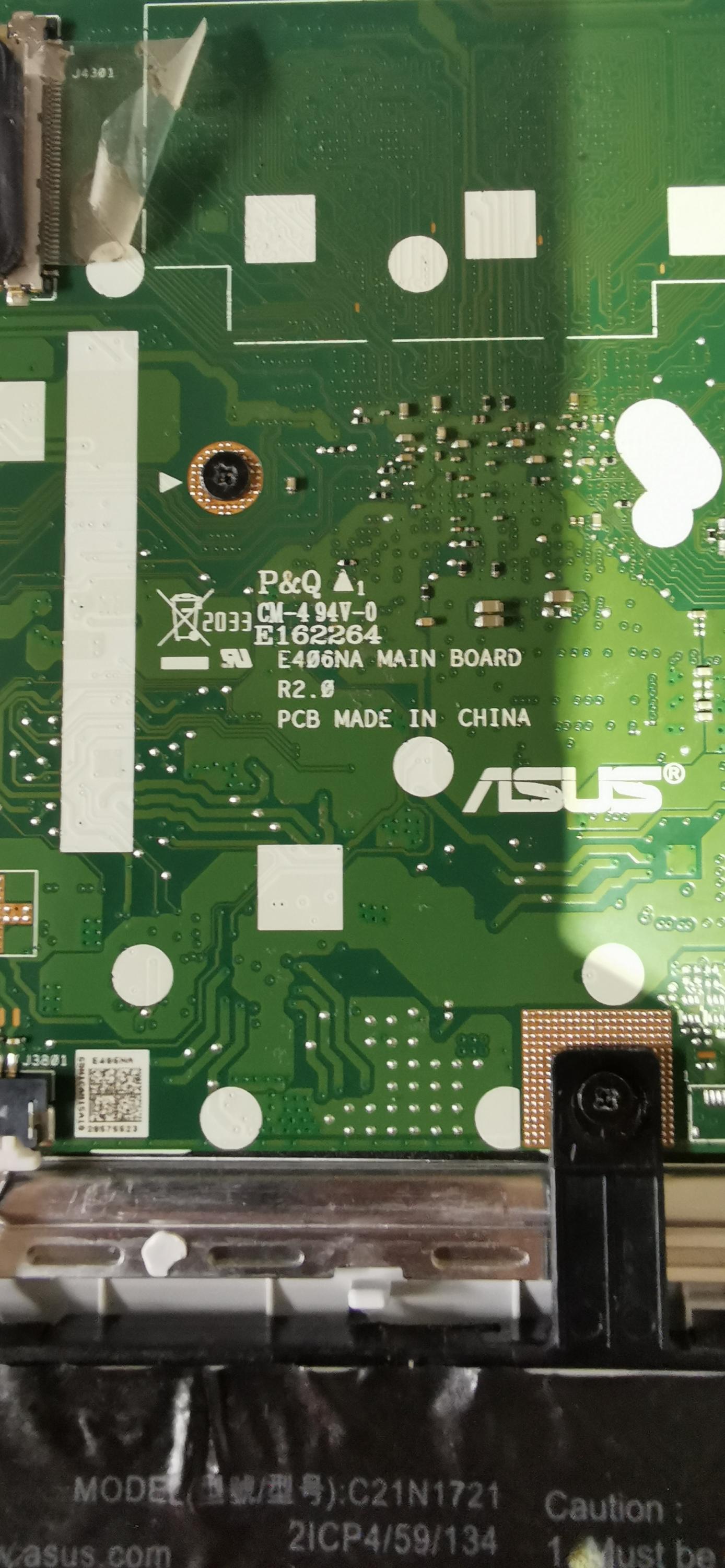

            Originally posted by acshud
            sorry.my motherboard it's e406na but i registred product on asus web site and after serial number it asus e406sa.my web cam not work and not detectid by sistem
            post clear pictures with white or green stickers on the motherboard.
            • acshud
              • Sep 2017
              • 106
              • romania
              Re: asus e406n
              this is.i look in bios dump and it's e406na version 302.strange is after register on web asus site show e406sa.bios dumb it's so corrupt i can't extract region.
              • peste
                • Dec 2016
                • 12959
                • ROMANIA
                Re: asus e406n
                I need pictures of the paper stickers stuck on the motherboard, not the ones printed with white paint.
                • acshud
                  • Sep 2017
                  • 106
                  • romania
                  Re: asus e406n
                  don't have one.it's a QR code on the board.i read and this i get.LC51NBCV00DVK5MB,E406NA,60NB0T20-MB6001,200
                  • peste
                    • Dec 2016
                    • 12959
                    • ROMANIA
                    Re: asus e406n
                    the bios from post # 2 should be ok for your laptop
                    • acshud
                      • Sep 2017
                      • 106
                      • romania
                      Re: asus e406n
                      thx.have a nice day
