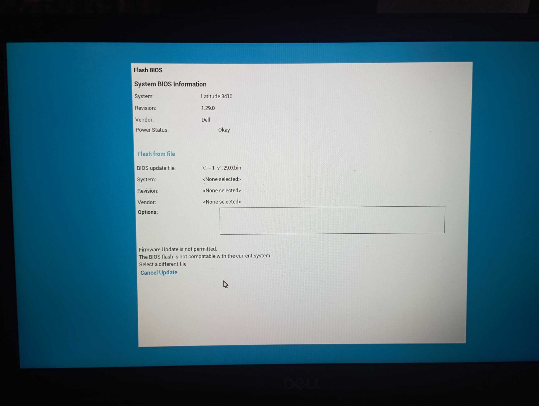

                thank you, which tool should I use to flash this bin files? I tried with a bootable stick and from the bios update device option and it doesn't work.

                  Oh dont flash any bin I though you have take the board out and use a spi bios programmer,

                    no, i don't have a programmer

                      can it be solved without a programmer?
                        Impossible.
                        You can refer to model CH341A (this is the cheapest model). Learn how to use it via Youtube.​
