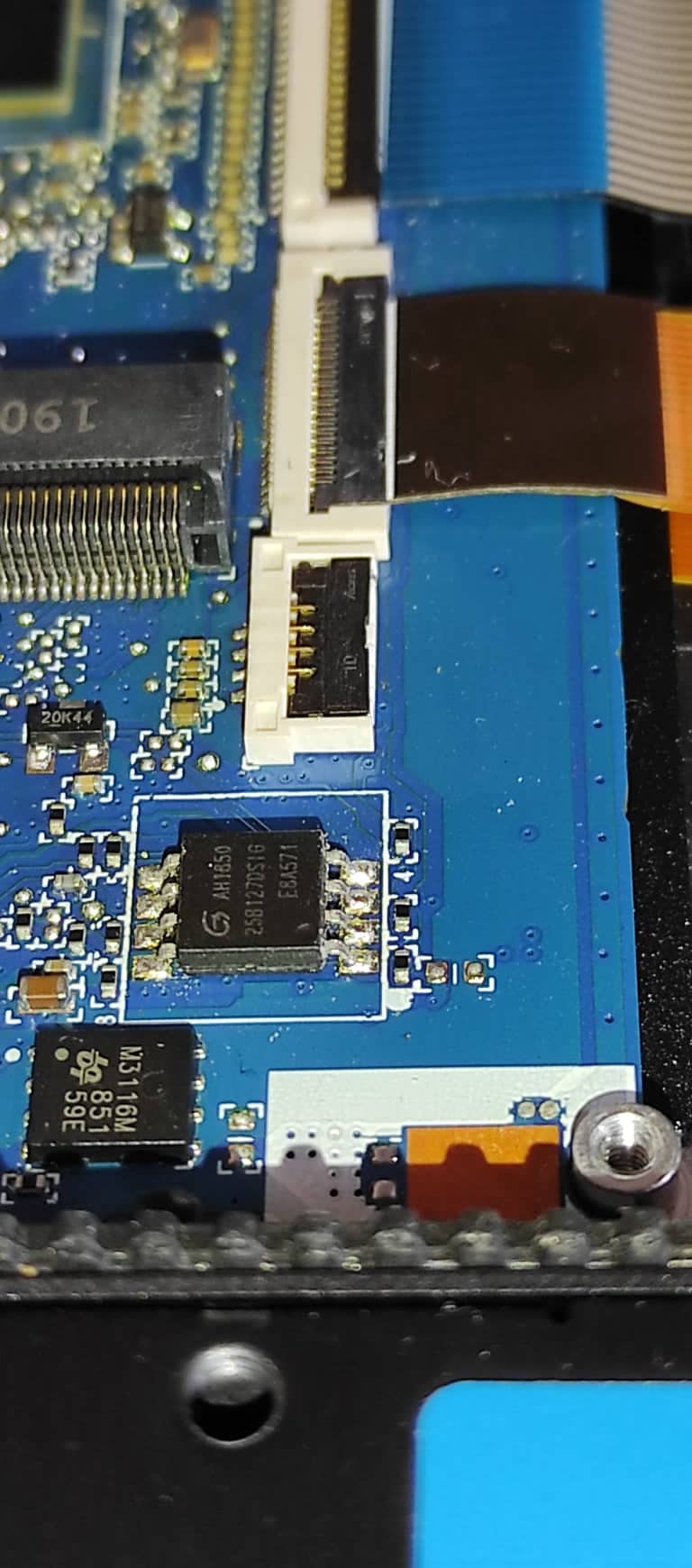

      thanks but i saw that i have 2 chips one has a 1 mega file and one 16 mb so what to flash primary or secondary? and how it need to be done one to be erased and one flashed or how? and how to write this dmi and keywin?
      • peste
        • Dec 2016
        • 13809
        • ROMANIA
        Re: HP OMEN 15-dc0001ng no post
        change only the content of the 16MB bios chip, the 1MB one remains the same..use the HxD program, enter the contents of the original 16 Mb chip and the update sent in it, and copy those intervals from the original bios in the update .. (copy-paste). ..

                well i come home i reflashed bios with the new bin file with dmi nothing 3 long blips 2 short on the caps lock ...maybe it`s somethink else i`m missing? in programer it shows 3 types of detected chips on main bios and 2 on second is any diference? because the main bios i flashed with the first option

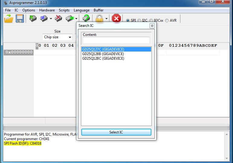

                    Nope still 3 blinks long 2 short I flashed 2 times with each program...am I stupid or the motherboard has a short somewhere.... I will buy a multimeter and learn to use that again or maybe the bin file should be decompiled and recompiled with image flash tool I just thaught of that until I waited for nothing to flash ��
                      • 22176
                      Some of the black PCB version CH341A programmers output 5V instead of 3.3 ,there`s a mod you can do by soldering a piece of wire - https://www.chucknemeth.com/usb-devi.../3v-ch341a-mod
                      You can choose GD25Q128 as the chip manually (use ASProgrammer or NeoProgrammer).Plug the charger into power jack if you`re using a clip,then select the chip,then choose blank,then program the bios by gayyum786 ,you don`t need to mess with FIT or the ME, the bios is AOK.
                      If its still the same after that then try different ram or clean the gold fingers with a pencil eraser if they`re tarnished.

                          the chip is 127 not 128 on the forum it says to flash the same type of chip so....127c but is the same as with 128 if i select and flash no diference whatsoevere

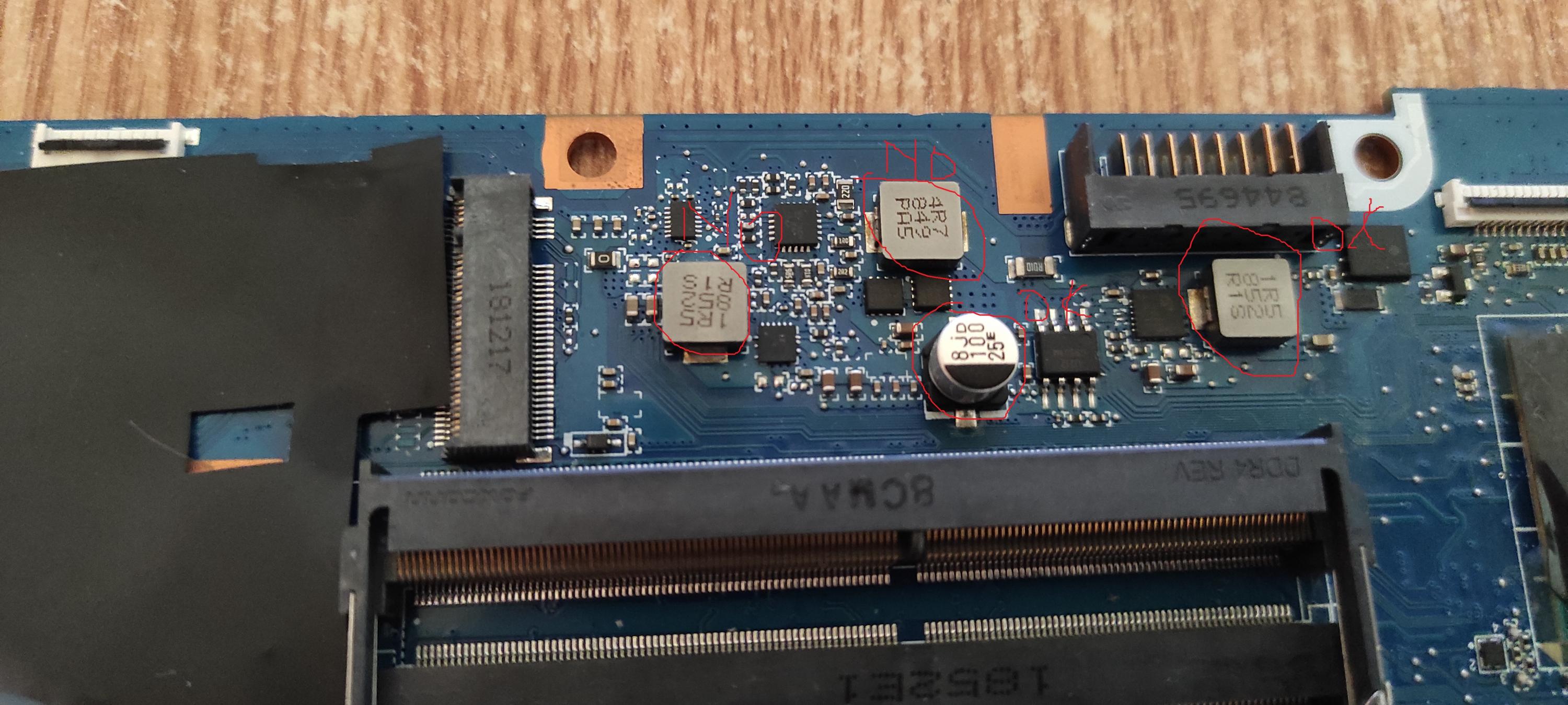

                            i measured the ch341a i have 5v , i took a measure on the motherboard and i have 2 coils that are short i will atach photo

                              This part of the forum is the bios requests.Modify your CH341A first and program the bios,if its not working ok after that and you want more help start a new thread in the main laptop forum - https://www.badcaps.net/forum/forumdisplay.php?f=23

                                      You already have a virgin bios,can`t get better than that.The problem now is not with the bios,its something else .
                                      Quote:
                                      btw when i put the ram on the bottom bank i get the same caps lock but when i moved it to bank up it doesn`t blink but it do not post neither.....
                                      Try pressing down slightly on the ram socket.Check all the pins are soldered properly.

                                        maybe is not a bios issue look here https://www.youtube.com/watch?v=rC94OihRjMk i need to get to a shop to get look at this if it`s true or not
