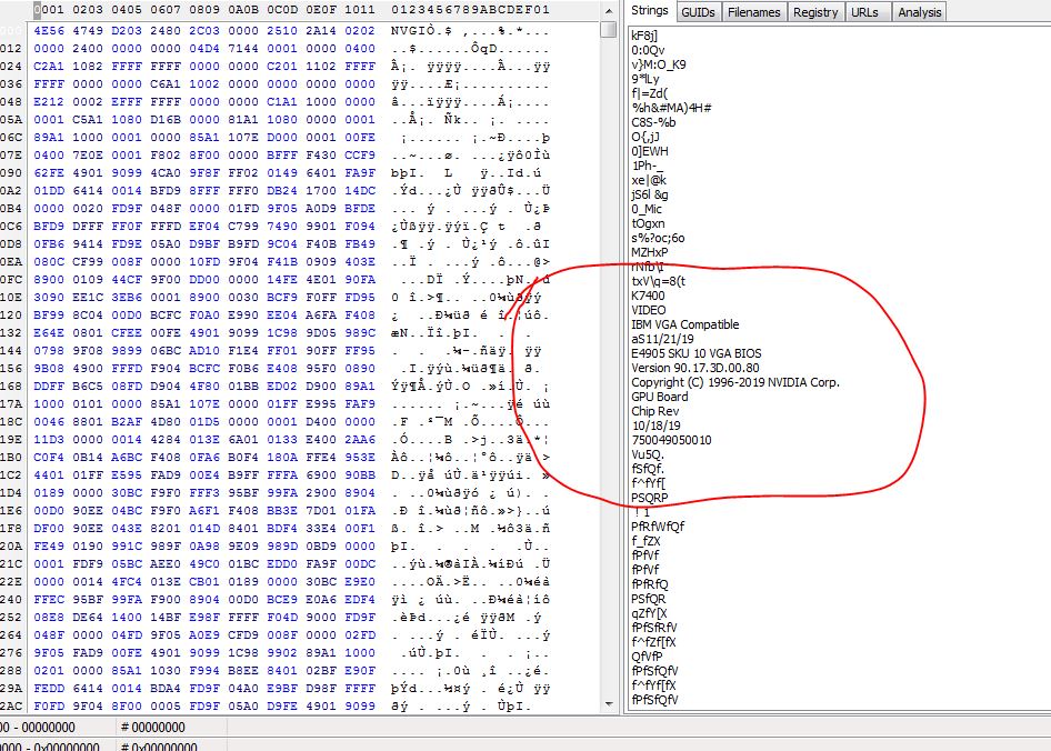

              got same unit with no display problem but my EC file is at 1mb. i attached my backup. thanks.
                Its the VGA bios youve posted. It might help others anyway

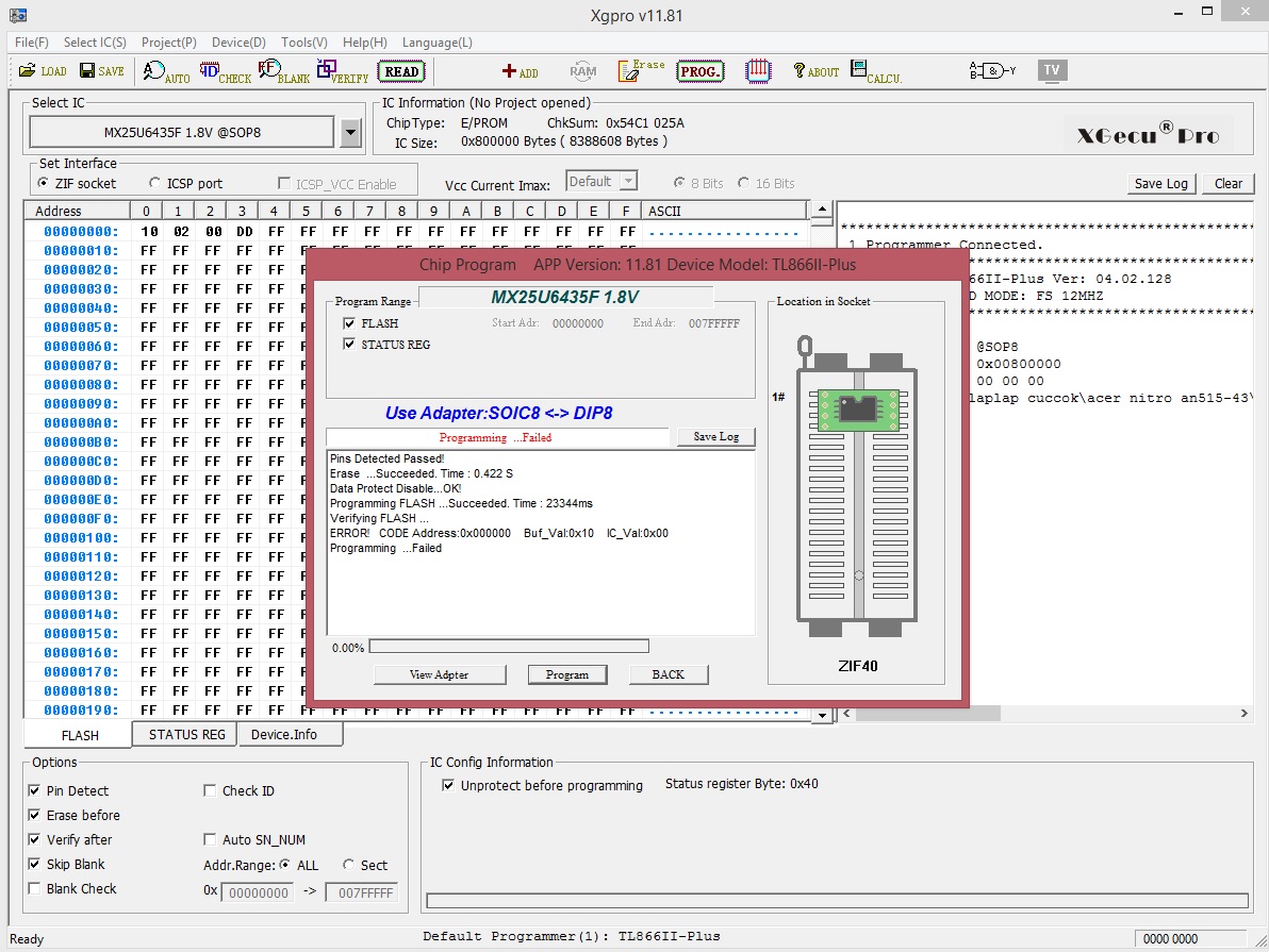

                          Hi, I have a FH50Q LA-J621P Rev 1.0 motherboard.
                          When I turn on the laptop, looks fine , but no picture at all. I downloaded the bios bin and write in the bios chip(25lb64csig) but after I turn on only once give me the "ACER" logo but nothing else.

                              When I first read the chip, it was empty. I using a TL866II plus programmer, and xgpro program. I attached a BIOS, what I used.

                                  Re: acer nitro an515-43
                                  Sn:nhq6neu00p952110873400
                                  And when I tried to write the chip if I check in( Verify after) I get this message, but without the verify, the program show the programming succesful.
                                      Not working.(Turning on but no picture), is it possible because of the programmer not verifying the writing and cause the problem? How can I solve that problem?
                                        • 20611
                                        Clean the solder from the pins using some flux and braid,and make sure the pins all line up in or on the socket or adapter.If you have a spring loaded adapter try pulling up at both sides with one hand and try programming again.If you still have the same errors then the chip is bad,replace with another.
